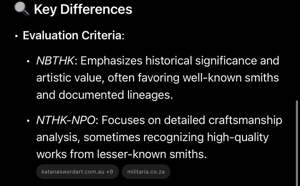

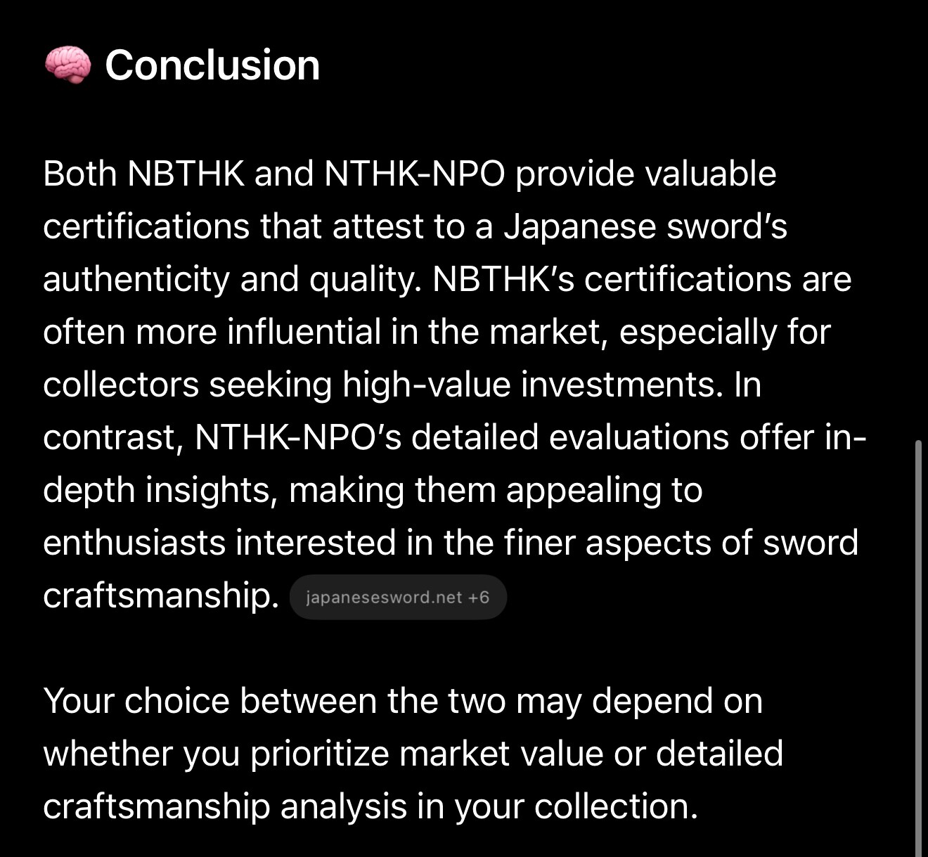

Bosco Posted June 24, 2025 Author Report Posted June 24, 2025 ChatGPT including our group as reference . I like that. Is this the proper answer I’m looking for ? Quote
Bugyotsuji Posted June 24, 2025 Report Posted June 24, 2025 ChatGPT being diplomatic I see. Did you see where it found the information? (This NMB site is quoted as reference.) Quote
Bosco Posted June 24, 2025 Author Report Posted June 24, 2025 18 minutes ago, Bugyotsuji said: ChatGPT being diplomatic I see. Did you see where it found the information? (This NMB site is quoted as reference.) I think it’s the one from 2020. Where everyone discussed about the old scoring system. 1 Quote

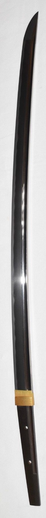

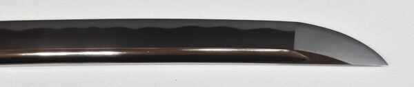

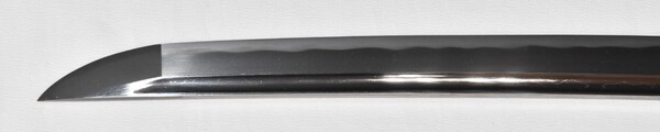

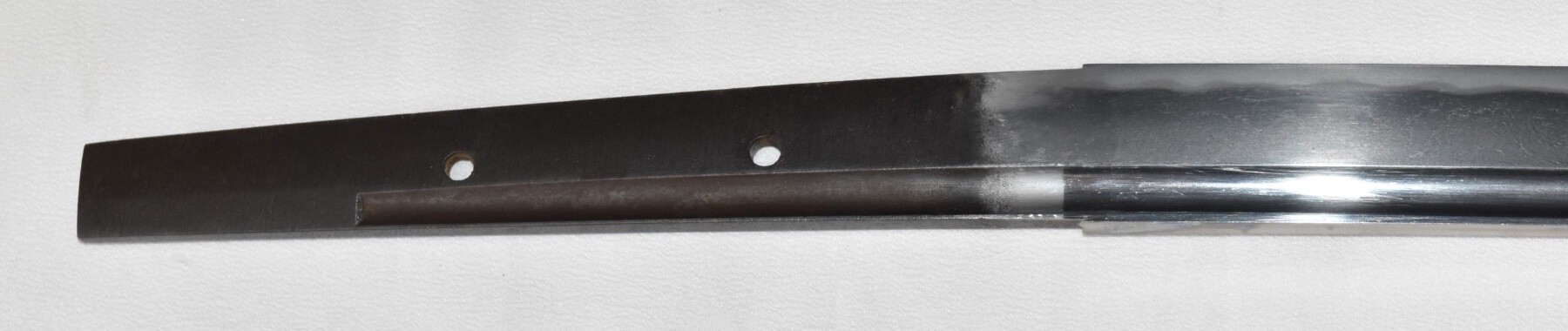

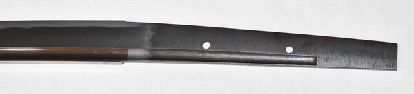

Rivkin Posted June 24, 2025 Report Posted June 24, 2025 Can't say anything without better pictures. It does look like very Yamato-ish Yamato Shizu, the key question is jigane any good. Quote
Bosco Posted June 25, 2025 Author Report Posted June 25, 2025 4 hours ago, Rivkin said: Can't say anything without better pictures. It does look like very Yamato-ish Yamato Shizu, the key question is jigane any good. This is the best they have Quote
