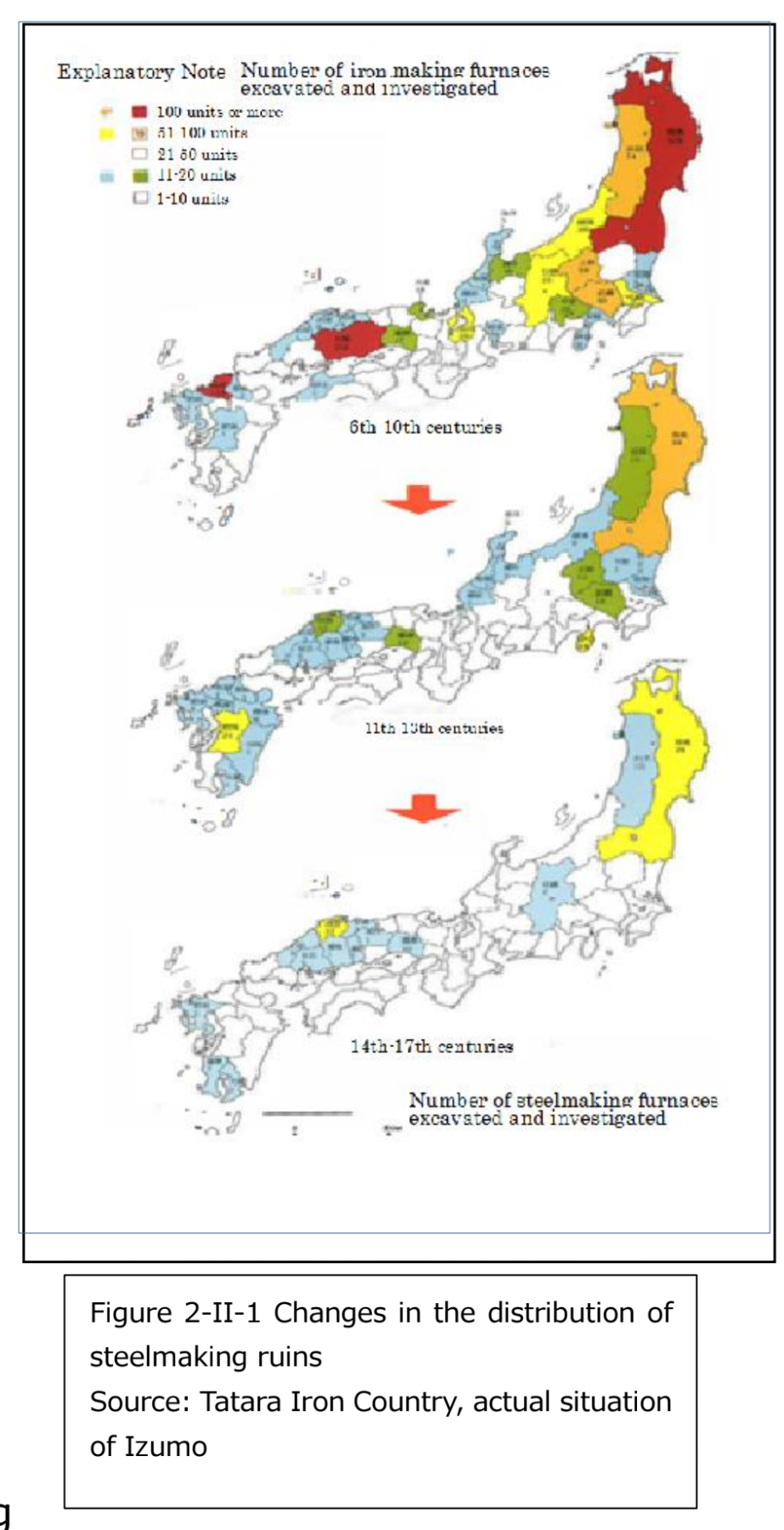

Gakusee Posted June 13, 2025 Report Posted June 13, 2025 22 minutes ago, Mikaveli said: I wondered this too - things like construction (kobuse, sanmai etc.) together with folding/hada style, selection of materials and carbon content and impurities retained in the process. Likewise, when people talk about steel production being centralised - how centralised? I'm assuming all production wouldn't have all come from a single source, and even if at one point, a smith managed the whole life cycle, there should be a progression towards more centralisation? Smiths, then schools, then cities, then regions, before national. Was there ever a period where steel cam from a single source in Japan? Gents - I think this is documented somewhere - come on, do some homework , where is the fun in discovery? I think it started in Muromachi in Shimane but eventually in the Tokugawa controlled Edo period it became even more centralised. …. and yes of course the more you purify and the more you hammer eventually the jihada becomes finer but the colour, inclusions and chatacteristics of the jigane still depend on the iron composition. Quote
Mikaveli Posted June 14, 2025 Author Report Posted June 14, 2025 5 hours ago, Gakusee said: Gents - I think this is documented somewhere - come on, do some homework , where is the fun in discovery? I think it started in Muromachi in Shimane but eventually in the Tokugawa controlled Edo period it became even more centralised. …. and yes of course the more you purify and the more you hammer eventually the jihada becomes finer but the colour, inclusions and chatacteristics of the jigane still depend on the iron composition. So, from what I've read, by the 18th / 19th century, the Chugoku region (a big chunk of western Japan) eventually peaked at around 80% of domestic steel production. But, that's at its peak. Regional decline in steelmaking started around the 11th century. And at least by the start of the Edo period, there were still several hundred furnaces spread across Japan (with more than 100 from the Chugoku region). Quote Starting around the 12th century due to the enlargement of the ironmaking furnaces and other technological innovation. The large-scale ironmaking furnaces changed from the previously-used mode of repeating operations and movements over a short period, to long-term operation in one place So, more centralised, yes - but there were still at least a dozen steel making prefectures spanning the entirety on Honshu. You'd imagine swordsmiths had some degree of choice in materials - as much of the steel was transported. In any case, the picture it paints, is a progressive reduction in steelmaking distribution, over the course of half a millennia - and whilst by the end of the Edo period, one region was dominating - this wasn't the case at the start - and there had been a similar progression towards centralisation starting centuries before that. 2 Quote
