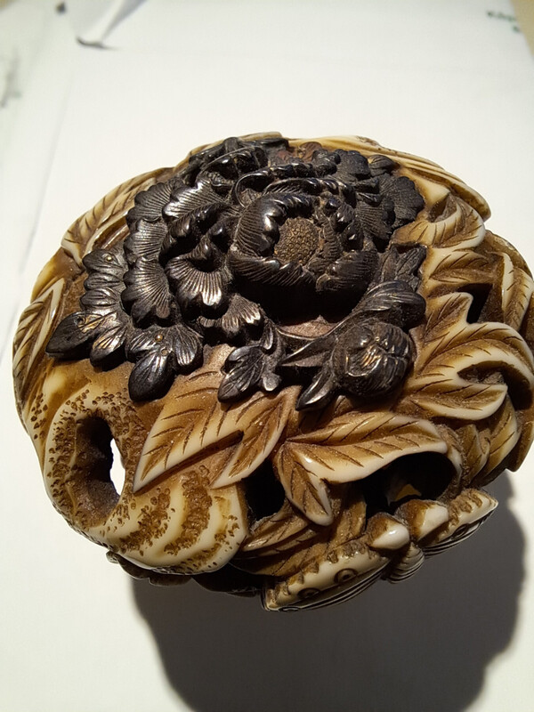

Dear Kagamibuta fans,
Have one and only. Bought for many years ago.
As You can see,made of Antler. Motive, flowers and butterfly.Botan of different metals on top.
Wishes
Andrew
  • Love 2

Andrew, I think yours is more of a ‘Manju’ glutinous rice sweetmeat type, at best a kagamibuta cross.
Most kagamibuta 鏡蓋 are tightly inset with a flat lid (the ‘mirror lid’ section) set into an uncarved, usually round frame. The string connects to a loop on the back of the lid and exits from a hole in the underneath of the frame body. Here is a well-worn example that I used to own.

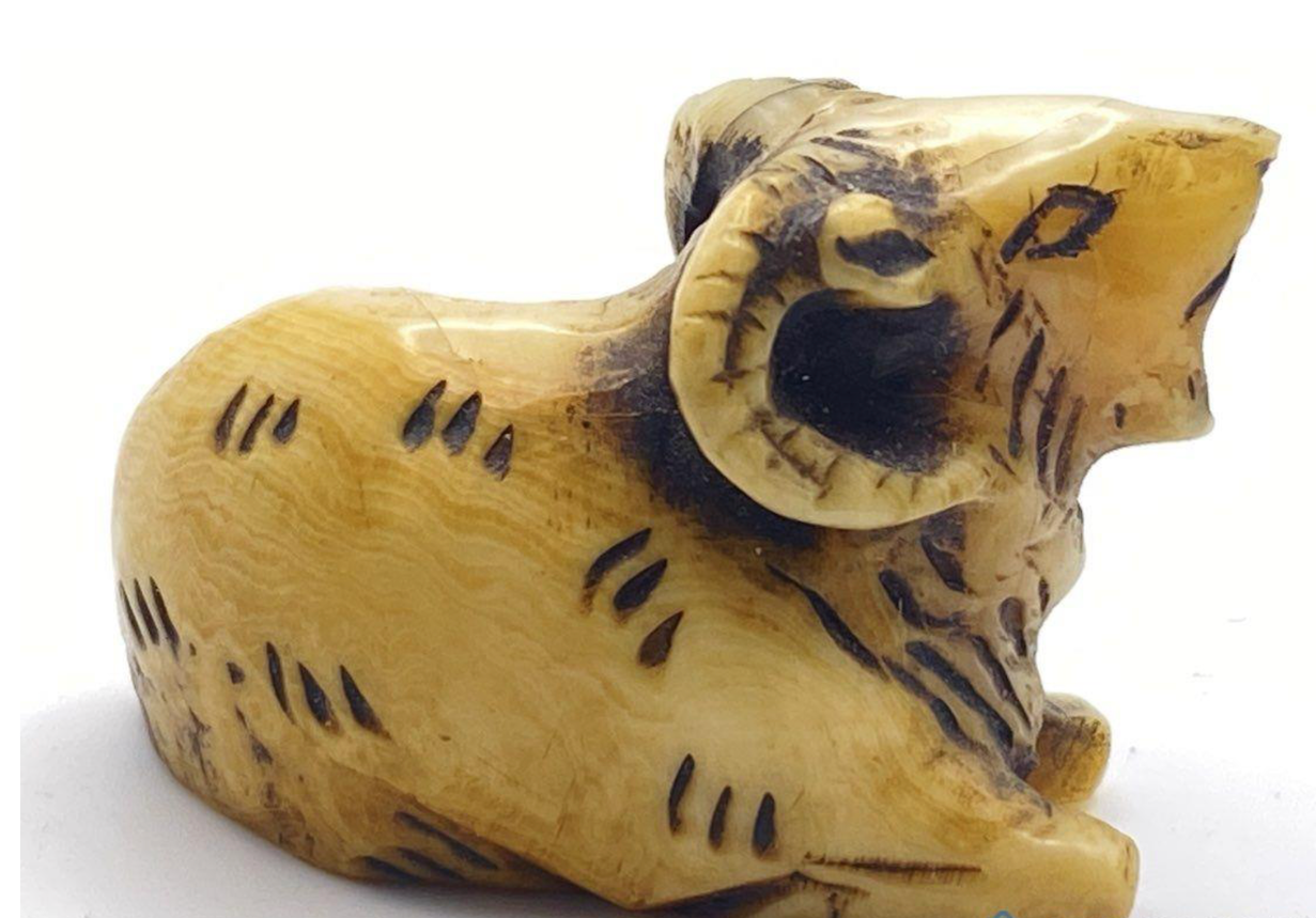

By the way, Andrew, I did not mean that one was better than the other, just that there are many types of Netsuke, and yours is more like a Manju than a Kagamibuta. Here I have three which would have been classed in the West as Manju, but I have discovered that in Japan they can be referred to as 'Senbei/Sembei Netsuke', as they more closely resemble flat 'osenbei' senbei crackers than a fat Manju.
You asked about size, Marcus. In the Ashmolean there are some amazingly large examples, especially Manju, but in general kagami-buta too will be about 4~5 cm wide, I would say, as a rule of thumb. But rules, as they say, are meant to be broken. See Eijer's lovely book above for some stunning examples.
Here are the three senbei examples. Two are ivory slices and one is narwhal. The narwhal (left) and one of the ivory slices bear a kamon on the central silver fitting. The third has a copper(?) 20-petal chrysanthemum kamon on either side, with a loop fitting underneath. The dark copper is finished in lovely wood-grain patterns that are said to be hard to replicate today.

I agree and understand  Mr Piers. No problem. I was too fast and entustiastic.. of cause my item is of cause a manju.Well, Japan and all there details... haha.
//Andrew

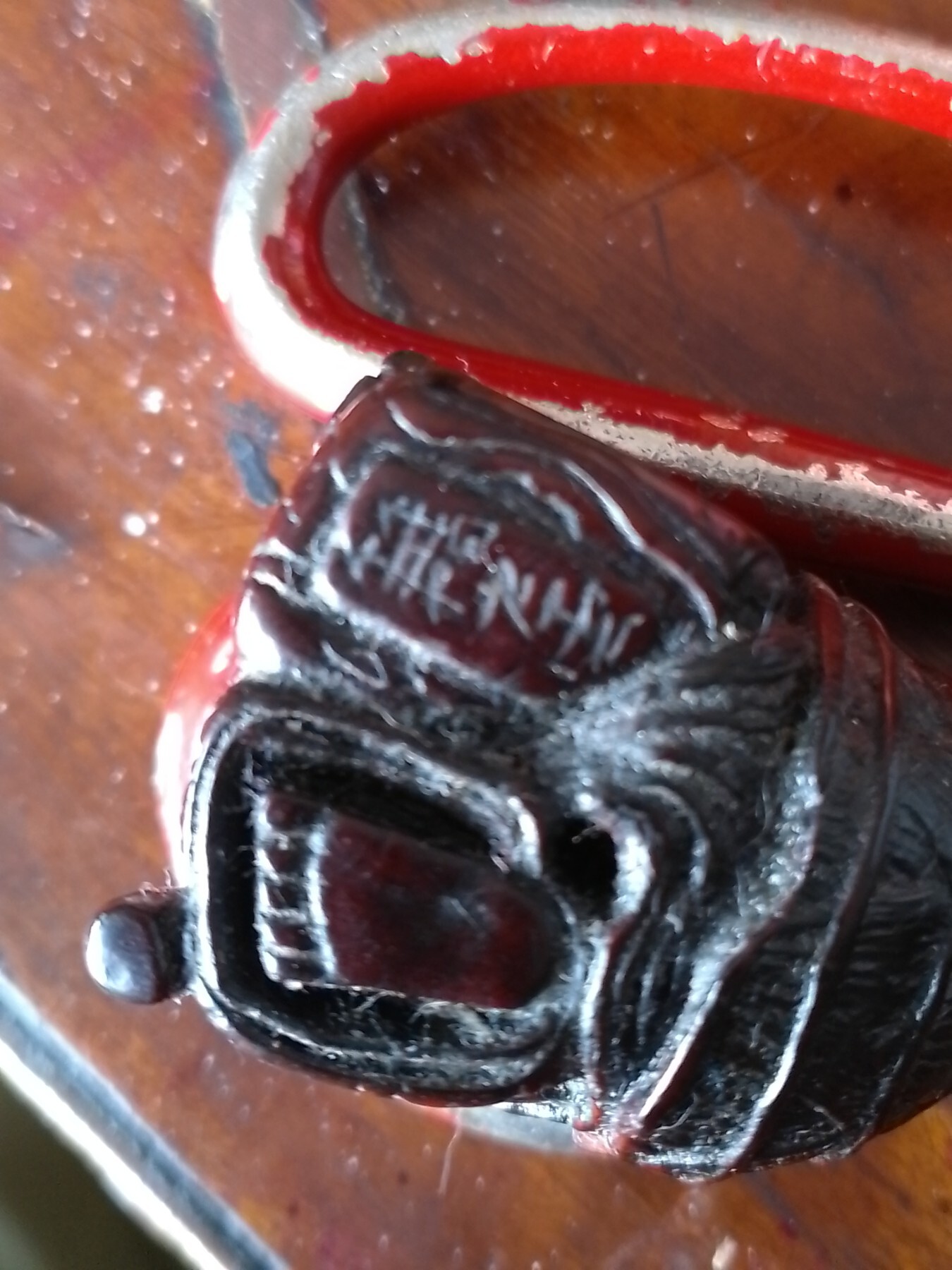

Graham,
The word "please" is a politeness often overlooked but it can do wonders when you're asking a favour from complete strangers. Perhaps a few words about yourself and what you have too?
First shot is upside down and fuzzy, but the second is a little better. Can you focus clearly on the signature once more? It seems to be carved into a resin material…(?)
Sometimes if signatures are not immediately obvious, we have to work with dictionaries to narrow down the possibilities. (Many are spurious, many are poorly written and barely legible, and many of course are not listed at all.)
So, an art name, beginning with 籍 (Seki) or 簑(or an older kanji version of Mino or Sai?) the last character of which looks as if it might be 雲 (un). Please do not expect an answer right away!

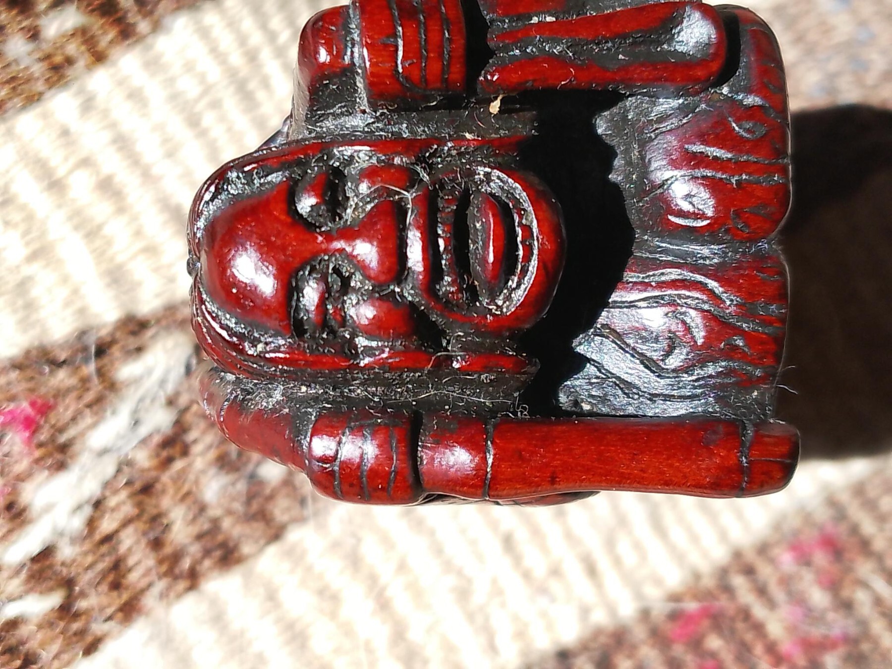

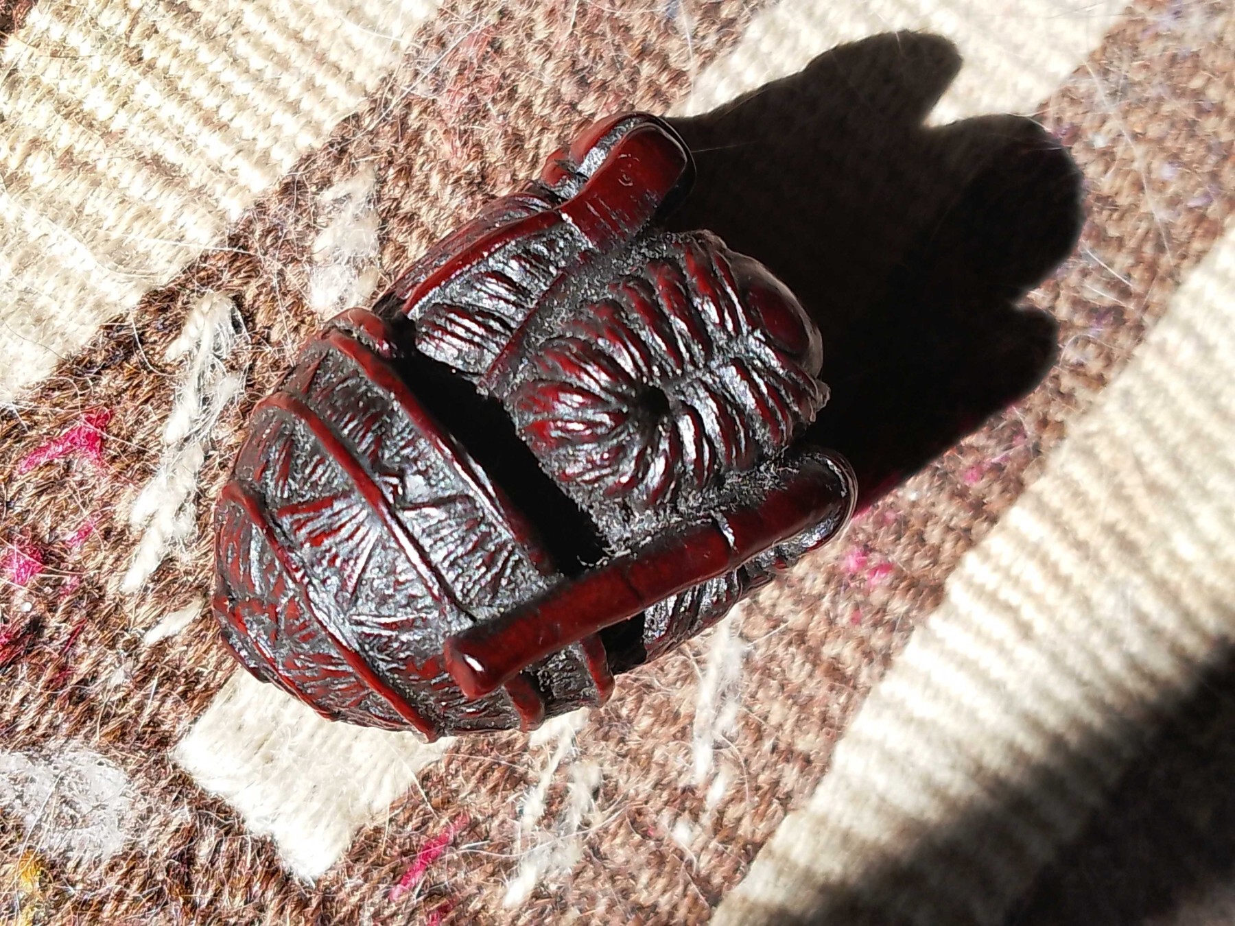

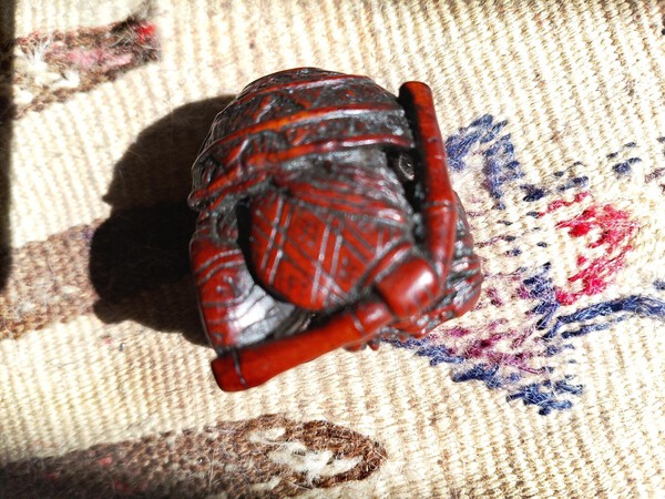

Hallo forum, I appreciate deeply Japanese art and culture. I have a very detailed Netsuke, carved from wood, which I bought, and have had for many years
It is very difficult to do justice with a photo, and the file only allows 2images.
But let me attempt.
Thanks for any assistance.
I think this is a traveller with a basket on his back
I am unable to add images to this post so will send images separately
I think it's a particularly compact Ono no Komachi (look at hat, stick, hair and definitely non-youthful appearance). Check this link for a model with several features in common:
https://www.zacke.at/auction/lot/lot-389---a-fine-nagoya-school-wood-netsuke-of-ono-no-komachi/?lot=47957
Piers' identification of the first character seems correct to me, but there are no recorded signatures that include 籍.
P.S. how big is it? And is there really a hole going from top to bottom, as suggested by some of the pictures?
