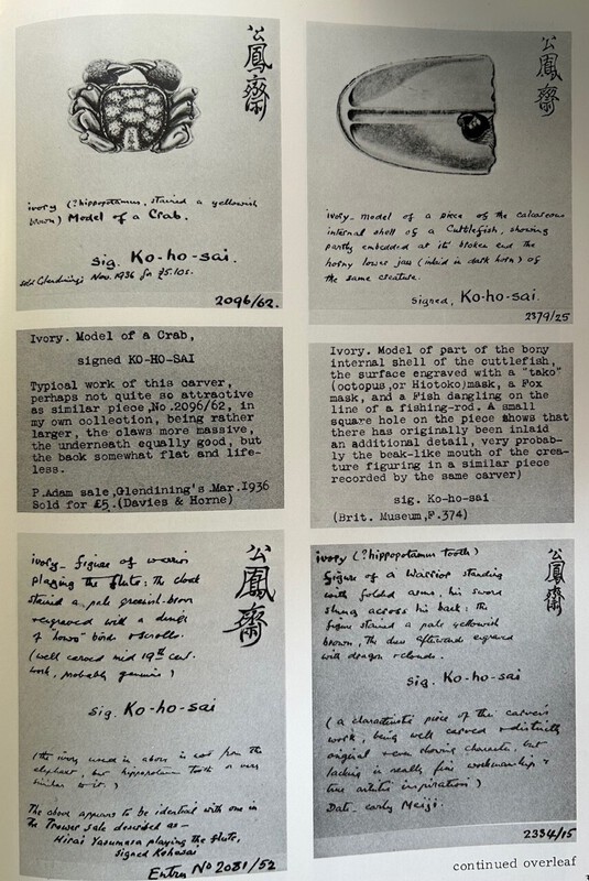

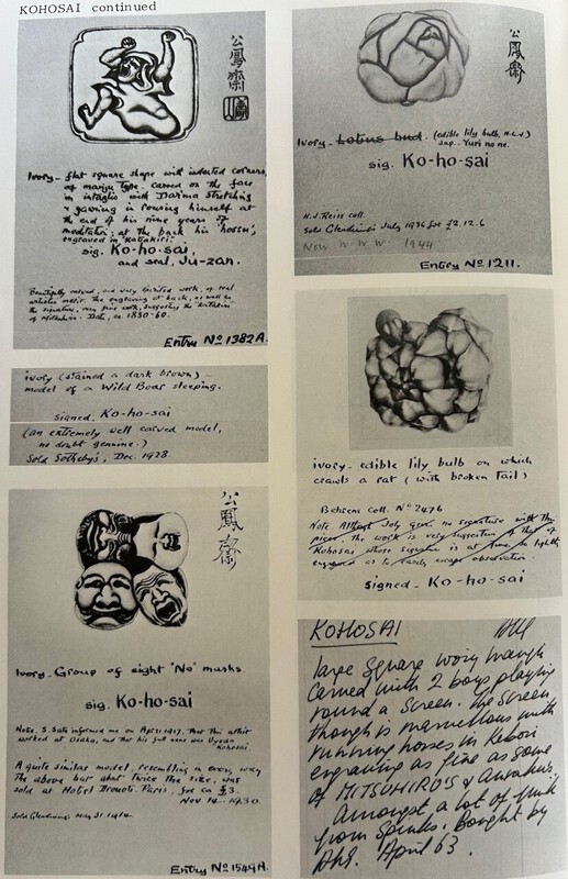

To be fair, this isn't entirely true. Many genuine netsuke (especially later ones from the 19th century) have cord holes of the same size. Also, signatures were uncommon on earlier netsuke, but became more and more common in later times, and while some of them were indeed artistically made, others were just cursive scribbles. Check out these reference books for examples of both kinds:
https://archive.org/search?query=lazarnick
