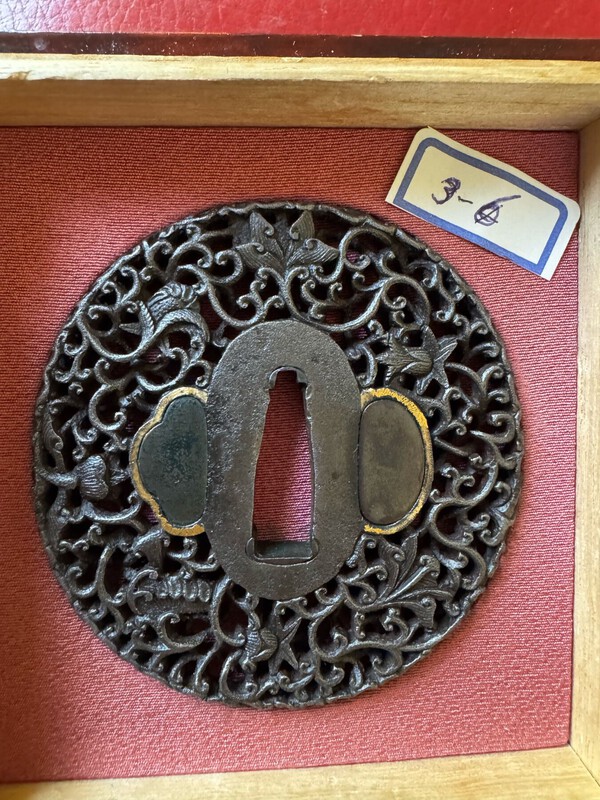

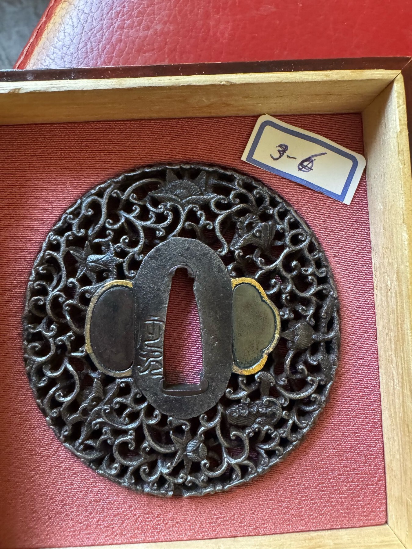

JAL Posted May 10, 2025 Report Posted May 10, 2025 Dear all, Not having a lot of a kodogu knowledge, this tsuba crossed my path when looking for a wakizashi sized tsuba for a simple mount. is this Shoami? Mimi are open work. Looks all iron. the signature and hakogaki on tge box do not give me a clue. any help would be appreciated. bedt regards John Quote
JAL Posted May 10, 2025 Author Report Posted May 10, 2025 Yes, I was informed off line as well that it is Namban iron. Quote
Spartancrest Posted May 11, 2025 Report Posted May 11, 2025 8 hours ago, JAL said: John My two cents worth = Hizen. The shape of the seppa-dai and the fact the hitsu were made as part of the design suggests to me it was made in Japan but with the Chinese/Namban influence. ie. Hizen style. Have a look at the Yagami school. I can't help with the mei. 2 Quote
JAL Posted May 11, 2025 Author Report Posted May 11, 2025 Moriyama-san got me the translation🙏 定治- Sadaharu 定治-Sadaharu 花唐草透 - Flower arabesque openwork best regards John L. 1 Quote
GRC Posted May 13, 2025 Report Posted May 13, 2025 That's a great example of a high quality nanban piece. Getting a signed one is quite rare. Congrats! You might find this article on signed Nanban tsuba interesting: Signed "nanban tsuba" | Mandarin Mansion 3 Quote
