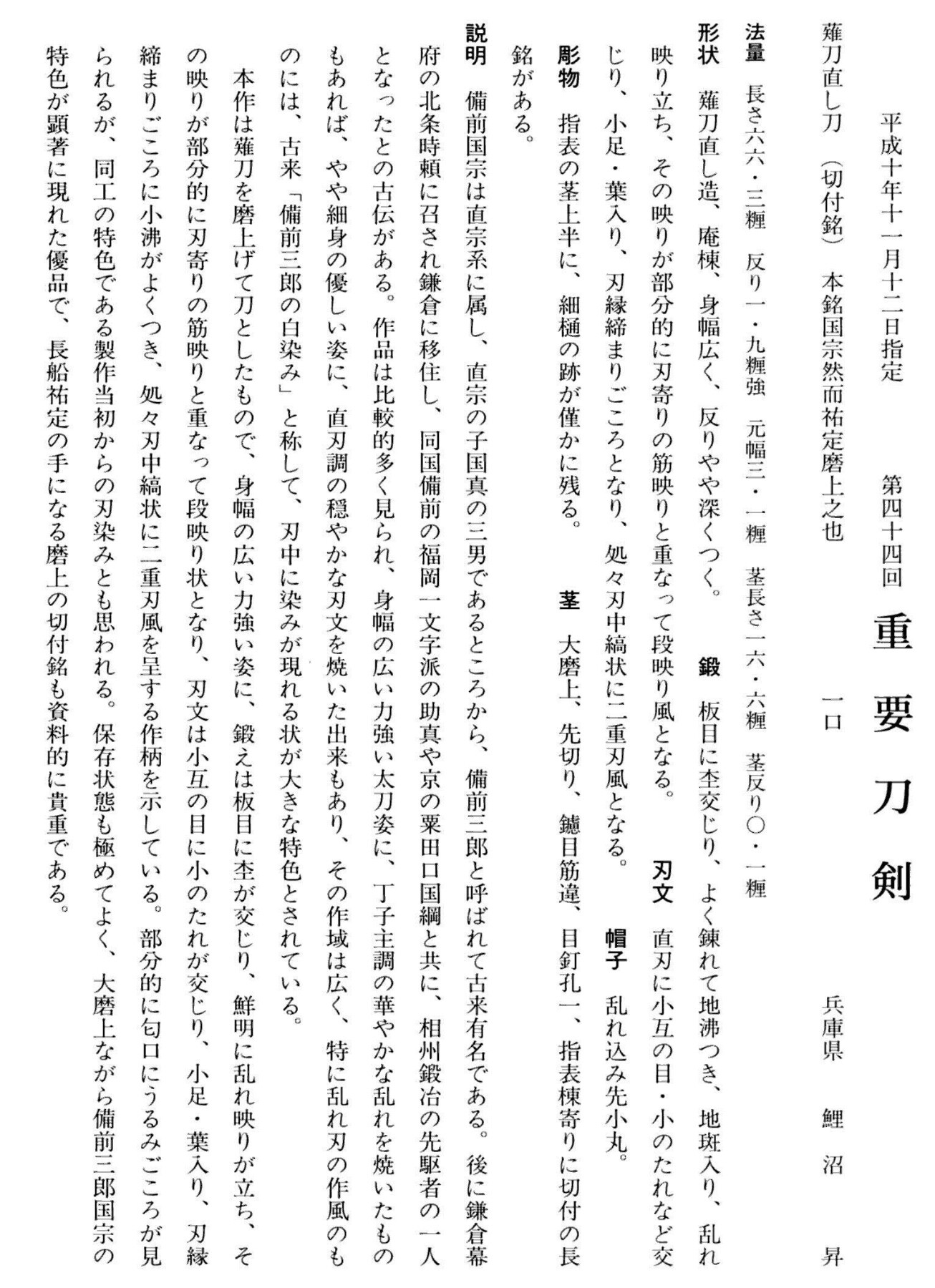

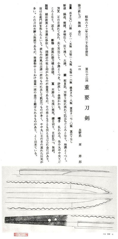

Tsuku Posted April 23, 2025 Report Posted April 23, 2025 Against my better judgement — I posted this example earlier. Perhaps it was overlooked or an appropriately in-depth study was not made. This blade was Jūyō-tōken in the 44th shinsa. The NBTHK paperwork clearly attributes it as a 薙刀直し刀 naginata-naoshi katana, right there on the front of the certificate. A copy of the setsumei is attached. I will draw your attention to a few points. 形状 薙刀直し造 keijō naginata-naoshi zō 帽子 乱れ込み先小丸 bōshi midare-komi-saki kō-maru [kaeri] 茎 大磨上 nakago ō-suriage 説明 ... 本作は薙刀を磨上げて刀としたもので... honsaku wa naginata o suriagete katana to shita mo node... "Here we have a naginata which was shortened and made into a katana..." Thus: NBTHK calls this a naginata-naoshi and and describes the form as such. An intact boshi with kaeri remains. NBTHK specifically says in the setsumei that it originated as a naginata that was shortened. 5 1 Quote
Mikaveli Posted April 23, 2025 Report Posted April 23, 2025 5 hours ago, Tsuku said: Thus: NBTHK calls this a naginata-naoshi and and describes the form as such. An intact boshi with kaeri remains. NBTHK specifically says in the setsumei that it originated as a naginata that was shortened. Where things go in circles is that whilst the NBTHK assert that it was a naginata, no proof is offered. We all can see / accept it's made in the style of a naginata, and (at least to me) I can see some evidence of suriage - although the position / depth of the mei is interesting. Edit: actually I see the description acknowledges kiritsuke now. But, to Jacques' point, could the NBTHK prove that it was ever mounted / used / made as an actual polearm (rather than just a non-shinogi-zukuri long sword)? A non ubu nakago actually makes it more ambiguous. Quote

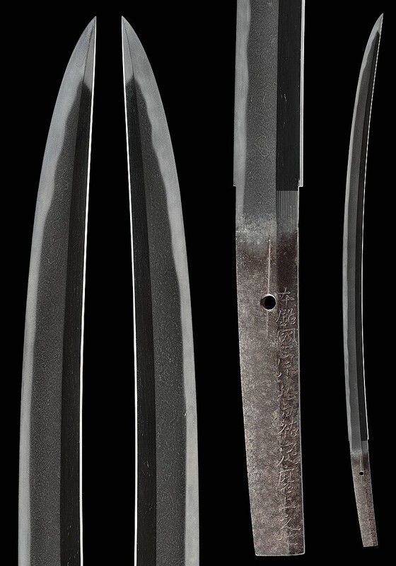

sabiji Posted April 23, 2025 Report Posted April 23, 2025 Well, here is another example : a Naginata Naoshi Katana, Nakago O-Suriage. The boshi is ko-maru with a short kaeri. The Sword is attributed to Kaneyuki, the son, but probably younger brother of Kinju. I studied Kinju intensively for some time. This way of working is typical for him and his environment. The yakiba is kept narrow, the character is retained in the kissaki, and the boshi forms the logical and harmonious conclusion. This way of working remains identical, whether tanto, ko-waki, tachi/katana or naginata. The boshi is usually a ko-maru with a very short kaeri up to the yakizume. This basically follows the style of its Yamato (Senjuin) roots, in which a short kaeri up to the yakizume is common. What I mean by this is that probably a whole series of naginata naoshi before the correction or change to katana/waki in the boshi region did not look significantly different, because the existing boshi corresponds to the style of the school/swordsmith. A yakizume at a school/swordsmith who otherwise does not harden something like this naturally indicates a clear modification in the sugata in the case of a naoshi. It could be difficult with Kinju, because yakizume can also be applied. And then we are back to the sugata and here we come full circle, which has already been mentioned here several times, that it was precisely because of this sugata that such naginata were particularly popularly modified into katana/waki, because the amount of work involved in the modification was correspondingly low and the original boshi remained largely intact. Conclusion: @ Jaques, no, I can't say how the Kaneyuki Naginata (Naoshi) shown by me looked 100% in its origin. But I know quite well the working style of the school around Kinju and would say that no significant modification of the sugata was made here. Nevertheless, the blade is called a naginata naoshi katana because the blade has been modified from a naginata to a katana. Well, a major point of contention here is obviously whether the example I showed was actually a naginata or nagamaki, or whether it was conceived from the beginning as a katana in this naginata-naoshi-tsukuri form. But I don't think so. The Nanbokucho period is not a revival period. Forms considered typical of this period were developed here, such as the often-mentioned enbun/joji sugata. A sugata that also emerged due to changing war tactics favoring infantry. The Nanbokucho is the heyday of the naginata. The typical castle towns, where swordsmiths worked for local princes and warlords, emerged much later. In Nanbokucho, many swordsmiths worked on the grounds of Buddhist temples. This was also the case at Kinju. Or at Kaneuji. A tegai smith who first switched to the mino-kokubunji, and there were also large temple complexes in Shizu and Naoe. Alongside the samurai, the monasteries represented the second most important military force, intervening in the fighting on behalf of one side or the other, or even just for themselves. It is also no secret that families of the court nobility supported monasteries or encouraged the establishment of monasteries on their lands, thus indirectly using their military power to achieve their goals. Morinaga, a son of Go Daigo, was the high priest of the Tendai-Shu on the Hiei and represented a significant military resource in his "reconstruction" against the Kamakura Bakufu. The naginata is also the standard weapon of the monastic military contingents. In any case, the naginata must have been produced in large numbers at that time. It's simply logical that naginata were later modified into katana/waki, firstly because they were particularly well suited for this purpose, secondly because there were still sufficient resources for such weapons, and thirdly because modifying them into katana and waki was obviously cheaper than producing them from scratch. The emergence of naginata naoshi zukuri, i.e. the deliberate copying of a shortened naginata, coincides, in my opinion, primarily with the copying of a specific forging style, such as the soshu style. Kaneuji, Naoe Shizu, Sue-Sa, Hasabe, and at the same time their typical sugata of the Nanbokucho were copied. This, in turn, is a Kantei characteristic of Keicho Shinto. This, of course, does not rule out the possibility that such utsushi existed much earlier. There are always exceptions, and nothing is set in stone. But the essence is always the obvious. 1 Quote

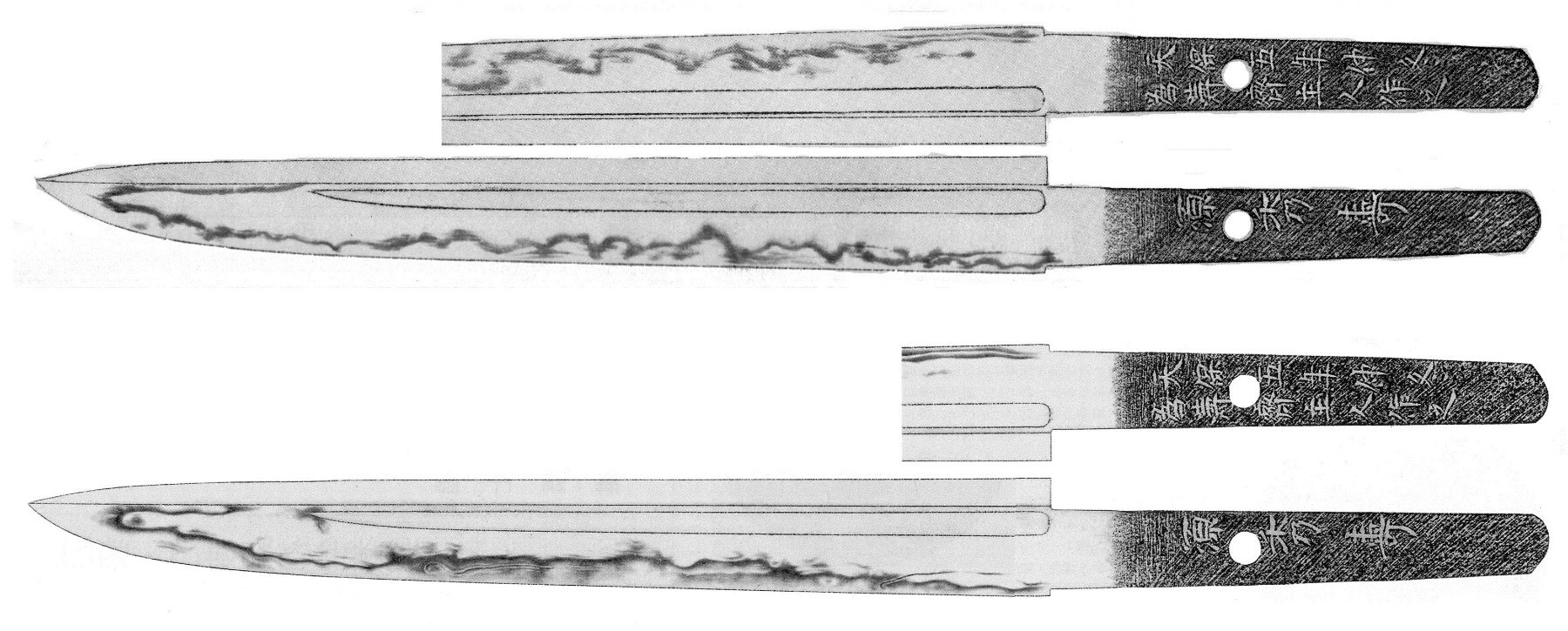

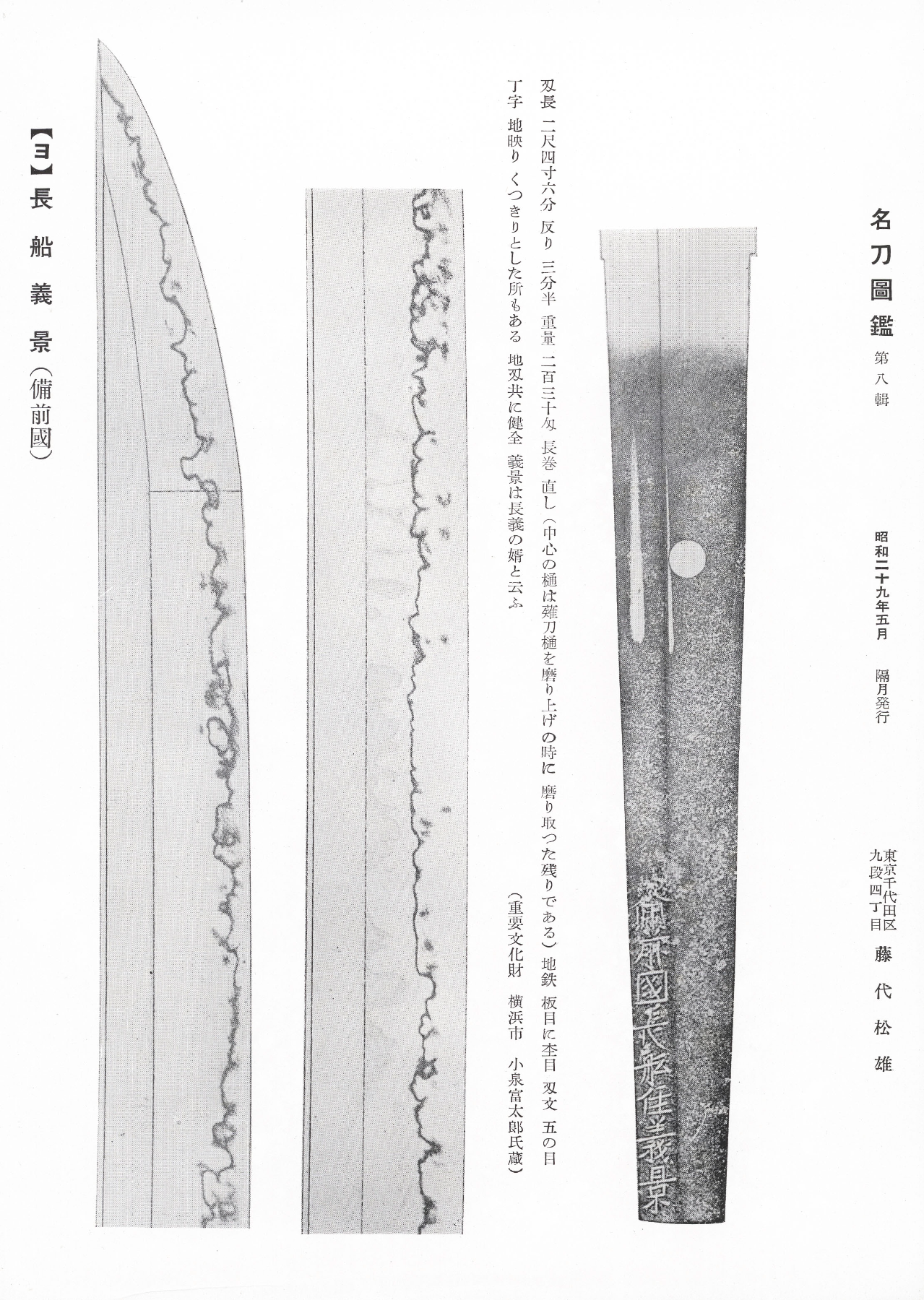

Scogg Posted April 23, 2025 Report Posted April 23, 2025 18 minutes ago, Mikaveli said: Jacques posted one example with a very distinct mune-machi and orikaeshi mei. It's my understanding that it's not a distinct mune-machi, but rather the oshigata showing what the style of mune is, by "unfolding" it on the illistration. See other example below: 1 Quote
Mikaveli Posted April 23, 2025 Report Posted April 23, 2025 15 hours ago, Jacques said: It doesn't look like that to me here, but it could be - I'm not sure, after you've said that? 22 minutes ago, Scogg said: It's my understanding that it's not a distinct mune-machi, but rather the oshigata showing what the style of mune is, by "unfolding" it on the illistration. See other example below: If so, it's a little misleading - as it has to either taper unnaturally towards the tip, or becomes asymmetrical? I've seen examples where the mune is unfolded, but then the drawing of the mune stops after a inch or so (resolving the above problem). Quote

Mikaveli Posted April 23, 2025 Report Posted April 23, 2025 On 4/17/2025 at 4:04 PM, CSM101 said: This picture shows what I was thinking - I don't think the oshigata depicts the flattened net of the mune? My thinking / assumption was this is a nakago reshaping, so that the wielder isn't left with a tsuka too wide for their hands? Quote

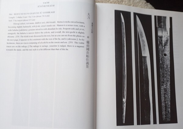

Jacques Posted April 23, 2025 Report Posted April 23, 2025 That's bother me, it's named as tachi and it has a typical naginata naoshi sugata. If Jussy could check ? 1 Quote

R_P Posted April 23, 2025 Report Posted April 23, 2025 Learned something there! Thank you @Franco. So it's akin to tachi, nagamaki is about the koshirae and less the suguta of the blade? So Jussi pinned it as Nagato which is the right terminology? Quote

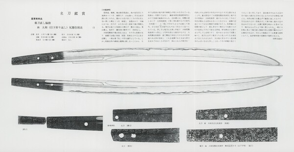

CSM101 Posted April 23, 2025 Report Posted April 23, 2025 Fujishiro classified the blade as naginata naoshi. 1 Quote
