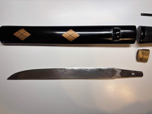

mbs Posted March 30, 2025 Report Posted March 30, 2025 Hello, I'm new here and this might be one of those newbie "did I mess up?" posts but here goes anyway. My area of interest is mainly European swords so I'm not too experienced in Japanese blades but I made a rather impulsive purchase of a tanto from a presumably reputable auction house, only to discover it has a few details that make me question its authenticity and/or value. It was described as late edo period and the listing somehow managed to hide the fact that it's pretty badly scratched on one side (which already made me lose a lot of trust in this auctioneer). The nakago also looks kind of short to my untrained eye and I'm not sure what to say about the Takeda mon on such a late piece. Can it be authentic but just mistreated by some previous owner or is it even worse? Thanks in advance for any advice or information. Quote
ChrisW Posted March 30, 2025 Report Posted March 30, 2025 Authentic but it has been messed with by someone who thought to 'improve' the sharpness or appearance of the blade by treating it like a western sword and grinding it. The nice habaki and decent mounts suggest it could be worth putting it in front of a professionally trained Japanese polisher (togishi). Do not let anyone who isn't trained as a togishi touch it for that purpose. 1 Quote
Grey Doffin Posted March 30, 2025 Report Posted March 30, 2025 This looks to be put together for a western (non Japanese) customer no earlier than late 19th century and possibly as late as after WWII for occupation forces to have a trinket to take home. The nakago is wrong for real Nihonto. Nothing to bother a polisher over. In my often humbled opinion. Grey Quote
ROKUJURO Posted March 30, 2025 Report Posted March 30, 2025 M, please sign all posts with a first name plus an initial so we could address you politely. It is a rule here on NMB. Your own assessment is quite on the spot. While the blade looks authentic, It is probably a very late blade, maybe later than MEIJI JIDAI, and it is in bad condition. In addition to that, it has a very simple KOSHIRAE in my opinion. But all comes down to the price you paid. If it was really cheap, you could possibly recoup your money in a resale. Quote
mbs Posted March 30, 2025 Author Report Posted March 30, 2025 Thanks everyone for the answers. I've added a name, didn't realize it was a rule. The tanto wasn't cheap enough to warrant the headache of trying to resell it myself, I will try to return it to the auction house since their code of ethics says it should be possible in case of misrepresentation. But I do expect some pushback from their part. 1 Quote
