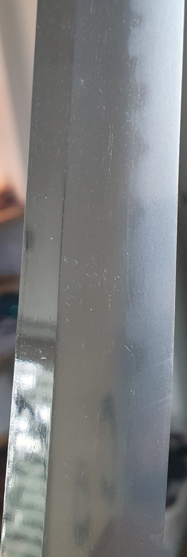

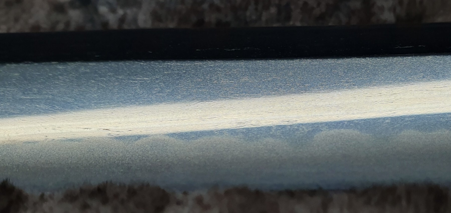

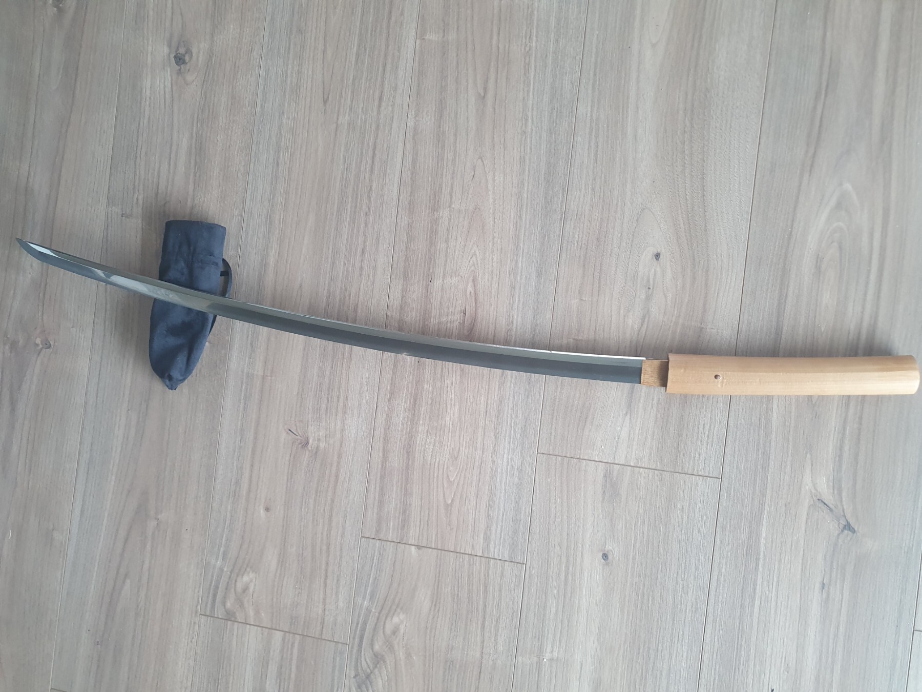

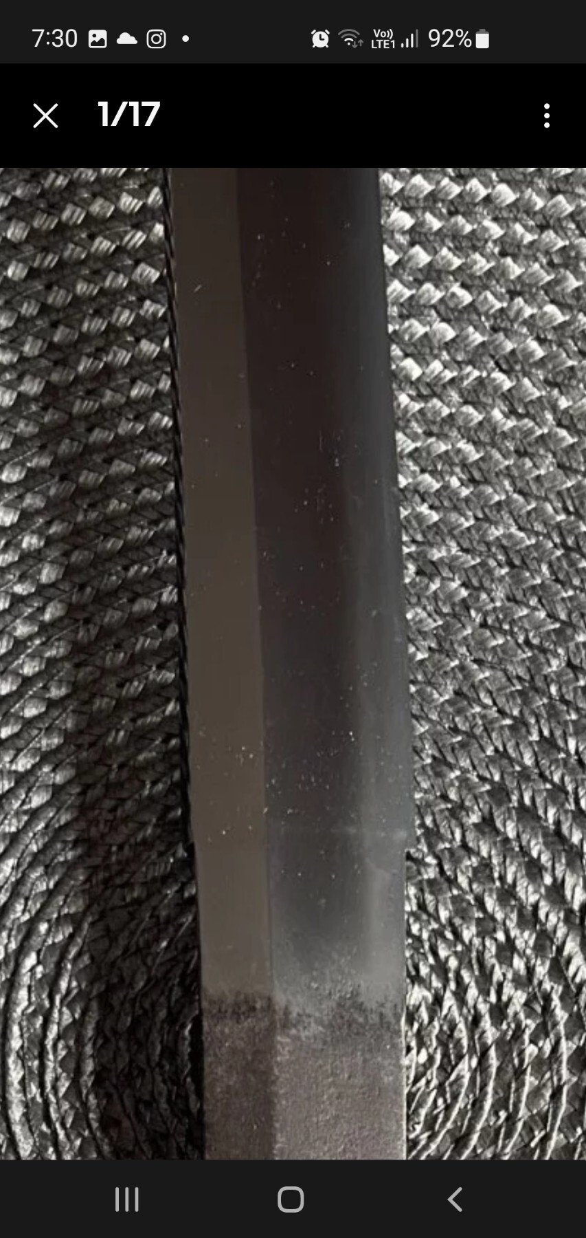

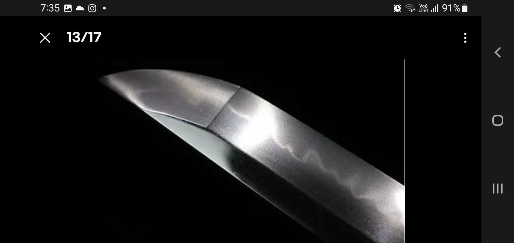

hudomeld Posted March 23, 2025 Report Posted March 23, 2025 Hello all, Recently i purchased a tachi.. It is signed but i think it is irrelevant at first.. later on i will reveal it of course.. Nagasa 75cm Ubu nakago Blade 29mm and 19mm at kissaki Thickness 7 and 5mm At this point i really would appreciate your experienced oppinion about the age from the sugata, jihada and jigane as well as hamon.. Many thanks in advance David Quote
Ray Singer Posted March 23, 2025 Report Posted March 23, 2025 I would have thought this is an ubu shinshinto blade. 4 1 Quote
oli Posted March 23, 2025 Report Posted March 23, 2025 hi, why do you think it's from kamakura period? For me it looks like shinto or shinshinto. Is there a signature on the nakago? regards Oli Quote

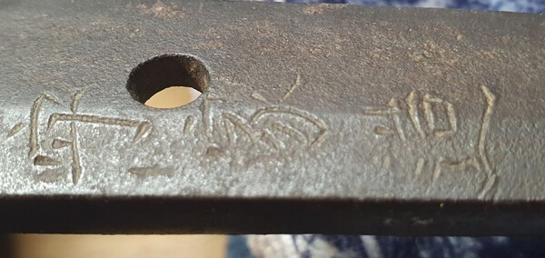

Bugyotsuji Posted March 23, 2025 Report Posted March 23, 2025 Oli, he said it is signed but he is not going to show us yet. You can see 造, but above that he has blanked it off. 1 Quote

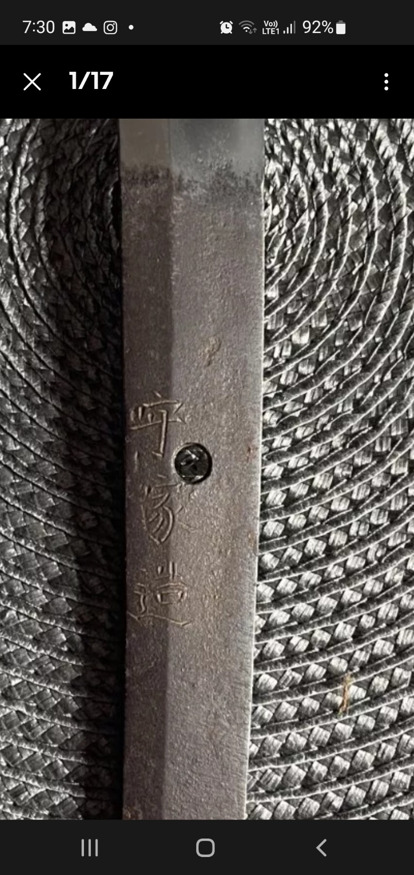

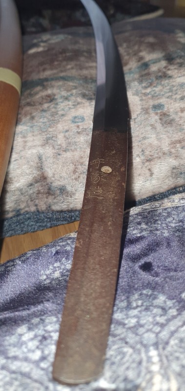

hudomeld Posted March 23, 2025 Author Report Posted March 23, 2025 Sorry for hiding the mei.. I really did not want to have the blade judged by the mei.. Myself i think it is no way the Moriie mei could be authentic.. I also did not buy it because of the mei.. 1 Quote

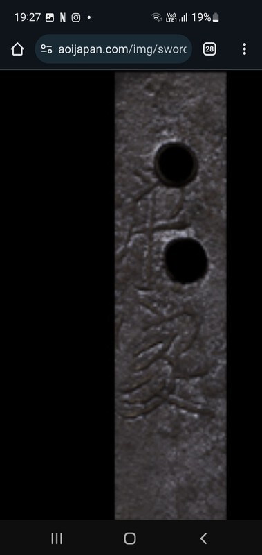

oli Posted March 23, 2025 Report Posted March 23, 2025 hmm like a small kantai? The nagasa and sugata trends into direction shinshinto. Ubu Kamakura blades have a different sugata and are hard to find or get. Example: https://www.aoijapan.net/tachi-moriie-hatakeda/ Quote
hudomeld Posted March 23, 2025 Author Report Posted March 23, 2025 I really dont know where to position it.. For my -completely untrained- eyes the nakago looks older than shinshinto forgot to mention the sori is 2,6cm Quote
Jacques Posted March 23, 2025 Report Posted March 23, 2025 A bad gimei of Moriie who was a great Kamakura Bizen Smith (Saijo) Quote
oli Posted March 23, 2025 Report Posted March 23, 2025 the pictures aren't the best. Yes maybe late muromachi or early shinto. But for kamakura its looks too good. 1 Quote
hudomeld Posted March 23, 2025 Author Report Posted March 23, 2025 Thats what i thought too.. for kamakura.. it is in a too good shape Quote

hudomeld Posted March 23, 2025 Author Report Posted March 23, 2025 Not as i would want to proof that the mei is authentic.. but it is not looking very freshly made.. Or am i completely wrong.. Quote
Brian Posted March 23, 2025 Report Posted March 23, 2025 Yeah, but remember that they have been doing gimei for hundreds of years,. Quote
hudomeld Posted March 23, 2025 Author Report Posted March 23, 2025 Of course i have that in mind.. I am currently wondering if a sec. Or third gen. Moriie in the post hatakeda times could possibly have forged the blade and in this case the mei could be so called authentic.. Sure.. not for hatakeda.. You probably saw some mei in your life.. from the nakagos overall appearance.. does the mei match the period when the blade was forged or do you see it as beeing signed later..? Quote

oli Posted March 23, 2025 Report Posted March 23, 2025 here is an interesting article about gimei https://markussesko.com/2019/12/31/kajihei-鍛冶平/ Quote

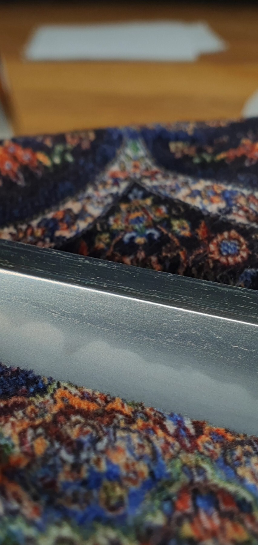

Rivkin Posted March 23, 2025 Report Posted March 23, 2025 shinshinto, not the first tier smith influenced by period's Bizen school - Yokoyama and Chounsai. Poor quality jigane (100% dense). 1 Quote
Lewis B Posted March 23, 2025 Report Posted March 23, 2025 Genuine Kamakura era Mei (1st generation), although there were later generations also signing Moriie well into the Nanbokucho period. 1 Quote
hudomeld Posted March 23, 2025 Author Report Posted March 23, 2025 Ray, Oli and Lewis.. thanks for the reference mei Although for me they look completely different Quote

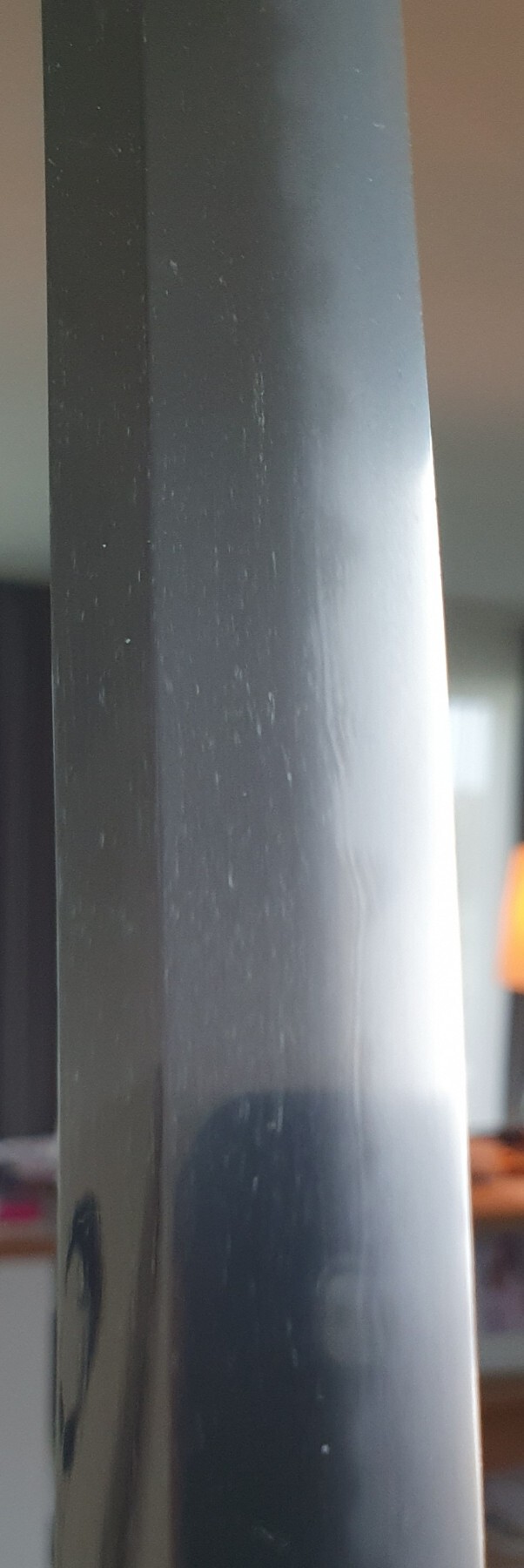

hudomeld Posted March 23, 2025 Author Report Posted March 23, 2025 Rivkin, not so dense at all, Just forgive me for my bad photogarphic skills with my old phone.. other than that it looks like the polish is not a perfect job, it hides a lot of the jigane structure.. at least on the photos.. i have to admit that Quote

hudomeld Posted March 23, 2025 Author Report Posted March 23, 2025 According the difference in gimei and gendai gimei signatures.. Please tell me that mine is not a gendai.. that is probably the only thing i really hope for Quote

Franco Posted March 23, 2025 Report Posted March 23, 2025 One more opinion, Shape suggests a Muromachi period sword. The question then becomes; is it truly a Muromachi period sword or an elaborate Shinshinto copy? 7 hours ago, hudomeld said: Nagasa 75cm Ubu nakago Blade 29mm and 19mm at kissaki Thickness 7 and 5mm What is the kasane at the widest point of the nakago vs at the mune-machi? What does the ko-shinogi look like from above? To my eye the ji-tetsu looks more Shinshinto as does the nakago patina vs Koto. "Too good for Kamakura." Hmm. Quote
hudomeld Posted March 23, 2025 Author Report Posted March 23, 2025 So. The nakago widest kasane is 7.2mm The mune kassane 6.9 or 7mm Some photos attached.. Quote
Rivkin Posted March 24, 2025 Report Posted March 24, 2025 5 hours ago, hudomeld said: Rivkin, not so dense at all, Just forgive me for my bad photogarphic skills with my old phone.. other than that it looks like the polish is not a perfect job, it hides a lot of the jigane structure.. at least on the photos.. i have to admit that Different light direction can really affect hada appearance, but still I see the hada which is coarse with visible lamination in places, but otherwise has this dense, grey look... No color changes, utsuri, no ji nie, just greying itame. Nakago can be late koto, sugata can be late koto, but this very distinctive periodic choji gunome, each having exactly the same very solid and single tone, but relatively bright appearance - does not look like koto. Its a shinshinto style and something that quite a few practiced at the time. Same about hada, I don't see the variety one expects from koto, to me its more modern. Quote
Franco Posted March 24, 2025 Report Posted March 24, 2025 6 hours ago, hudomeld said: The nakago widest kasane is 7.2mm The mune kassane 6.9 or 7mm Not polished down much. Certainly not what might be expected of an earlier Koto period sword. At this point my thought is a Shinshinto copy. Thank you for the additional information and images. Quote
hudomeld Posted March 24, 2025 Author Report Posted March 24, 2025 The blade has/had sashikomi polish.. but it looks like someone went on it again with some untraditional way aiming for the seen mirror like finish.. after that brought back the ha and hamon with kesho polishing... We will start now with the refreshing of the sashikomi polish.. and probably a mei investigation in the shinto, shinshinto era. Will see.. Many thanks for all your kind answers. Will keep you posted if anything nice or intresting comes up.. Regards David Quote

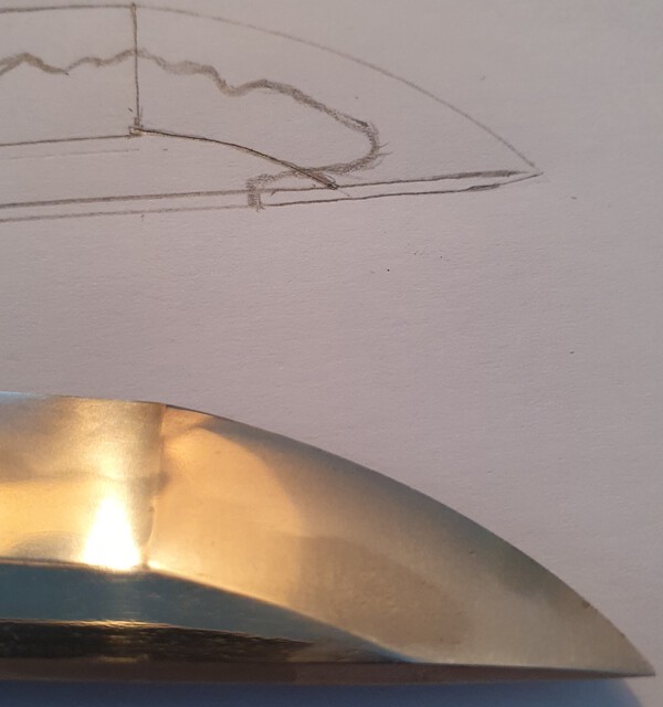

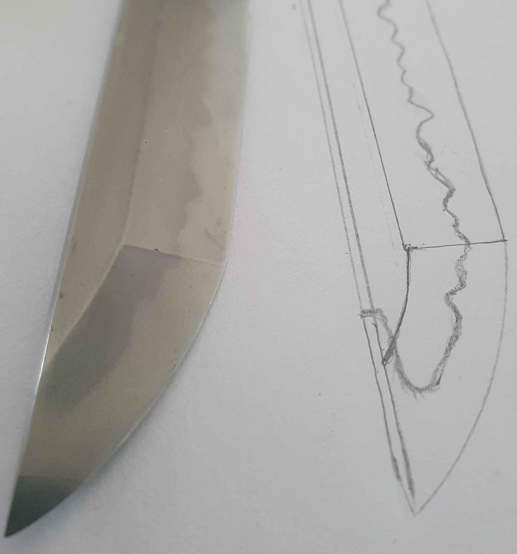

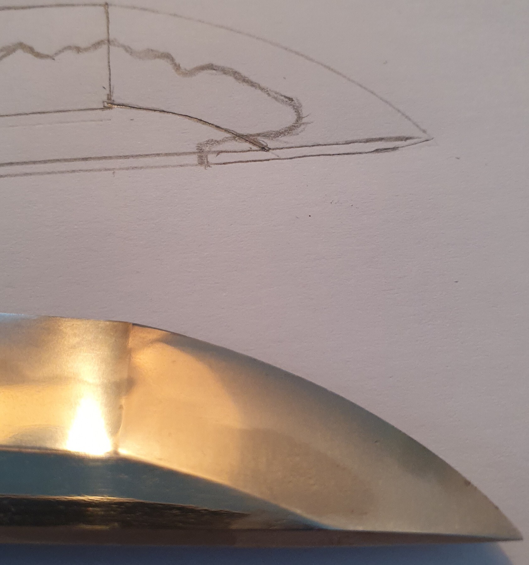

hudomeld Posted April 15, 2025 Author Report Posted April 15, 2025 Hey all, I made some inspection on the blade and especially on the boshi.. as from photos it is not very well presentable i made a scetch 1:1 from the boshi and the nakago.. Any thoughts again will be appreciated.. David Quote
