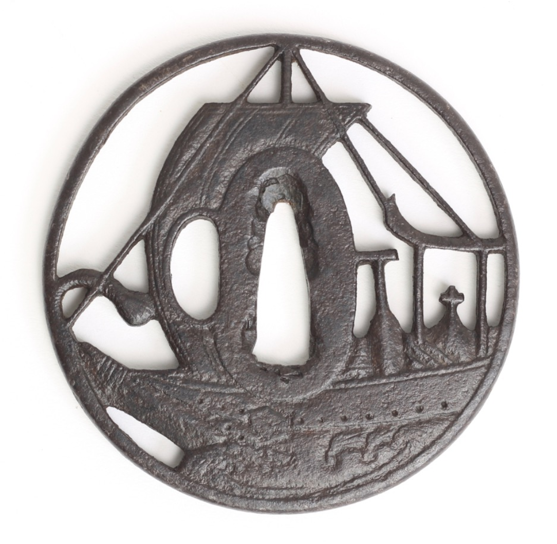

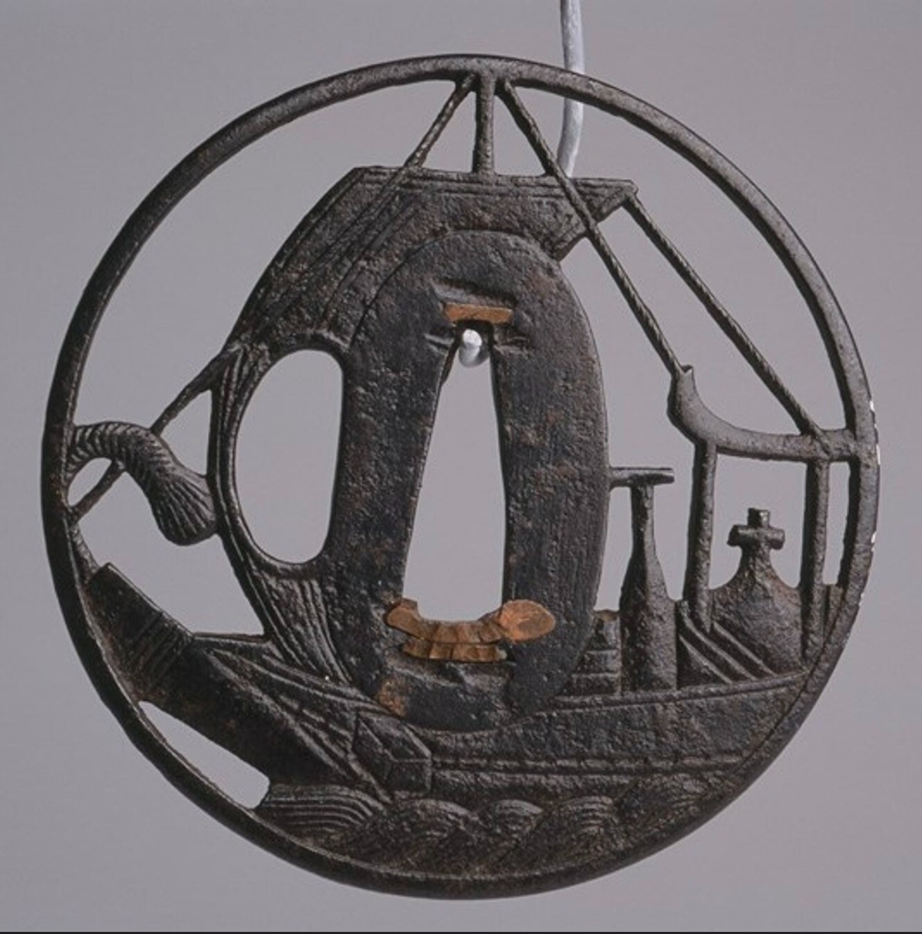

This tsuba has just come on auction. It is familiar to many of us as being attributed to Ono with the motif of a sailing ship. This specific composition with the crucifix on the stern may be a reference to There are numerous such examples with similar attributions (e.g. Walter Compton Collection, Nakamura's Tsuba Shusei, various sellers and auctioneers) that are referring to the Kozeho motif seen in Ono and Yagyu work. However, I am skeptical and am hoping others will weigh in. It is suggested that this is a sailing ship transporting goods (Portuguese?) in the Ise Bay, Southeast of Nogoya. If it is actually a later work of the Edo period, what school can this whole genre be attributed to then?

Mandarin Mansion (sold)
https://www.mandarinmansion.com/item/ono-school-ship-tsuba
Musees D'Angers (attributed "Owari" workshop)
https://ow-mba.angers.fr/fr/notice/mtc-9025-garde-de-sabre-decore-d-un-navire-ce30b96a-7a07-43b8-b0c2-f8bbe1113315
