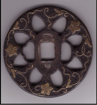

ROKUJURO Posted March 1, 2025 Report Posted March 1, 2025 Paris, about like this one below, but otherwise not much different from other "normal" TSUBA. I found that they are often very simple with little or no decoration. The NAKAGO-ANA can be quite large with some. 2 1 2 Quote
DKR Posted March 2, 2025 Report Posted March 2, 2025 Dear Jaqcues, now I'm very disappointed in you. It is very clear to see that this tsuba was originally a normal tsuba. So for a katana or waki. So this is not a tsuba for a yari! At best an example of a converted tsuba.........and nothing else.......... and then even worse......you, especially you, call you tube a serious Source for information ? 2 Quote

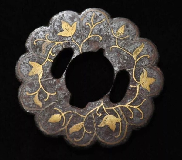

Kantaro Posted March 2, 2025 Report Posted March 2, 2025 10 hours ago, Jacques said: there are also tsuba for yari Nice one Jacques. It reminds me of this strange one I have seen. What do you think of it? Quote
Yumso Posted March 2, 2025 Report Posted March 2, 2025 That shape seems like it was originally used as a katana(or wakizashi... or tanto...) but somehow later been used as a shinai tsuba? Though I've never seen an iron shinai tsuba... 1 Quote
ROKUJURO Posted March 2, 2025 Report Posted March 2, 2025 Sometimes we see these modified TSUBA for BOKKEN/SHINAI, walking-sticks, YARI or (more likely) Western rapiers. Nothing wrong with that, it is the obviously last use they had. Or even keyhole covers! 2 Quote

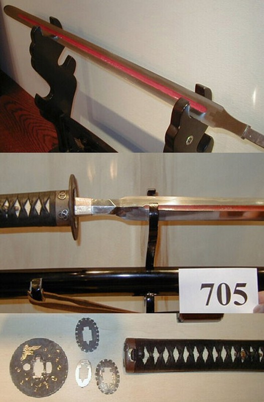

Jacques Posted March 2, 2025 Report Posted March 2, 2025 2 hours ago, DKR said: Dear Jaqcues, now I'm very disappointed in you. It is very clear to see that this tsuba was originally a normal tsuba. So for a katana or waki. So this is not a tsuba for a yari! At best an example of a converted tsuba.........and nothing else.......... and then even worse......you, especially you, call you tube a serious Source for information ? I know, but this tsuba has been modified to be mounted on a yari, so it's now a yari tsuba... 2 1 Quote
DKR Posted March 2, 2025 Report Posted March 2, 2025 I'm sorry, but there is no Yari Tsuba. That's nonsense. What could be, however, is that it is a modified Tsuba which has been mounted on one of these oddities Koshirae. Example in the picture including your " Tsuba for a Yari" These fantasy mounts are mostly relatively new .....perhaps tourist souvenirs 1 Quote

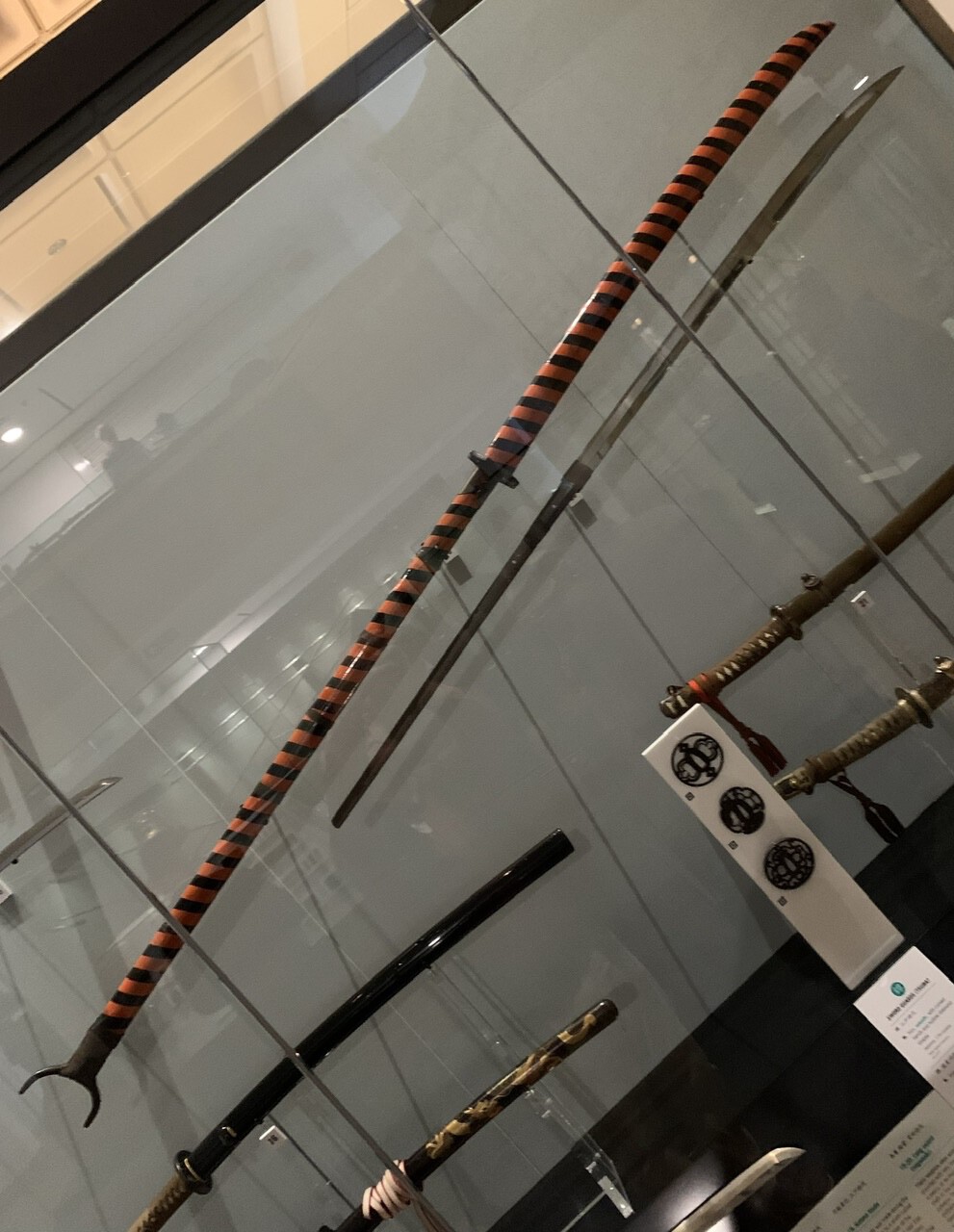

Bugyotsuji Posted March 4, 2025 Report Posted March 4, 2025 While on the topic there’s a lovely nagamaki with tsuba in the Leeds Royal Armouries. (The place is well worth a visit, for a thousand reasons!) There is also a naginata with what looks like a very compact ‘tantō’ style tsuba in place. 1 Quote
