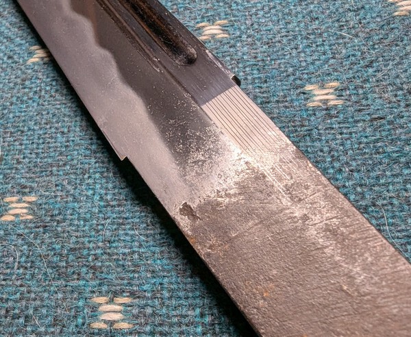

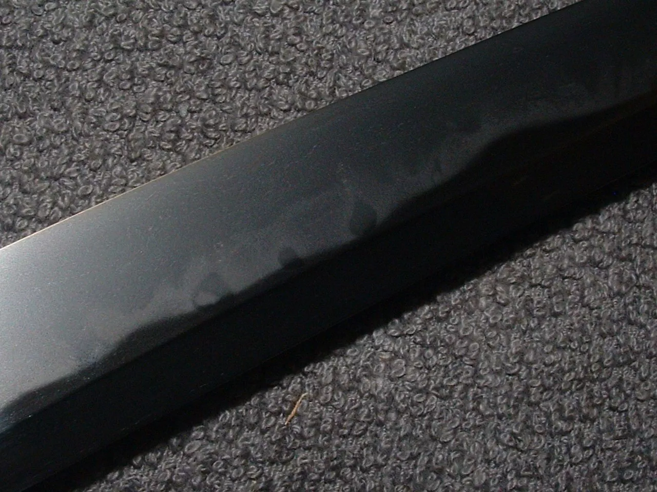

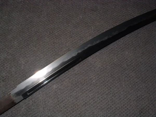

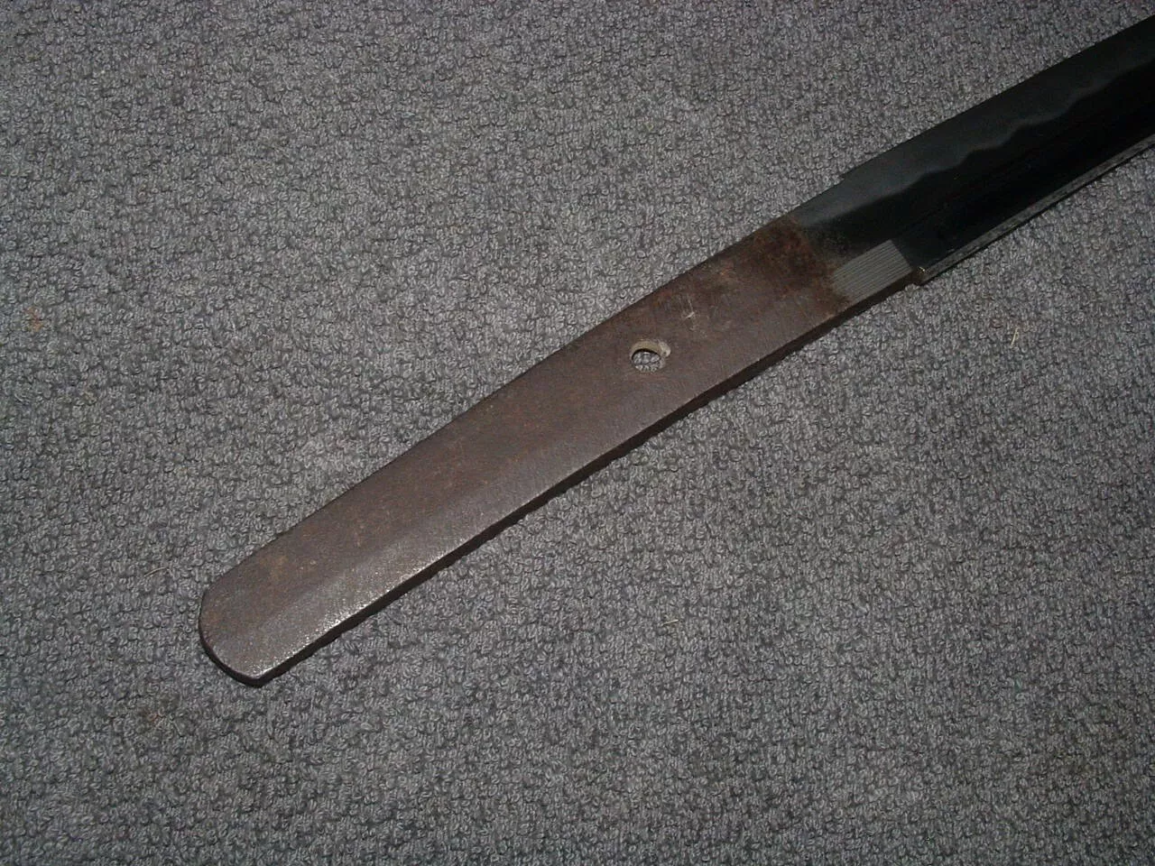

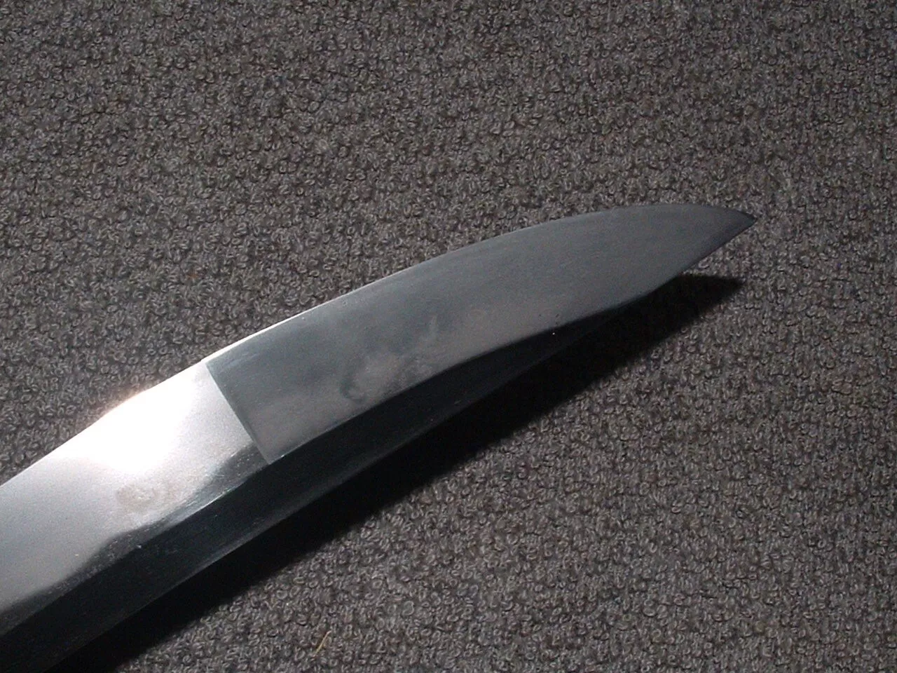

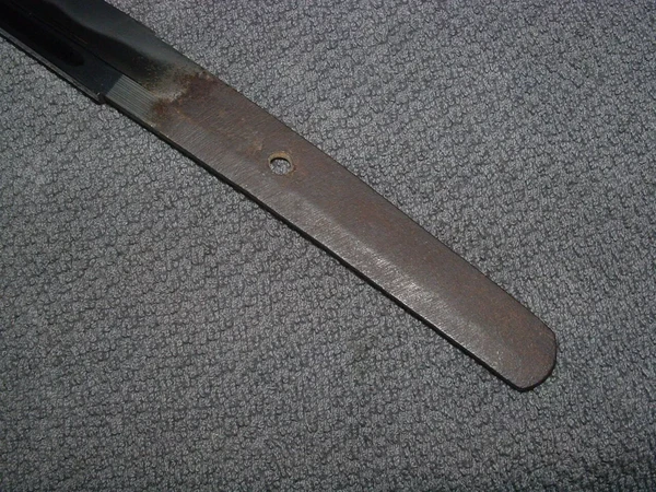

Jussi Ekholm Posted February 15, 2025 Report Posted February 15, 2025 Can you post pictures of the mune at nakago transition, at the termination of the hi closer to tip, and at the kissaki. Also if possible motohaba and sakihaba measurements. Expertise of NBTHK is far superior to my opinion. Quote
Basho Posted February 16, 2025 Author Report Posted February 16, 2025 Hi Jussi. I've added some photos, as well as the motohaba and sakihaba measurements. (My amateurish eye agrees with Franco, that machi-okuri seems likely, just based on how it looks.) Quote
Basho Posted February 16, 2025 Author Report Posted February 16, 2025 These are large files, so I am posting multiple times. Quote
