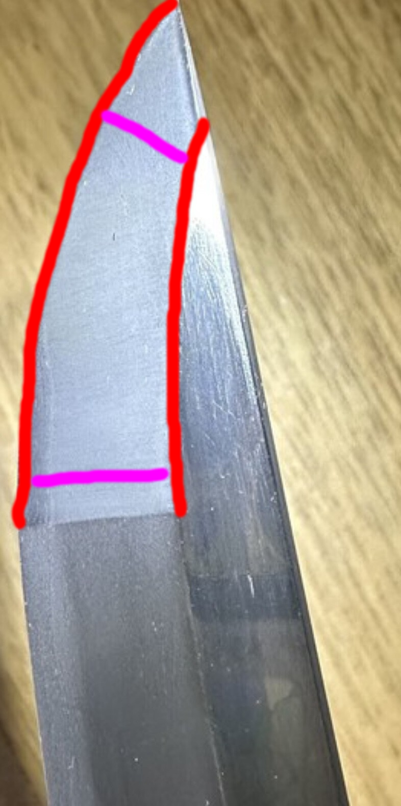

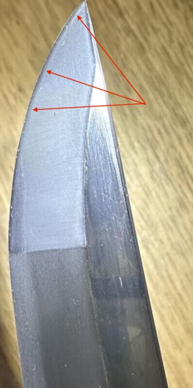

Lexvdjagt Posted February 8, 2025 Report Posted February 8, 2025 Hello NMB, I wanted to show you my recently acquired Mumei Osuriage Nio katana with Tokubetsu Hozon papers. The blade to the second picture's left next to my Ko-Mihara Nanbokucho jidai katana. The blade features a 74CM nagasa, and a 2.8CM sori. It was attributed to Nio, and has (in my opinion) the characteristics of the Ko-Nio school. The seller told me it's Late Kamakura jidai, which I would agree with. The blade has a few imperfections on the Shinogi-ji, and features a Homare Kizu on the mune close to the kissaki. The beautiful hada is mostly why I purchased this sword, I have always wanted a sword that had its jigane flow through to the hamon. I have tried my best with the pictures here using Jean's advice. I have a question about one certain point of activity on the hamon, (encircled on the image). The seller told me this piece of hamon is Mt Fuji, it has a distinct shape that resembles the Mt Fuji-type hamon that I have seen in my books. Would you agree? The boshi was particularly hard to photograph. I would like to hear your insights on this blade. Any questions are welcome. 3 6 Quote

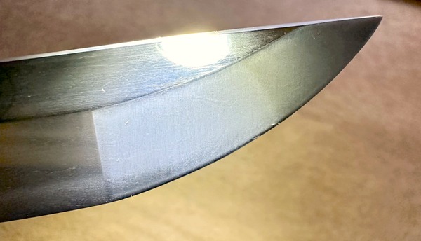

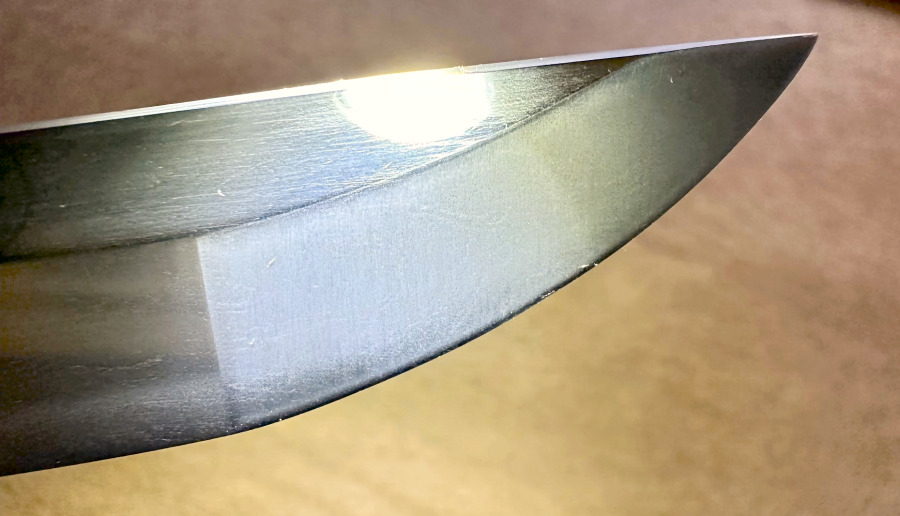

Guest When Necessary Posted February 8, 2025 Report Posted February 8, 2025 It is an absolutely amazing sword - and of such a great age!!! I'm sure it's just the lighting in the pictures (blades are so difficult to photograph) but the hamon seems to disappear at the kissaki. Is it possible to see more shots of the boshi? Thank you! Quote
vajo Posted February 8, 2025 Report Posted February 8, 2025 Its thin but its there. reshaped 1 1 Quote
Lewis B Posted February 8, 2025 Report Posted February 8, 2025 3 hours ago, KungFooey said: It is an absolutely amazing sword - and of such a great age!!! I'm sure it's just the lighting in the pictures (blades are so difficult to photograph) but the hamon seems to disappear at the kissaki. Is it possible to see more shots of the boshi? Thank you! Yes, it's there but as Chris says it's very close to the edge. The jigane activity through the hamon is very Norishige-esque. Love it. Polish looks good too which can't always be said. 1 Quote

Lexvdjagt Posted February 9, 2025 Author Report Posted February 9, 2025 Thanks to everyone for responding. 21 hours ago, Geraint said: Dear Lex. Thank you for sharing this sword with us, it's a beauty! For what it is worth I would not choose to describe the hamon feature as anything to do with Mt Fuji, what are often called picturesque hamon such as kikusui and so forth are associated with Shinto swords. All the best. Thank you, Geraint for the clarification on the Hamon activity. This makes a lot more sense indeed. 21 hours ago, KungFooey said: It is an absolutely amazing sword - and of such a great age!!! I'm sure it's just the lighting in the pictures (blades are so difficult to photograph) but the hamon seems to disappear at the kissaki. Is it possible to see more shots of the boshi? Thank you! Thank you Dee for your reply. I agree with @vajo and @Lewis B the boshi is hard to photograph because it is very thin. I believe your question was answered but I can still take a few pictures if you'd like? 19 hours ago, vajo said: Its thin but its there. reshaped Thank you Chris for your time. I did not realize it was reshaped. Thank you so much for this information. I must say that I generally do not pay as much attention to the boshi as I should. I personally really only care about good Jigane activity. I will be looking closer at the kissaki in the future as well. 17 hours ago, Franco D said: Agree, When enlarging the image three times it looks like more of the "swept sands" formation that makes up the upper portion of the hamon, only it wasn't highlighted in the same manner as the connecting activity. Utsuri? Ladder Utsuri? Hello Franco, Thank you for your reply. I believe you are right about the swept sands. Thank you for your input. I believe I can only faintly observe some Bo utsuri. I am not sure what Ladder Utsuri is, could you possibly explain it to me? Greetings, Lex van der Jagt Quote

Guest When Necessary Posted February 10, 2025 Report Posted February 10, 2025 16 hours ago, Lexvdjagt said: Thank you Dee for your reply. I agree with @vajo and @Lewis B the boshi is hard to photograph because it is very thin. I believe your question was answered but I can still take a few pictures if you'd like? Dear Lex, Many thanks for the offer but that won't be necessary - I can see the boshi now. Once again, it's a magnificent sword! Dee Quote
