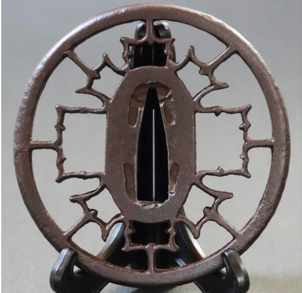

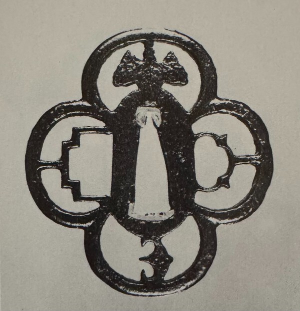

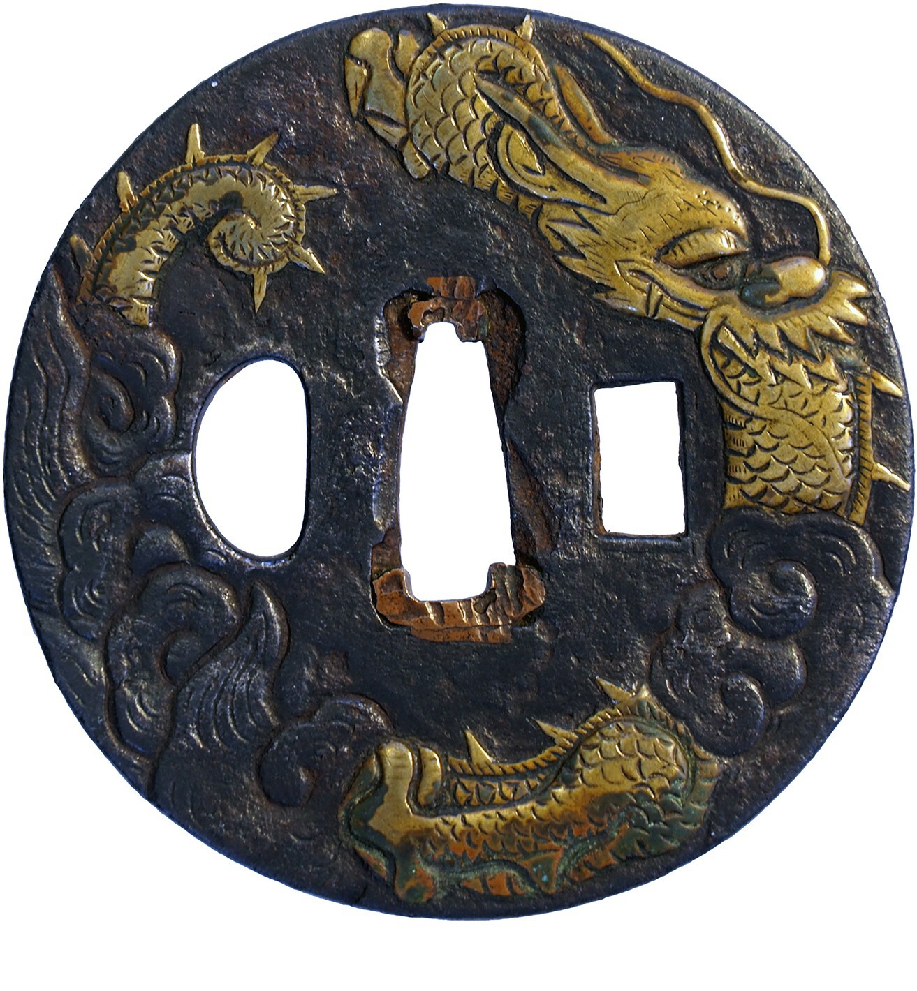

Iaido dude Posted February 6 Report Posted February 6 I have two sukashi tsuba (I have attributed to later Shoami and later Owari) with multi-tiered rectangular hitsu-ana. I have begun to wonder when and where this design element was first incorporated and subsequently used. I am including a few pics from Owari To Mikawa No Tanko of a rare mokko-shaped Kanayama with multi-tiered rectangular kogai hitsu-ana and an Owari with double rectangle hitsu-ana. Shoami double tomoe and myoga (mid-late Edo) Owari matsukawa bishi (mid-late Edo). My koi (Sonny and Cher). Kanayama Owari hyotan 4 Quote

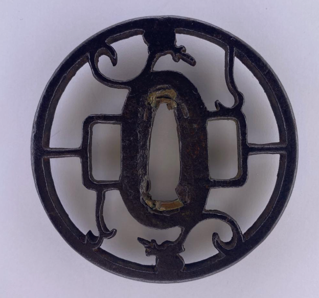

Iaido dude Posted February 6 Author Report Posted February 6 Here is a Kanayama (Holbrook)/Ko-Shoami (Haynes) attributed tsuba. 3 Quote

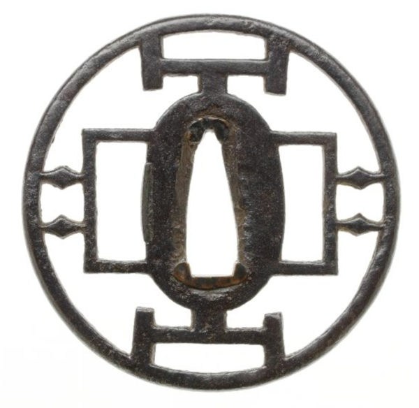

FlorianB Posted February 7 Report Posted February 7 I think, rectangular hitsu-ana should evoke the impression of or a reminisce to old age. Sometimes a connection to Genji-chapter symbols seems possible (the first one). The last one looks like a well frame. 1 Quote

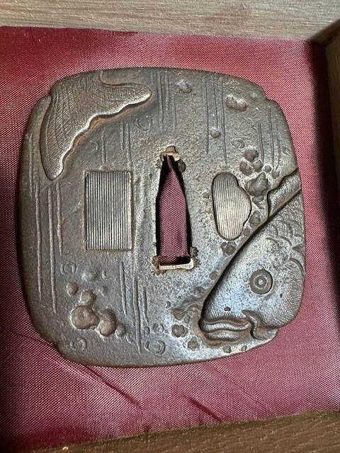

Iaido dude Posted February 7 Author Report Posted February 7 Here is a Kanayama in my collection with the motif of a water well 9rather than a window0, which may be a Buddhist symbol. I posted on this nearly a year ago, but not in relation to the shape of the hitsu-ana per se. The composition includes both the square hitsua-ana (buckets?) and a rectangular section above and below (the frame of the well with crank?). 3 Quote

Soshin Posted February 8 Report Posted February 8 1 hour ago, Iaido dude said: Here is a Kanayama in my collection with the motif of a water well 9rather than a window0, which may be a Buddhist symbol. I posted on this nearly a year ago, but not in relation to the shape of the hitsu-ana per se. The composition includes both the square hitsua-ana (buckets?) and a rectangular section above and below (the frame of the well with crank?). Just some minor points while I wait this evening. shrines = Shinto (jinja 神社) temples = Buddhism (ji 寺) The practice you are referring to is mostly associated with pouring fresh water over the head of Jizo Bosatsu using a wooden ladle typically in the temple courtyard outside of the main temple hall. Sweet tea is also poured using a smaller wooden ladle over the head of a statue of the standing Bady Buddha around the time of historical Buddha birthday which celebrated in April in Japan. 1 Quote

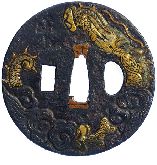

Guest When Necessary Posted February 8 Report Posted February 8 I bought this late last year and posted it on this forum. No idea of the school and at least one person thought it had been reshaped. Now I actually have it in hand, that seems unlikely. Quote
Geraint Posted February 8 Report Posted February 8 Dear Jason. Really like your tsuba, research around Higo Jingo school. All the best. Quote
Iaido dude Posted February 8 Author Report Posted February 8 Very nice composition on your Owari, Florian. Is that a rounded square mimi? Quote
Iaido dude Posted February 8 Author Report Posted February 8 16 hours ago, Soshin said: Just some minor points while I wait this evening. shrines = Shinto (jinja 神社) temples = Buddhism (ji 寺) The practice you are referring to is mostly associated with pouring fresh water over the head of Jizo Bosatsu using a wooden ladle typically in the temple courtyard outside of the main temple hall. Sweet tea is also poured using a smaller wooden ladle over the head of a statue of the standing Bady Buddha around the time of historical Buddha birthday which celebrated in April in Japan. I think you are quite right, David. That reference to shrine was from an American Buddhist website. Definitely not shinto. I will correct the wording in my writeup for my own records. 1 Quote
FlorianB Posted February 9 Report Posted February 9 Steve, You’re right, kaku mimi ko niku. 78mm x 75 mm x 6 mm, I speculate it’s from Genroku period because of the elegant design. IMHO the rectangular hitsu ana should add an archaic touch as mentioned above. Quote

cluckdaddy76 Posted February 10 Report Posted February 10 Geraint, thanks for the feedback. I was leaning that way myself. I have seen a couple listed as Higi/Jingo school that looked similar, but none had the square Hitsu-Ana. Jason Quote
Geraint Posted February 10 Report Posted February 10 Dear Jason. I agree that it's an unusual feature but not altogether unheard of. https://www.ricecrac...471_tsuba_jingo.html Enjoy the journey! Quote
