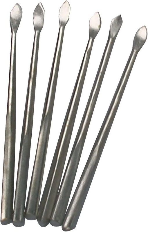

I was not there, and I would not deny that they used drills to make small holes. Spindle drills are an old invention, and it could be done, but it certainly was a time-consuming work. The manufacture of hardened drill-bits might also have been a big challenge, but these were even used on much harder precious stones, so why not on iron? (An image of simple drill-bits for a spindle-drill in the attachment)
It might be of interest that (cutting) spiral drills were invented by Giovanni Martignoni in 1863.
I had a look at a MENPO right now which has a number of small holes in the less than 1 mm thickness iron sheet metal, but the method of making these is not at all evident.
Generally, punching holes cold in thin sheet iron is easy, precise, and fast. Drilling might still be more precise, allow for smaller holes, and the flattening of the metal, possible correcting of a distortion, and finishing the holes is not necessary.
As I am not familiar with armour, I am unable to proclaim a "last word" on that.
John,
work-hardening is done on cold metal with a lightweight hammer and very many fast blows on the chosen part of the surface (as in peening a scythe). Cutting/chiselling a signature would not cause work-hardening, and the same applies to punching a MEKUGI-ANA. This is always done on a red-hot NAKAGO, so absolutely no danger of cracking in the quench.
We often see NAKAGO of older blades with 2 or more MEKUGI-ANA. Usually, one of them was initially punched by the smith. Later MEKUGI-ANA could not be punched and had to be drilled.
There are modern steel alloys with high manganese content (as an example: for rails) that are likely to work-harden so easily that drill holes cannot be pre-punched. The drill-bit would not "bite"!
It remains to be researched when drilling iron/steel was first introduced in Japan. I believe that there is quite a difference in work between thin sheet material and 6, 7, or even 8 mm of a steel NAKAGO.

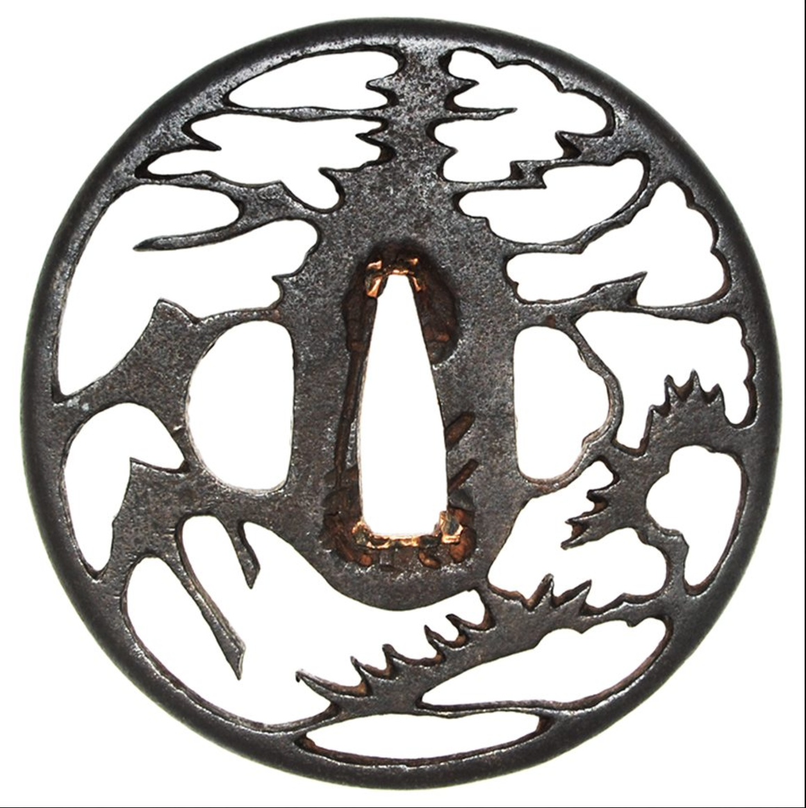

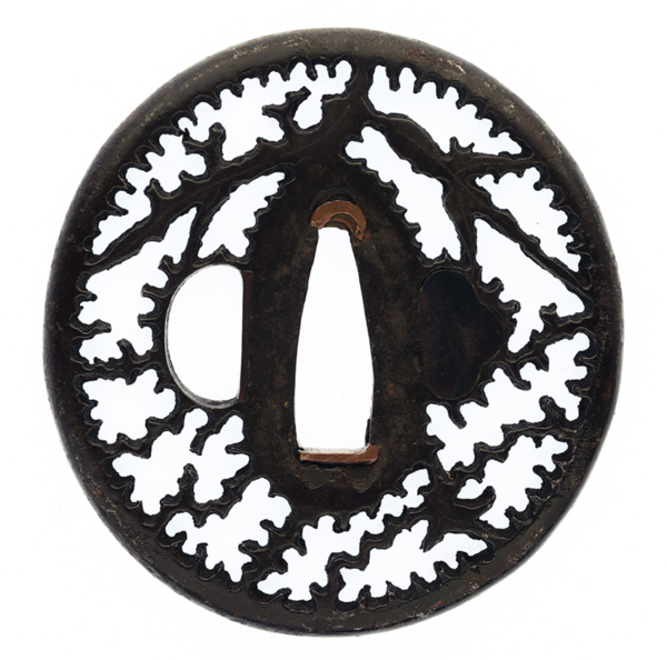

On 1/25/2025 at 7:58 PM, GRC said:
These two are a Japanese concept called "komorebi" 木漏れ日... dappled sunlight "leaking" through trees.
Either looking up through the branches and/or the resulting dancing light and shadows cast on the ground.
To my knowledge, it's a motif whose conceptualization in relation to tsuba sukashi, was first realized by Bruce Kirkpatrick.
I discovered the correct name for it (komorebi) through some extensive searching on Japanese sites... and some luck.
You won't see that motif stated by major papering organizations because it doesn't fall into their narrow set of pre-existing labels.
As with all papering institutions, if it doesn't fit into an existing label, make it fit... because it must have a label... :doubt:
Bruce and I have many tsuba from this un-named maker, and hope to put together a paper on his works some day ;)
He's been chasing down this rabbit hole for years... I happened to stumble on the same path and am now going down the same rabbit hole. lol
The rest of the tsuba on this post (other than the shippo ones) are showing clouds and/or clouds with geese, a much more common motif that was produced by many tsuba makers for centuries.

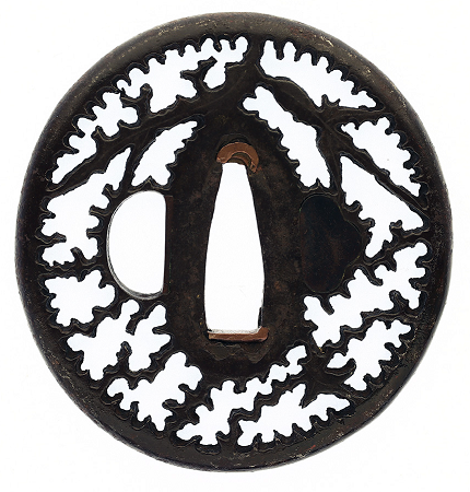

Screenshot2025-01-15at7_31_52PM.thumb.png.7d43fd469a8e98081594af8e04822d03.pngimage.png.c76b690ad2154dc665f281fed9638e68.png
I came upon this tsuba with composition that is described as rokugan (descending geese or geese alighting). Apparently there is a traditional Japanese hard candy with this name because it resembles descending geese. I think that it has some of the elements of komorebi.
https://world.seiyud...m/product/tu-010415/
The motif is called „Katata no Rakugan“ 堅田落雁, descending geese at Katata, one of the famous Eight Views of Omi at Lake Biwa. This is connected with clouds or fog, thus a view to the sky, so komorebi seems unlikely.

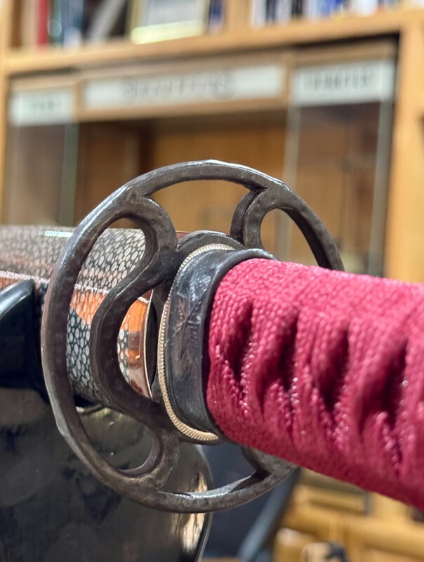

The tsuba arrived. It is round-cornered, slightly dished, and actually has a well-preserved patina with a really impressive seppa-dai. The quality of the forging is quite good. The image by seller on Jauce is overexposed. If I were to give this tsuba a single attribution it would be Shoami because of the seppa-dai and it's more generic Edo period production and sensibility that incorporates numerous influences.
The only issue is that in order to fit it on my iaito, I would have to significantly alter the sekigane. Somehow, now faced with the prospect of altering anything on this tsuba to suit the original intent for use, I hesitate to "defile" it even though it was purchased for $65. It's not about monetary value. It's just a respect for antiques and the history they hold. Thinking about the tradition of repairing tea bowl cracks with kintsugi, and how these flaws simply add another chapter to the intended Wabi Tea aesthetic like the scars and bruises we all experience through a human life, perhaps I shouldn't hesitate to file down the sekagane (pretty non-invasive). Does anyone have any basic tips for doing this?
I include a pic of a Kanayama that I picked up on Jauce for $320 (posted separately earlier), mounted now on a custom-made folded tamagahane katana forged in the kobuse style that I use for tameshigiri practice. The tsuba could be mounted snugly without alteration of any kind.
Dimensions: 65.7 x 62.2 mm, 6.0 mm at mimi, 5.4-5.5 mm at seppai-dai
Wt: 71 g
