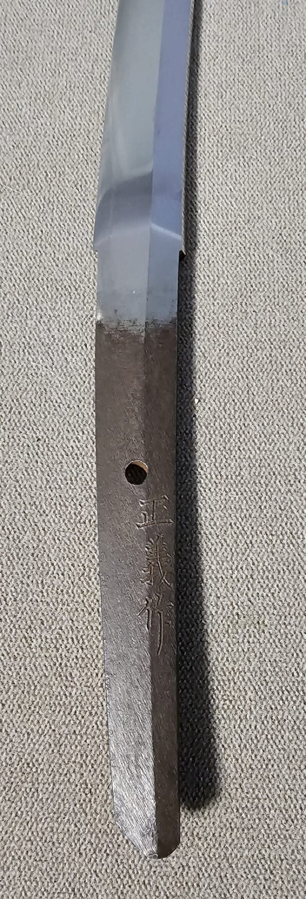

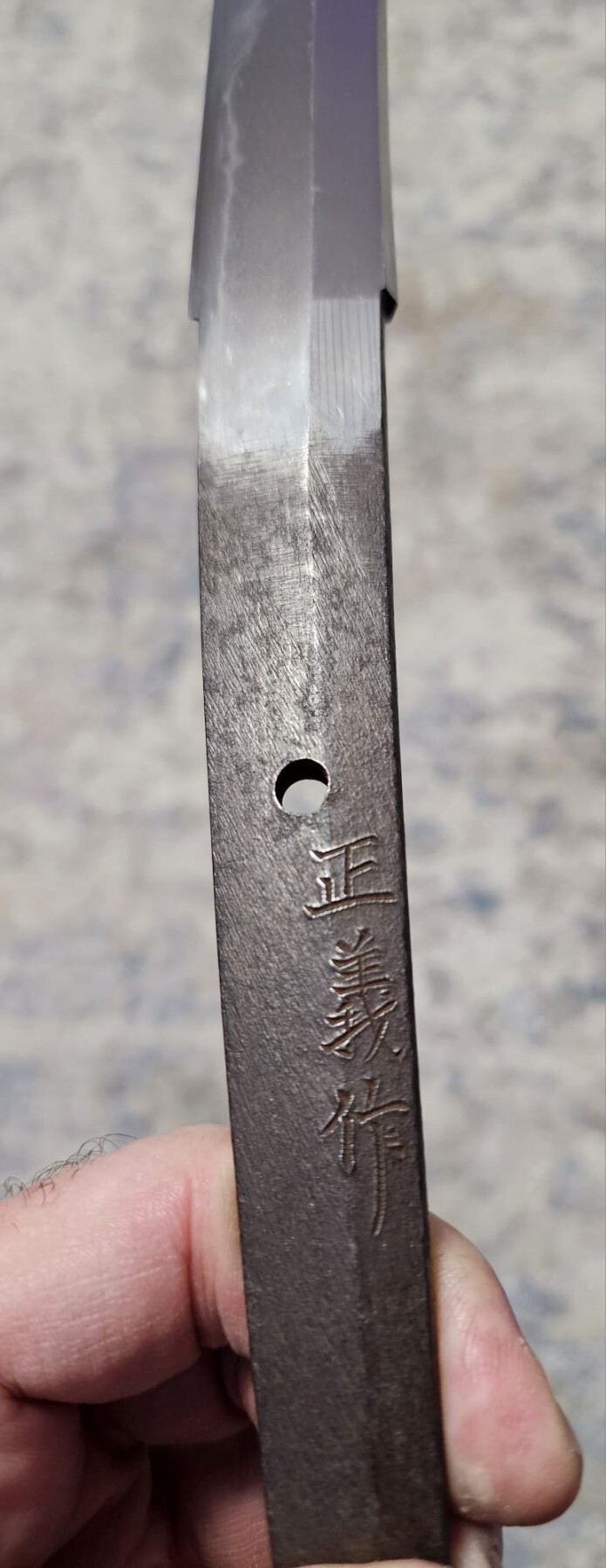

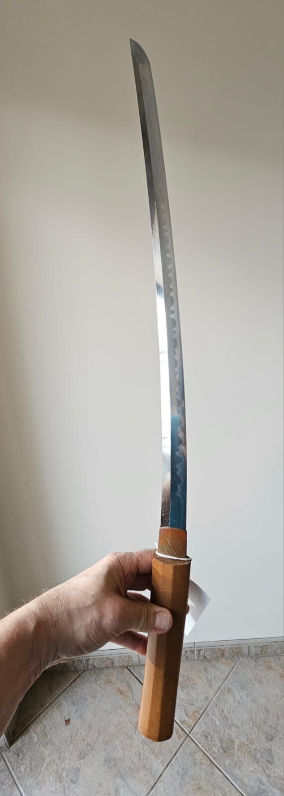

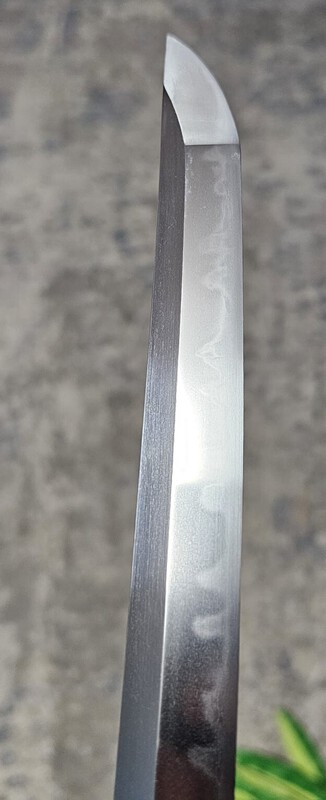

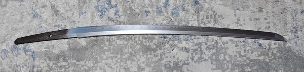

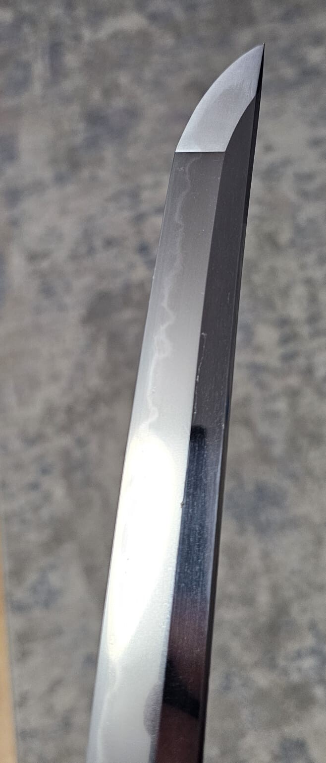

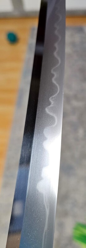

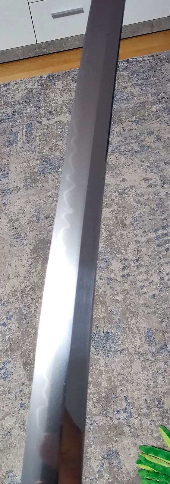

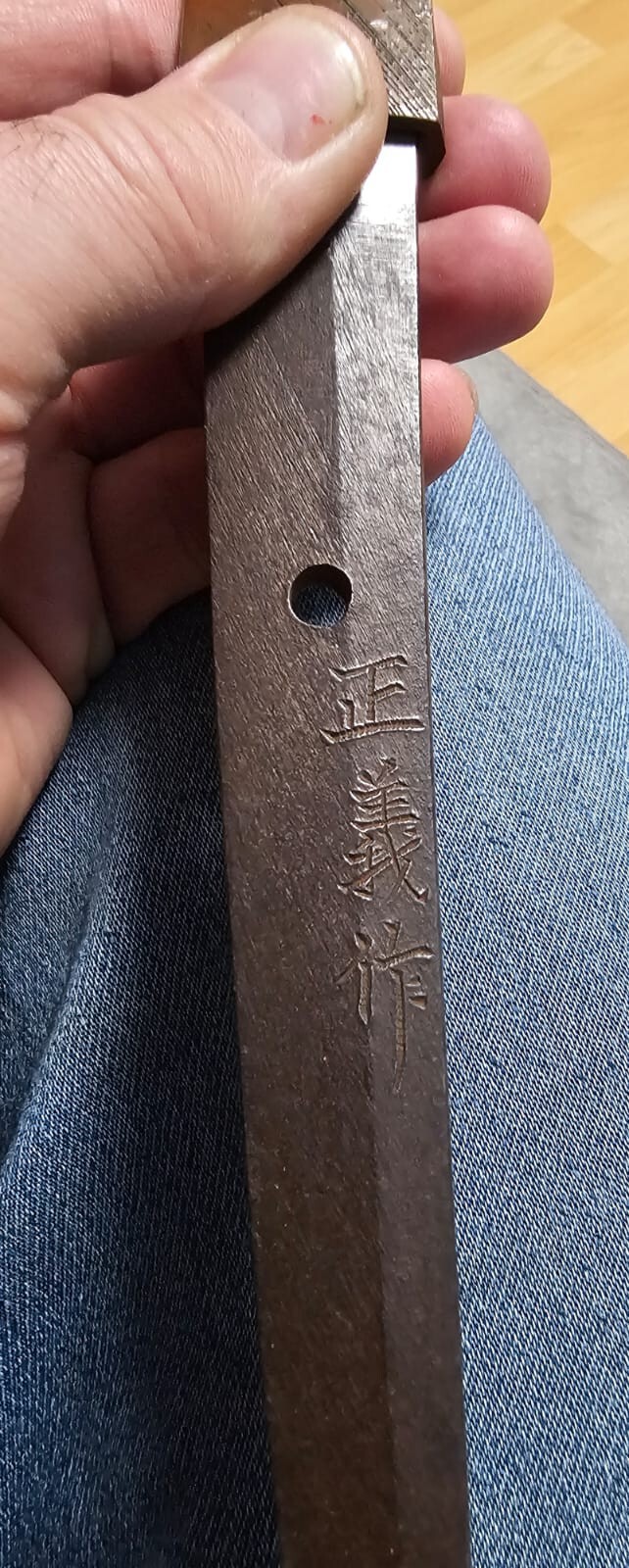

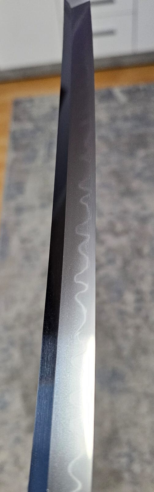

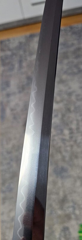

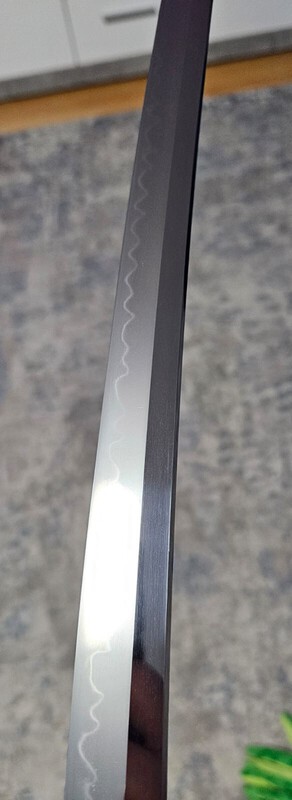

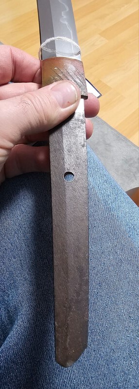

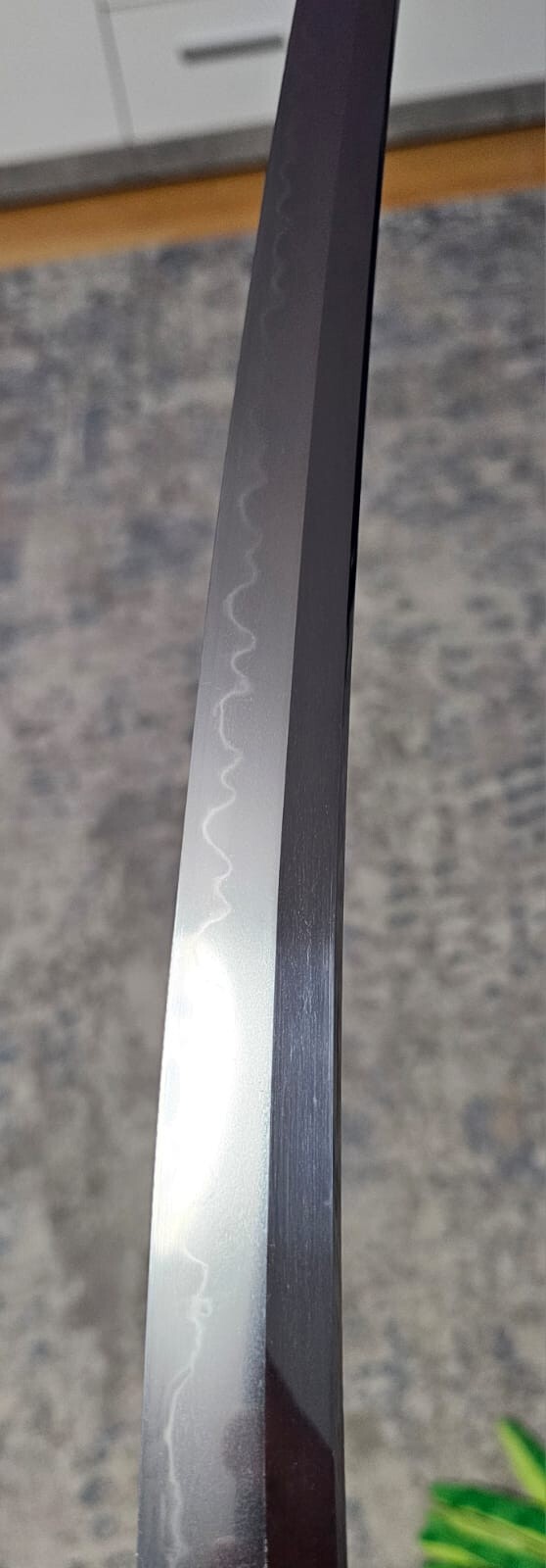

2devnul Posted January 10, 2025 Report Posted January 10, 2025 Hello, Please share your thoughts about below sword. No papers, looking for any additional details. Nagasa 54,8cm; Sori 1,2cm; Quote

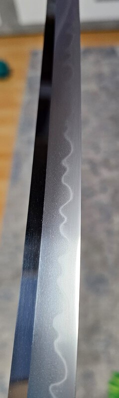

Shugyosha Posted January 10, 2025 Report Posted January 10, 2025 Hi Adam, From the photos, it might be shinshinto, but certainly not koto: I think I can see kesho yasurimei, there's itame hada and I think yakidashi (which might be just the pattern of the hamon) which would point to later than koto. The only potential issue I can see is that the hamon looks to grow a little "shimi" - unclear in one of the photos (6th down near the top of the picture) but that might just be the photo and lighting. Other than that it looks like a nice blade with some interesting activity in the hamon. 1 Quote
PNSSHOGUN Posted January 10, 2025 Report Posted January 10, 2025 Looks to be in decent condition and fairly well made, may be one of the minor smiths of the Hosokawa Masayoshi Den. 1 1 Quote
oli Posted January 10, 2025 Report Posted January 10, 2025 There are a lot of smiths with the name Masayoshi in Sesko Book about Japanese sword-smiths. I think it also can be gendai because of the short signature, but then it should be a little bit longer. Nice sword, thanks for the photos. 1 Quote
2devnul Posted January 10, 2025 Author Report Posted January 10, 2025 Thanks for the comments gentlemen, please keep them coming. 7 minutes ago, oli said: There are a lot of smiths with the name Masayoshi in Sesko Book A lot of them (with good pictures of swords) in Internet too. I'm struggling to get even close in order to pin-point which smith/school it is. I wish this sword to be Hosokawa Masayoshi Den, but then it should look Bizen/Shoshu-den alike, which it isn't (as per my amateur judgment). Quote
oli Posted January 10, 2025 Report Posted January 10, 2025 25 minutes ago, 2devnul said: A lot of them (with good pictures of swords) in Internet too. I'm struggling to get even close in order to pin-point which smith/school it is. I wish this sword to be Hosokawa Masayoshi Den, but then it should look Bizen/Shoshu-den alike, which it isn't (as per my amateur judgment). For me it looks more like mino-den. Does it have a yakidashi? Quote

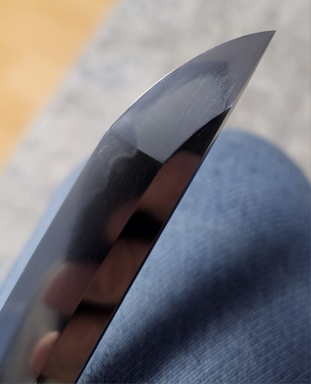

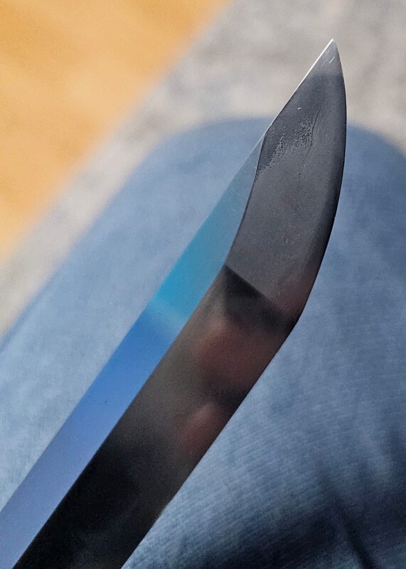

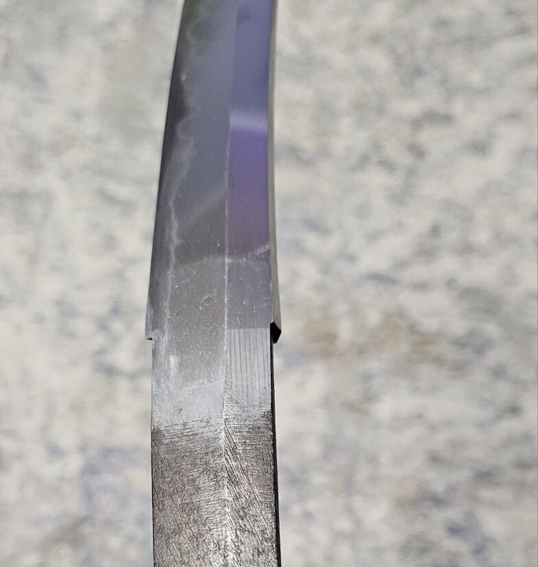

2devnul Posted January 11, 2025 Author Report Posted January 11, 2025 21 hours ago, oli said: Does it have a yakidashi Thanks Oli! Let me first check what yakidashi is and I will get back to you. In the meantime few more pictures. Maybe Hamachi or sugata can help. 2 Quote
2devnul Posted January 11, 2025 Author Report Posted January 11, 2025 Mr. Sesko helped with understanding what yakidashi is. Now the question is, which one do you see. 1 Quote
oli Posted January 11, 2025 Report Posted January 11, 2025 i am not a expert, but i guess Osaka Shinshinto ( of course not the Gassan Group). There was a smith: MASAYOSHI (正義), Kaei (嘉永, 1848-1854), Settsu – “Ōsaka-jū Kuroda Masayoshi” (大坂住黒田正義), “Masayoshi” (正義), real name Kuroda Sukeichirō (黒田助一郎), student of Ozaki Masataka (正隆), he also worked in Harima Question is, is this Osaka yakidashi? 1 Quote
Shugyosha Posted January 11, 2025 Report Posted January 11, 2025 I can’t tell - for me it doesn’t seem to fit easily with either Osaka or Kyoto styles of yakidashi. 1 Quote
2devnul Posted January 11, 2025 Author Report Posted January 11, 2025 29 minutes ago, oli said: Question is, is this Osaka yakidashi? I have no idea, I just learned today what yakidashi is in general Overall condition of the sword suggests either very late shinto or shinshinto, so that guess could be a good one. I will need to find some "papered" swords of this smith and compare the work. Thanks for the help gentlemen! I'm looking forward to any other comments. 1 Quote
PNSSHOGUN Posted January 12, 2025 Report Posted January 12, 2025 Hamon looks closer to the Yokoyama Sukesada Mon. 1 1 Quote
oli Posted January 12, 2025 Report Posted January 12, 2025 2 hours ago, PNSSHOGUN said: Hamon looks closer to the Yokoyama Sukesada Mon. yes maybe also because of koshizori....` Quote
