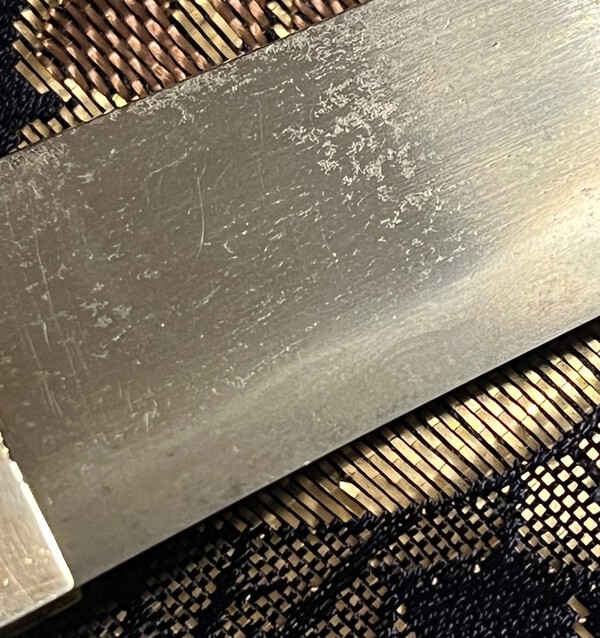

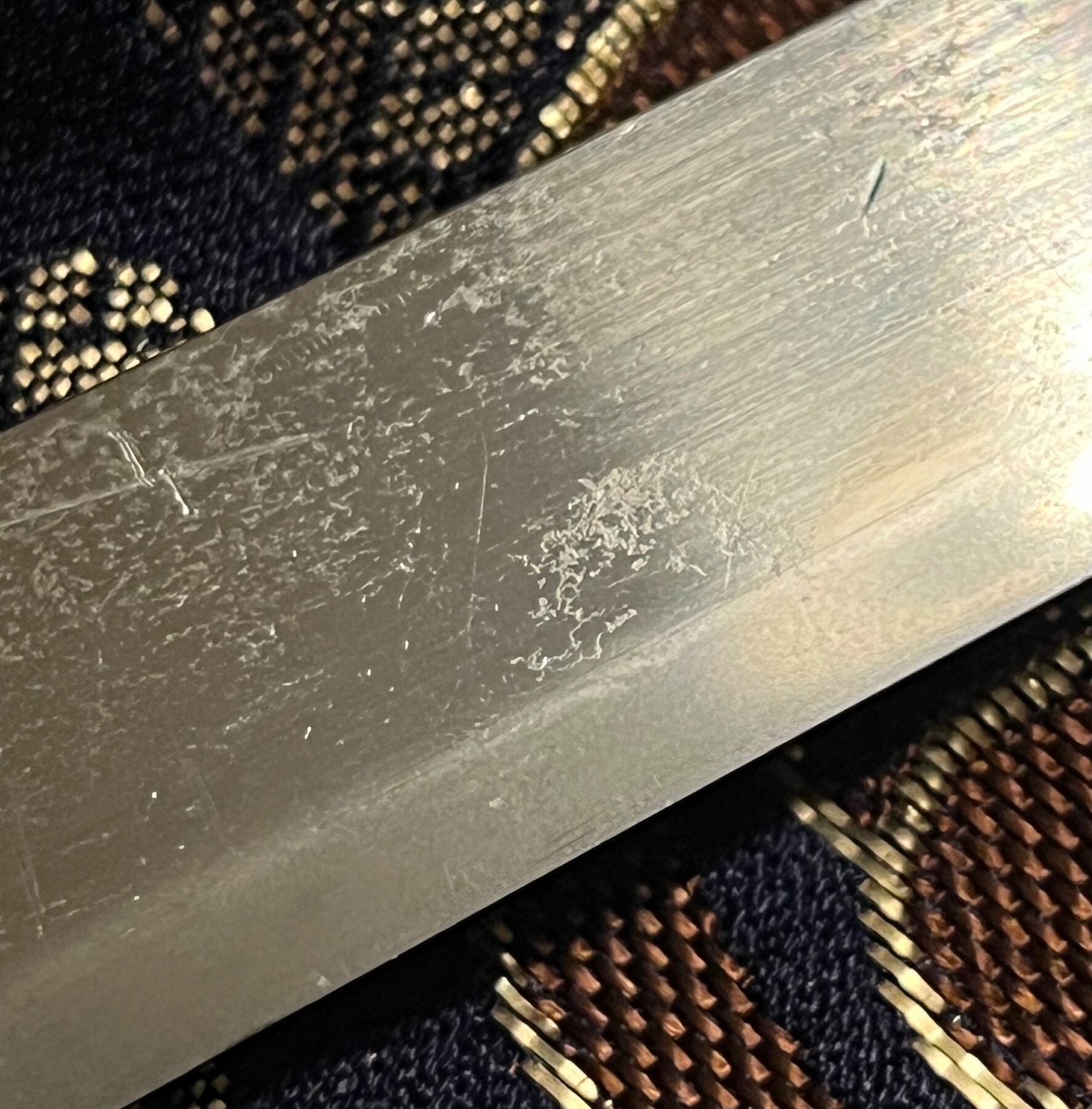

Bugyotsuji Posted November 29, 2024 Report Posted November 29, 2024 Recently I bought a melange tanto more for the tosogu than for the blade. I was debating whether to put it under Nihonto here or under Tosogu, but since it is a registered blade I have decided to respect that. 1. The blade is slim, but with thick kasane. The condition is not good, to put it politely. One side has the remains of 八万大菩薩 Hachiman Dai Bosatsu. The other has a small pit or hole in it. The hamon is suguha, but does not scream anything special to me. The silver habaki fits very tightly, but there is no tsuba, more like one thick silver seppa. It is unsigned, so cannot be declared gimei! I have a bag of Tantō tsuba, but none fits, like the ugly sisters’ feet and Cinderella’s slipper. 2. The Saya is an interesting lacquer finish, and the saya fittings are iron: there is an iron bashin in the narrow slot. The tsuka menuki are two branches of Japanese apricot (plum) in shakudo and gold. The shakudo fuchi has a wonderful suaka lobster on a fine nanako ground, and is signed Hidetsugu + kao. The work is good but the Mei could have been added later. The kashira is also shakudo with nanako-ji, and the design looks to be noshi (?) jinja hangings. My plan is to show this to some artisans and get feedback on it. Is the package worth saving, or improving? Will I be having the blade polished, for example, or should it be left alone as a kind of tsunagi? Should I let this one slip quietly back into the market? General shots follow... 7 Quote
Ray Singer Posted November 29, 2024 Report Posted November 29, 2024 The blade looks like a nice Sue-Bizen tanto with attractive shape. I don't typically recommend investing in restoring mumei Sue-Koto, but I would not completely discount it and it certainly looks too nice to classify only as a tsunagi. Perhaps a madoake is in order, to evaluate the workmanship and health, and decide from there. 3 Quote
Ray Singer Posted November 29, 2024 Report Posted November 29, 2024 I recently had the surprise of seeing that the NBTHK is now awarding Tokubetsu Hozon to osuriage mumei Muromachi blades with only a school attribution, not even to a specific smith, so some of the advice that I've given in the past about how high a mumei Muromachi period blade can achieve needs to evolve. 2 1 2 Quote

Lewis B Posted November 30, 2024 Report Posted November 30, 2024 The Bashin is rather cool. Overall a very handsome setup. What is the motokasane measurement? 1 Quote

Lewis B Posted November 30, 2024 Report Posted November 30, 2024 17 minutes ago, Bugyotsuji said: Not sure Lewis. I'll get it out and measure it. (That's the thickness at the habaki, right?) Yes, I love these little bashin, though they do not come up too often. Correct. At the munemachi to be precise. And a measurement just in front of the habaki as this is often where the sharpener will start sharpening. Going further towards the nakago and he risks loosening the fitment of the habaki. Yes, I have one as part of my Shikkake's Tensho koshirae, with a wave motif to match the tsuba. It also has that heart shaped design element which I was told is not actually a heart but boars eye (inome) iconography. The inome represents bravery and determination shown an attacker by a provoked boar. They are pretty rare, having only seen a couple. 1 Quote
Bugyotsuji Posted November 30, 2024 Author Report Posted November 30, 2024 At the munemachi Lewis, the kasane is roughly 0.6 cm by my non-digital Shinwa. The thickest part of the nakago is just behind that at 0.7 cm, covered by the habaki. Quote
Lewis B Posted November 30, 2024 Report Posted November 30, 2024 That would suggest to me the blade hasn't been overly polished being quite consistent from the Nakago. Certainly a candidate for further consideration re a fresh polish. Quote
Bugyotsuji Posted November 30, 2024 Author Report Posted November 30, 2024 Ah, now I understand where you are coming from. Thank you. Yes, that makes sense. I spent some time just now trying to find some evidence of hamon that could actually be photographed under the kitchen light! Will check the shots and see if anything came up... warts and all. May be beyond redemption. 1 Quote
Matsunoki Posted November 30, 2024 Report Posted November 30, 2024 Hi Piers Looks an elegant ubu koto blade…..not everything has to be in perfect polish (imo!) ……lovely saya. Hamon/boshi looks healthy in these pics. Wonder if the fuchi is a replacement? Trouble with getting it repolished…..means shirasaya which then means tsunagi which then means the blade can’t really go back into it’s original saya which seems a pity…..but then I like “original packages” that can stay assembled together. 1 Quote
Bugyotsuji Posted November 30, 2024 Author Report Posted November 30, 2024 I am still trying to imagine what has happened to this blade. Possibly it was in shirasaya, registered, and someone had the bright idea of putting together a koshirae package. The saya and bashin seems to be iron-based.The tsuka however is shakudo with a nice pair of matching menuki, and ... maybe the fuchi and kashira are random, or as you say, perhaps the fuchi has been changed? The blade does kind of fit, but not perfectly; the two mekugi holes are too near the habaki to allow for a fat tsuba, or a even a super thin tsuba and seppa set. It looks like a new hole for either the nakago or the tsuka if a tsuba is to be fitted. Anyway, thanks everyone for the thoughts so far, nudging me in hopefully in the right direction for this blade. I always end up trying to 'improve' what I find out there, in some small way righting the wrongs that others have found too troublesome or too expensive to bother with. :nuts: Quote

Bugyotsuji Posted December 15, 2024 Author Report Posted December 15, 2024 Last night I took this to the local NBTHK sword meeting but quickly warned them it was going to be a detective story. The blade was reckoned to be ShinShinTō, of indeterminate regional manufacture. The saya they liked, perhaps original to the blade. The tsuka has most probably been changed at some point. It was pointed out that this was not necessarily ‘wrong’ or uncommon, even in times past, as quite a bit of crossover took place. (Mix ‘n match?) No one gave any suggestions as to how to move this one forward. The silence spoke about not sending good money after it. So, possibly I should just release it back into the stream, where someone else might choose to either enjoy it as is, or improve it, or break it up and sell the tōsōgu separately.(?) 2 1 Quote
