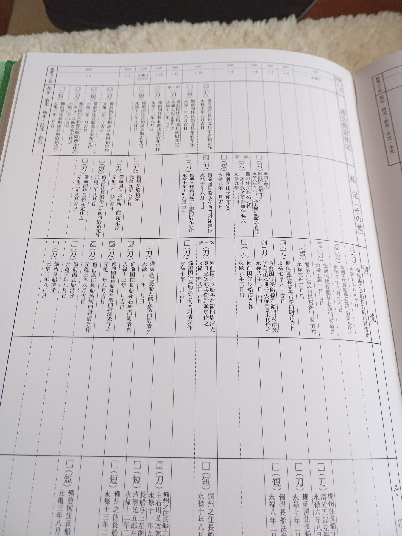

Jacques Posted July 28, 2024 Report Posted July 28, 2024 Quote I have seen nagamei Kiyomitsu/Sukesada without nengo I would love to see an example. The Osafune Taikan lists 54 Swords signed Kiyomitsu all have a nengo. All Bizen swords with a nagamei and sue koto have a nengo Example below 1 Quote

klee Posted July 28, 2024 Author Report Posted July 28, 2024 2 hours ago, Jacques D. said: I would love to see an example. The Osafune Taikan lists 54 Swords signed Kiyomitsu all have a nengo. All Bizen swords with a nagamei and sue koto have a nengo Example below Here s a few off the top of my head. Sue Bizen nagamei+nengo is the norm not a set in stone rule. Quote

Jacques Posted July 28, 2024 Report Posted July 28, 2024 Ok your first reference is from the site shoshin which cannot be considered as a very reliable source. The second is a Sukesada (more 70 Sukesada) and it is obvious that kazu-uchi mono are excluded and I wonder why the literature does not mention this fact, here is what the nihonto Koza (Afu translation) says Quote
