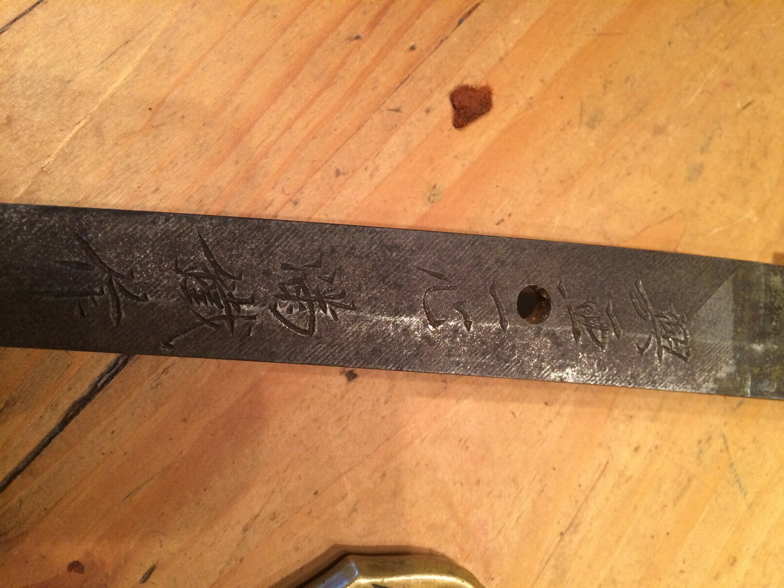

Can any of the learned and experienced members comment on the mei here?  I posted this to a FB group but just realised that I should’ve come here first.
It looks like they left out the “kore” symbol from Mantetsu Tsukuru Kore!

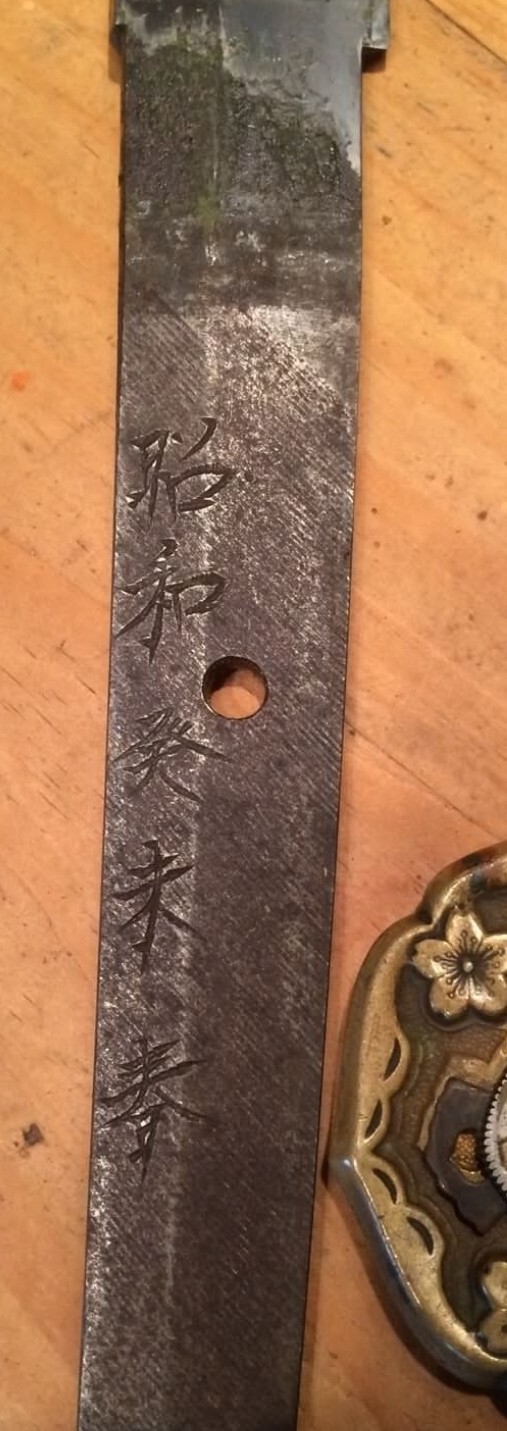

On the other side of the nakago I could figure based on Ohmura’s page that the first figure is Showa and the last is also Haru… but can’t figure out the middle two characters, they didn’t seem to correspond to any kanji symbols I could find.
Ha!  You're right, they left off that last kanji.  We've see a couple Mantetsu over the years with errors, but it's pretty rare.
This is where I go to translate Zodiacal dates: Japaneseswordindex.com - Zodiac Dates, but it's Spring 1943.
Do me a BIG favor and post a photo of the full serial number on the back edge of the nakago.  I like to file a couple of shots of the overall rig, too, with fittings.

Certainly - once I get a chance I'll get some pics posted.  Thanks for the info!
2 hours ago, Brian said:
As far as I know, saku and kore are interchangeable largely. Don't think that would be considered a mistake. You get saku, kore, kore kitau etc.
It's still complete as to meaning.

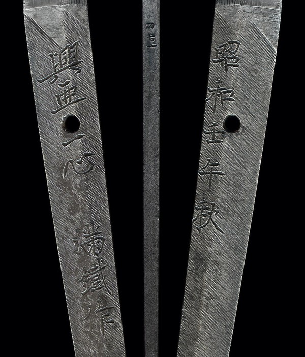

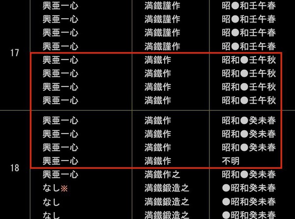

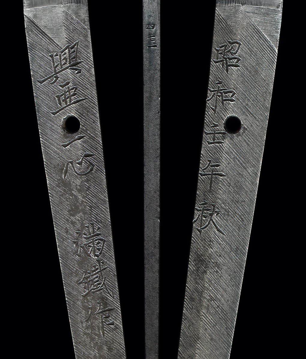

Some Mantetsu that were produced in the autumn of 1942 and the spring of 1943, bearing the signature "Mei 滿鐵作" rather than "滿鐵作之." Such swords are not uncommon.
昭和壬午=1942
昭和癸未=1943
http://ohmura-study.net/222.html
OH!  Good catch, Trystan!  I hadn't noticed that before.

That is "Ki" キ122.  Mantetsu used katakana to serialize their production line.  Ki was the ninth line (out of 15) for the year 1943.  I do not know if their "year" was calendar year or fiscal year.  Fiscal year started in April, but you can sort of guess-timate the timeframe.  Ki was 3/5 of the year (9 out of 15), so around May or August, depending on which "year" they were going by.
