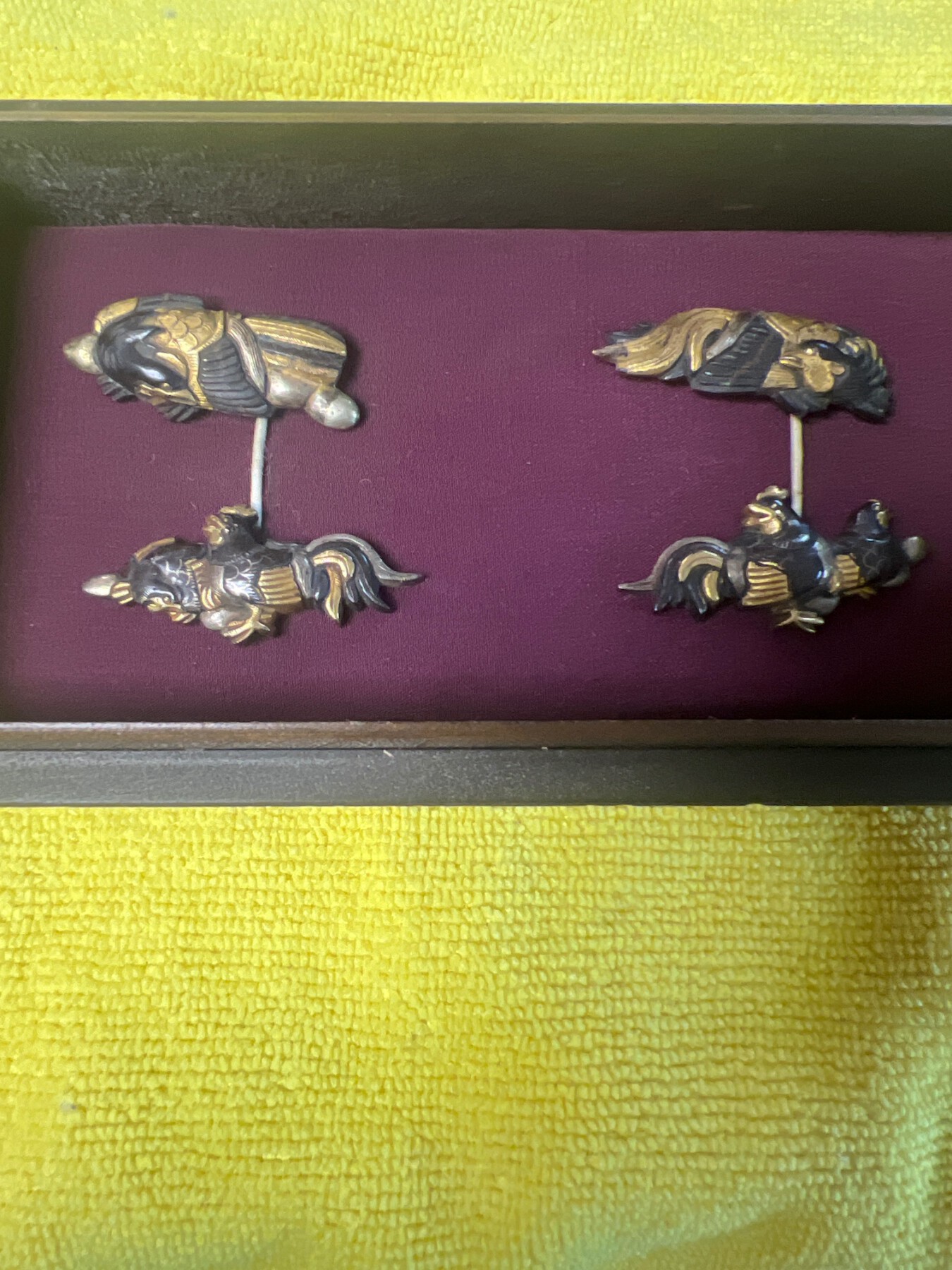

cluckdaddy76 Posted May 11, 2024 Report Posted May 11, 2024 Would these be considered a true daisho set? 2 Quote
SteveM Posted May 13, 2024 Report Posted May 13, 2024 The way these are boxed, it definitely gives the impression they were intended to be sold as daishō menuki. On the other hand, I would expect the wakizashi menuki to be noticeably smaller in a daishō set, whereas both pairs of these menuki look to be the same size. Also, the workmanship looks late Edo and possibly early Meiji, even. Not very expertly carved, and maybe even cast. So then you get close to the rabbit hole of the question of "what is a true daishō?" It's a question that sparks a lot of animated discussion. If you search this forum, you can find other threads on it. Quote
cluckdaddy76 Posted May 14, 2024 Report Posted May 14, 2024 These may not have come together; they are in a large collection I acquired. The lower pair is papered by themselves and not as a set. I am still waiting to see if there are papers for the upper pair, we are still sorting through things from a large estate. Both definitely not cast, but lower pair to me looks better quality. I am not convinced they are a true pair myself based on size, but someone I showed suggested it was since one was a single large hen/rooster and the other was a pair of smaller birds. Unfortunately, this large collection was abused for many years and some papers have most likely been lost. This was just a single box that I placed both pairs in for the pic. This is also a mediocre pic, they look much better in hand especially the bottom pair. Top pair if cleaned a bit should bring out a bit more detail. Quote
