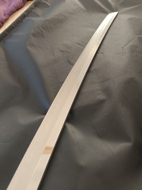

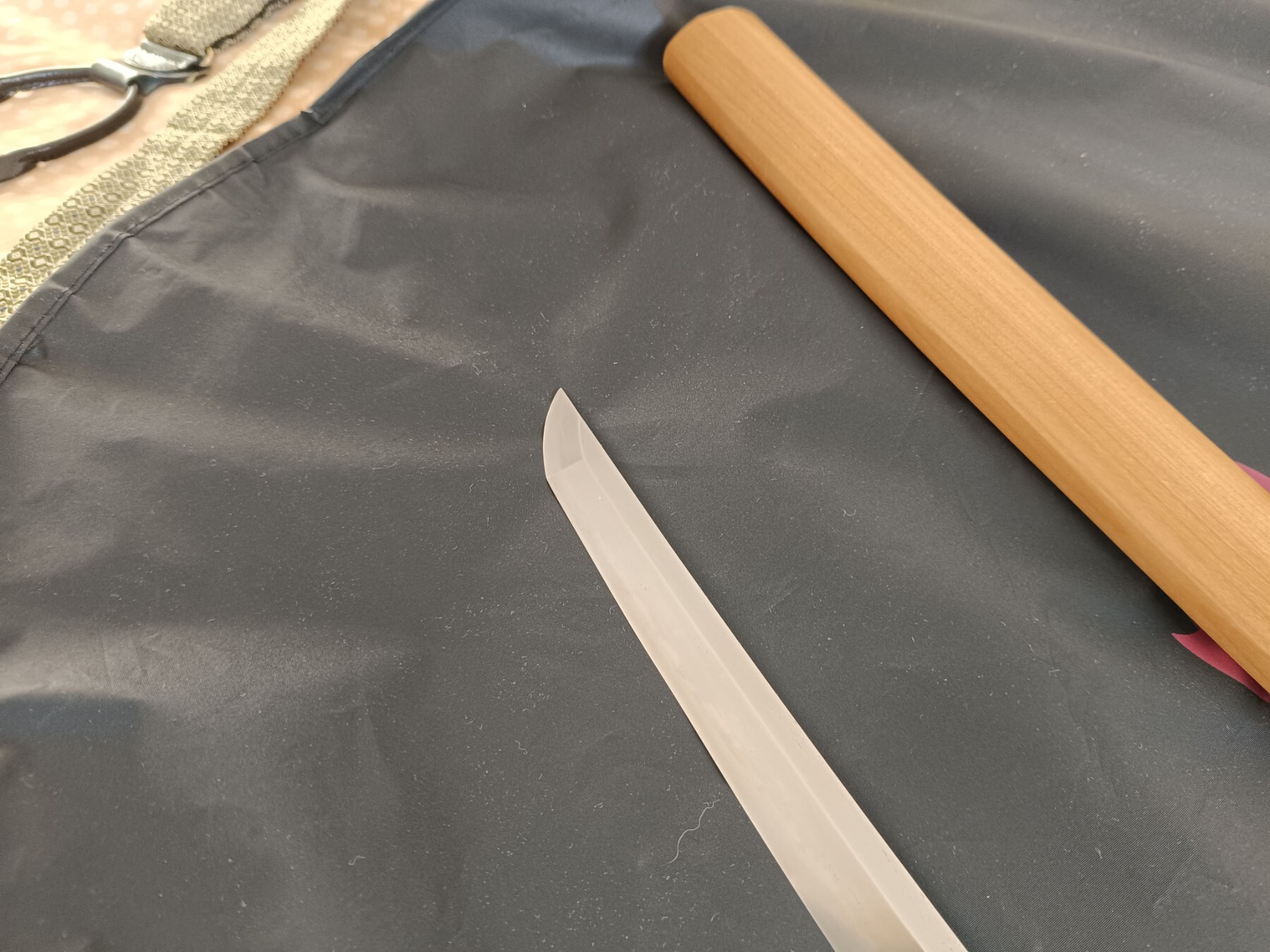

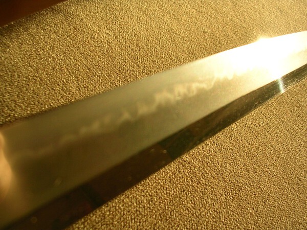

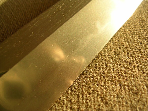

Abaris Posted April 17, 2024 Report Posted April 17, 2024 Hello all, I acquired this wakizashi a few years ago and I noticed I can't find a clear boshi. My fear is has been reshaped rather than a bad polish. What do you think? It also looks like the habaki has been "polished" as it looks like it has some remnants of some kind of rain decoration. The seller said it was in original polish when I bought it but... I don't know if that is true. What is your opinion on the subject? Quote
Ray Singer Posted April 17, 2024 Report Posted April 17, 2024 It appears to clearly have a boshi in the photos above. The kaeri is not very clear but I do see the boshi. Are you saying that it is missing in one part of the kissaki, or that you are not seeing the boshi at all? Quote
Abaris Posted April 17, 2024 Author Report Posted April 17, 2024 @Ray Singer it's true I can guess it is there when looking at the pictures but I cannot while looking for it with my eyes... I mean, the hamon is clearly seen unlike the boshi. Polisher fault? Nihonto fault? Maybe smith's fault or even my own? Are you seeing the kaeri? Because I'm not... I'll try to get better pictures tomorrow anyway. About the kissaki, I do not think it has been reshaped, what is your opinion on that matter? Thank you very much for taking the time to answer. It's really appreciated. Quote
Abaris Posted April 17, 2024 Author Report Posted April 17, 2024 BTW, it's a Muromachi (Koto) wakizashi, ubu. Quote
Franco Posted April 17, 2024 Report Posted April 17, 2024 52 minutes ago, Abaris said: My fear is has been reshaped rather than a bad polish. That is a definite possibility. If that is indeed the case, then it appears that the polisher did not reshape the entire kissaki as what should have been done. However, as Ray said, it does appear like some boshi remains. Regards 1 Quote

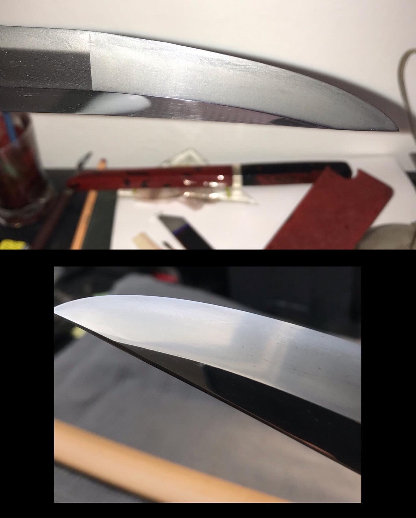

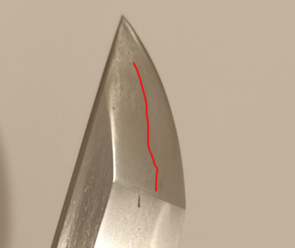

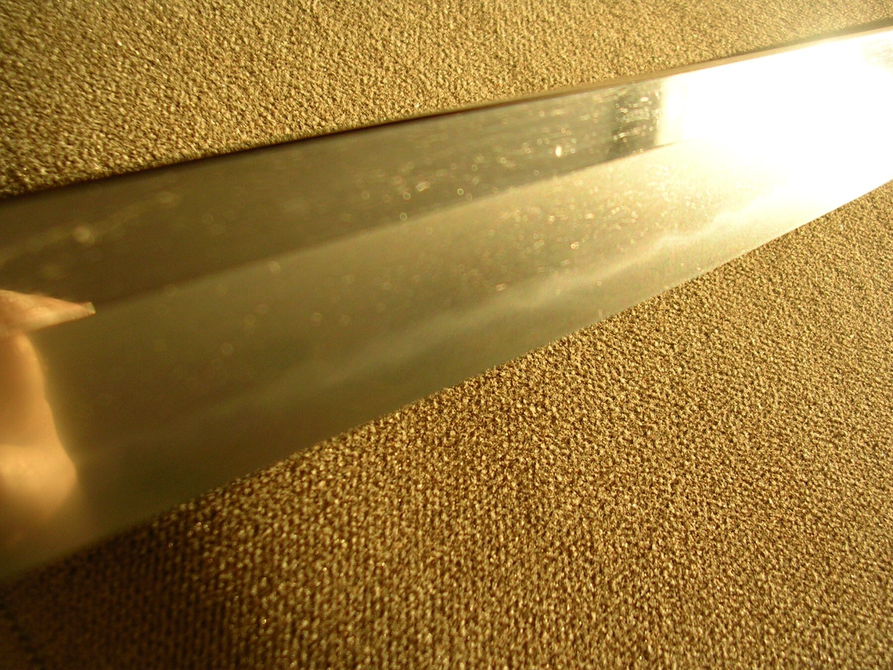

DoTanuki yokai Posted April 18, 2024 Report Posted April 18, 2024 I would say you should experiment more with the lightning and angle at which you look or photograph the boshi. It is common that the boshi does not get the Hadori polish and is harder to see. I posted pictures that shows how much the light and angle have an impact. 1 1 1 1 Quote

2devnul Posted April 18, 2024 Report Posted April 18, 2024 Hello, Same as Ray, I can see Boshi without Hadori but no Kaeri. But only on first picture. I'm not able to see it on other pictures, so please try to make some more as advised by Christian. For me it doesn't look like a reshaped Kissaki. Maybe you can compare Kissaki with other swords from this smith to see if there is any significant difference. It could be just lack of Hadori = Togishi fault, not yours (unless you were cleaning Kissaki with Uchigo like crazy ) 1 Quote

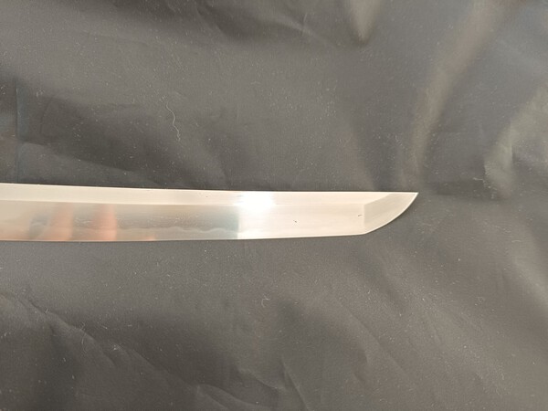

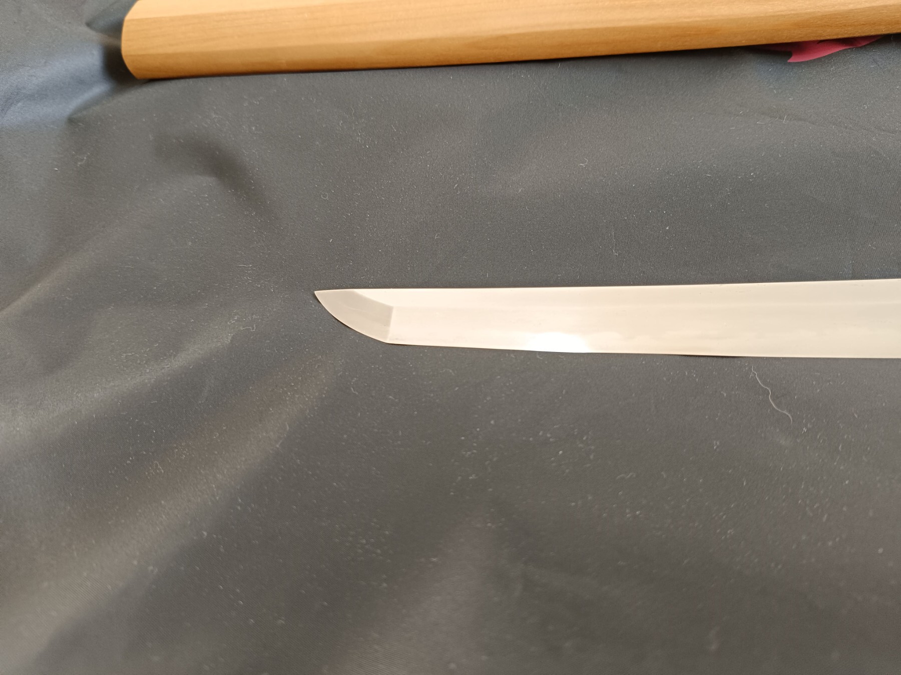

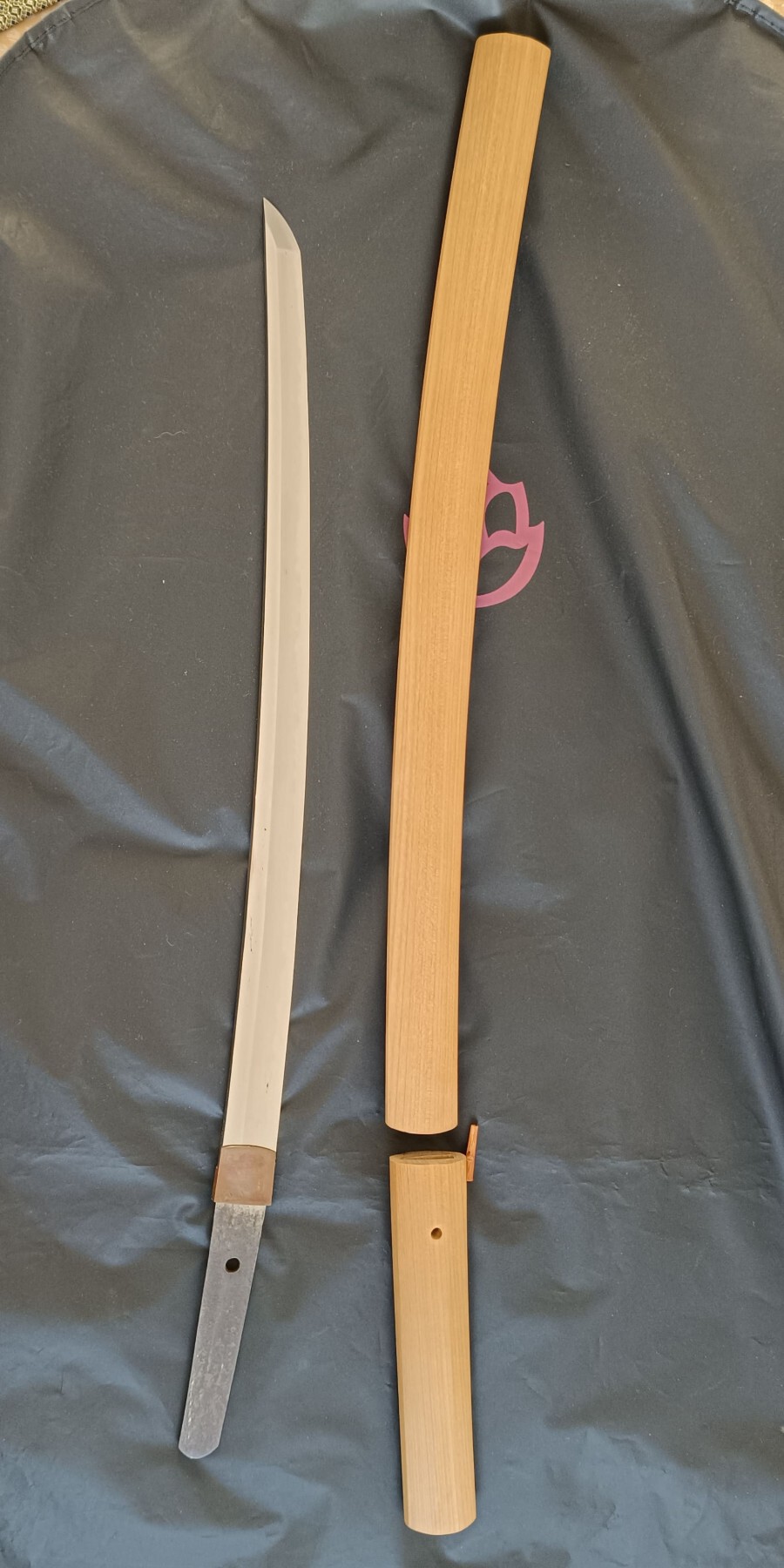

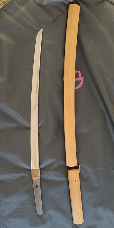

Abaris Posted April 21, 2024 Author Report Posted April 21, 2024 Here are some more pictures. On one side I have been able to see the boshi with sun light, not so much on the other side, but still there. Quote

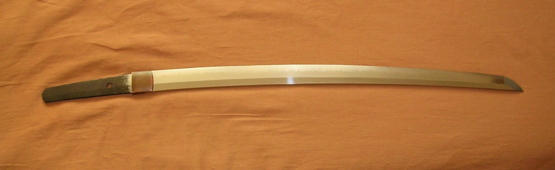

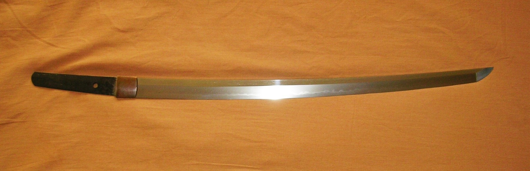

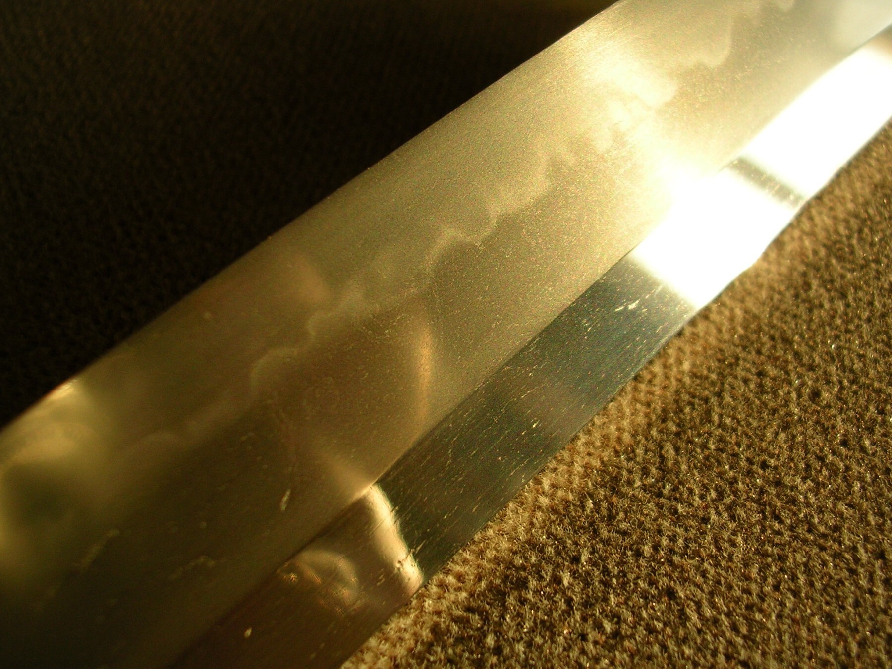

2devnul Posted April 28, 2024 Report Posted April 28, 2024 "Mihara ju Masaie saku" does ring a bell. I think my friend have/had sword signed like this. I will ask him for pictures. 1 Quote
Abaris Posted April 29, 2024 Author Report Posted April 29, 2024 I think it is the exact same blade 1 Quote
2devnul Posted April 29, 2024 Report Posted April 29, 2024 He sold that sword years ago. So it is possible. 1 Quote
