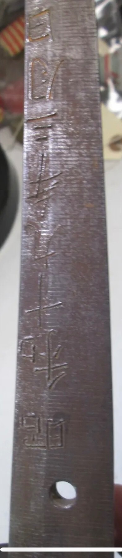

Swords Posted February 21 Report Share Posted February 21 I’m looking to verify help with signature and date Any help is appreciated Quote Link to comment Share on other sites More sharing options...

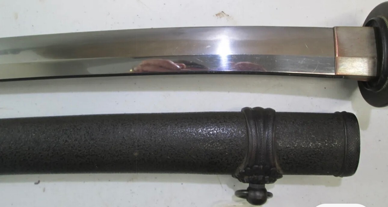

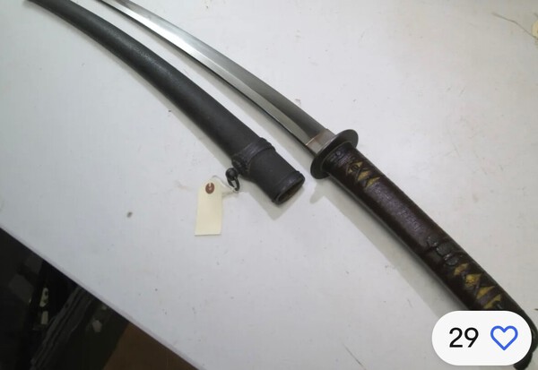

Bruce Pennington Posted February 21 Report Share Posted February 21 Hi Steven, This was made (date upside down) March 1944. Someone will have to help with the mei (maybe Masatomo? But I'm not good at mei). On another note, this is not an NLF sword. Never used by the navy. It comes by many names, since for decades no one really knew what they were. Nick Komiya found the documents and history of them, though, a couple years back. They were a contingency model produced for the Army, designed to cost less but be more durable in the field. Since there is no real name for them, they are now called Contingency Model, or Japanese version - Rinji seishiki. Thomas calls them a Type 100 as they were officially announced in 1940. You can read all about them: Not a "Type 3" and Unveiling the Rinjiseishiki in 1940 3 Quote Link to comment Share on other sites More sharing options...
xiayang Posted February 21 Report Share Posted February 21 I believe the mei is 東神正茂作 = Tōshin Masashige saku See also this old thread: 2 Quote Link to comment Share on other sites More sharing options...

Bruce Pennington Posted February 22 Report Share Posted February 22 19 hours ago, Swords said: one listed on EBay his is NLF or states NFL mounts So what’s the difference? This is quite common. Mostly, I don't think many collectors, or sellers, know of the history. Even when they do, I still see them use such terms most likely because there are certain names prospective buyers use to google search. Type 44, Type 3, Late-war Army, NLF, Marine Landing Sword are the most common names used for this style, so sellers will put such names in the titles to draw in searches. I know a seller that puts all sorts of names in his titles, even though I know he knows the names are inaccurate, like "WWII Japanese officer NCO shingunto sword", just to maximize the search engine results. Quote Link to comment Share on other sites More sharing options...

vajo Posted February 26 Report Share Posted February 26 Type3 Nothing else. When someone wrotes nlf i allways think he has no clue. The other terms like RS are total strange and sounds odd. Quote Link to comment Share on other sites More sharing options...
John C Posted February 26 Report Share Posted February 26 5 hours ago, Swords said: overly loose Steve: In that one particular auction from Eric you referenced above, he mentions the word "minty" 9 times in the description, though he is not selling mouthwash. He also uses the word "samurai" in the title when he knows perfectly well it was not and could not have been used by a samurai warrior. As Bruce noted above, sellers use words that attract unknowledgeable buyers to increase viewer traffic. So his use of NLF and other words are for marketing only. This is the "overly loose" use of words to attract buyers. Hope this helps, John C. 3 Quote Link to comment Share on other sites More sharing options...
tbonesullivan Posted February 27 Report Share Posted February 27 Isn't that the type of Rinji Seikishi used on the RJT swords? The textured lacquered scabbard, "cup" shaped seppa, the lacquered ito and shape of the tsuka. It's definitely not the "run of the mill" "P-1944" which has the tan finished steel scabbard. Those usually go for a lot more than the "P-1944" with the arsenal blades, though that's subject to the condition of the blade, as always. Quote Link to comment Share on other sites More sharing options...
