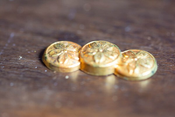

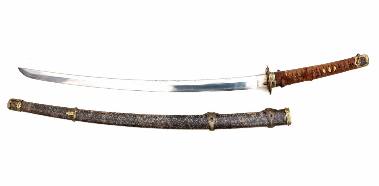

I bought this type 94 Gunto yesterday at auction,  Picked it up today and the menuki on the right side is missing ( i was a part of the object, which makes me egible for a return and full payback of hammerprice + auction premium (850 euro in total)
I suspect someone might have taken it during the viewing days.
Would you return the blade? the saya is in very good condition for its age, the first pictures are from an earlier auction, its is now missing the top ornament on the saya.
The ito on the tsuka has worn since this auction, i planned on rewrapping it but it seems kinda useless with the missing menuki.
pic2sayatsuka.thumb.jpg.850bd97bc2e7fc6592c5e36104338e0a.jpgpic3hamon.thumb.jpg.56b810bae229fc87dc18bd5217521a60.jpg'pic4hamonandpitting.thumb.jpg.dc8acbd9bb028a0bbf371c06622301c9.jpg

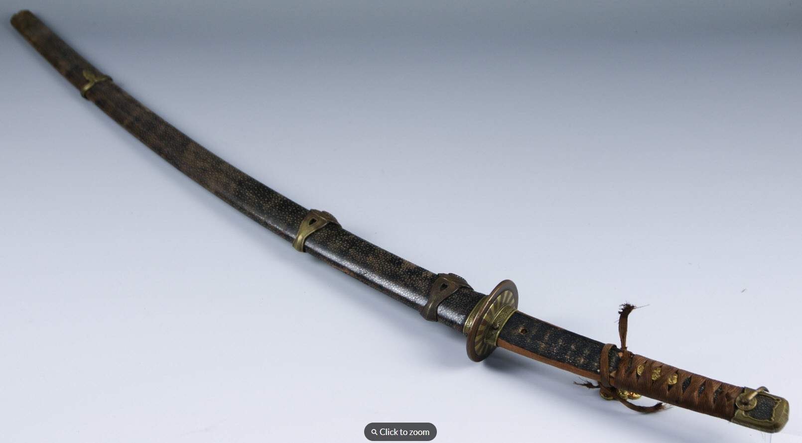

old state of the katana with the complete fittings on the saya (apart from the hangers)
lastest auction with the ito coming almost completely loose, and holding the menuki on the left side, the now missing menuki lying in the background
All depends on how good/what the actual blade is. A missing menuki can be replaced. A missing saya mount might be a bit trickier but not a deal breaker.
Bishu ju Yoshimitsu 備州住吉光
This is not the seki Yoshimitsu. Maybe another collector knows him.
the fittings looks nice. I like those rising sun seppa.
The Saya looks not broken in good condition. The Ashi heads with the rings are gone. Could be a problem to replace because they are rare.
The navy menuki is replacebale with some search. But i bet under 50 Dollar it is hard to find.
The saya rewraping cost around 150 EUR but you need a new black same too. The ito is mostly a problem to find a good one.

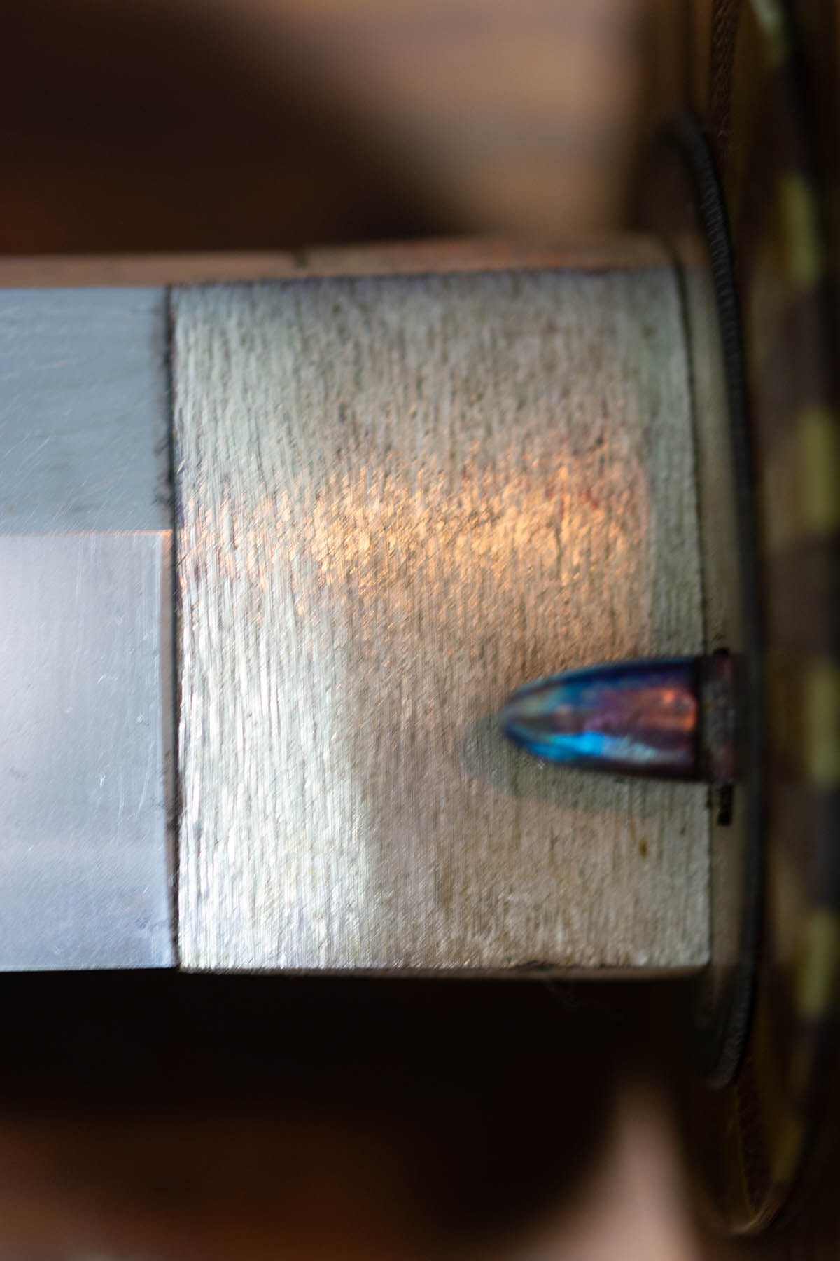

I can't say nothing about the blade. I see nothing on your pictures to judge if it is showato or gendai. I didn't find that smith in my books.
Why did you buy it? What was the trigger to jump in? If you like it - hold it and look further. But it cost money to bring it in a collectible condition.
Agree with John, this is not a Type 94. It is a Type 97 kaigunto, a Navy Sword.
Also agree with the others that this Kunto can be restored. You’re only in €850, for a sword that would normally sell for €1400-€2400.  Of course, if you don’t want, or have, the time to work on such a restoration, then you would be justified in returning it. But you got a good deal.

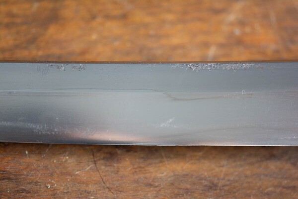

Thank you for your help! Im overwhelmed by all the response on my question!. The blade seems to be in original polish. the hamon is clearly visible along the whole edge of the blade.

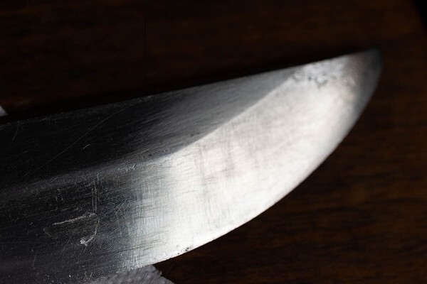

Which is strange is that the kissaki seems to be scratched with sandpaper. Might his have been a field sharpening or did this never happen?

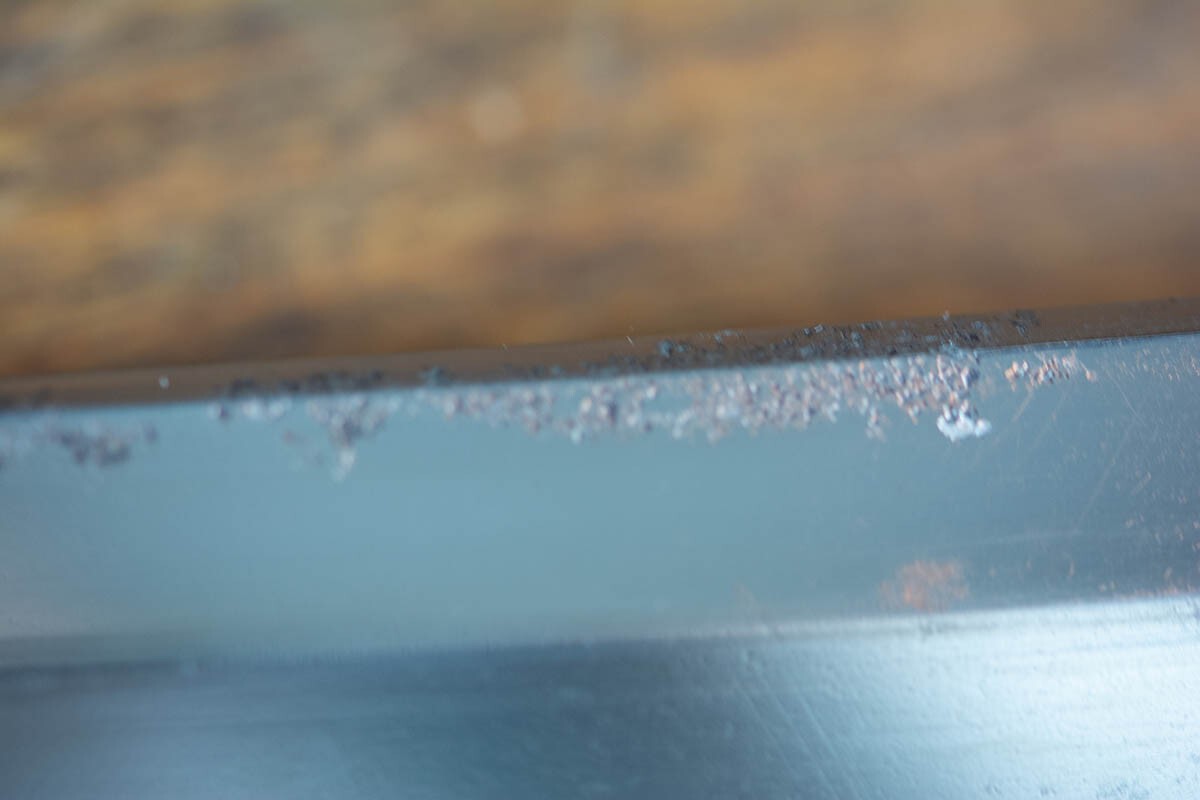

There is also pitting along the back of the blade, how do these impact the worth of the katana?

Thank you for the translation! There is no seki stamp so i wonder wo he was.
The hamon (which was very hard to photograph is very irregular with high peaks, might this indicate a gendaito? The first auction the katana sold at indicates it as a meji blade, they might be wrong though, i will call them and try to verify.
I also like the seppa, it was indicated as goldplated by the auction house it sold at (they are very thorough so might be correct.
Im happy to hear  the menuki is easy to replace, the current one also seems to be gold or goldplated as visible in the picture.
I saw someone is selling ashi on here so that would be perfect, the next question would be how i would get the current one of.
The ito is sold here ( pure silk) I would love the rewrapping myself , would that be possible with patience and clamping the blade? Seems like quite a work but doable.

If that is a silver habaki, they didn't tend to put those on junk blades. WWII menuki are easily replaceable.
i didnt even have time to take a good look at the blade when i brought it home, you seem to be right, seppa and menuki also seem to be goldplated and gold.

Thank you bruce, i must say im a bit shocked i got this got of a deal, i was feeling bummed about the missing Would that price still be viable with the condition of the kissaki and the pitting on the back of the blade?
I do have the time to restore it, its mostly a question of wanting, although polshing is a very zen experience.

It looks gendai. In your last picture is nice activity seen and no dark shadow and spots. Try to make pictures with sunlight. Are there some ara nie?
Could be mixed steel too  We should find out more about the smith.
It looked gendai to me to
ive been jumping around the house here for a bit after i contacted the auction house this katana sold trough years ago.
they told me the original descprition.
Its made by Yoshimitsu of the Yanagawa clan, a meiji smith.
I contemplated returning it yesterday before ive even read all the responses here.
the blade is def. staying now.
