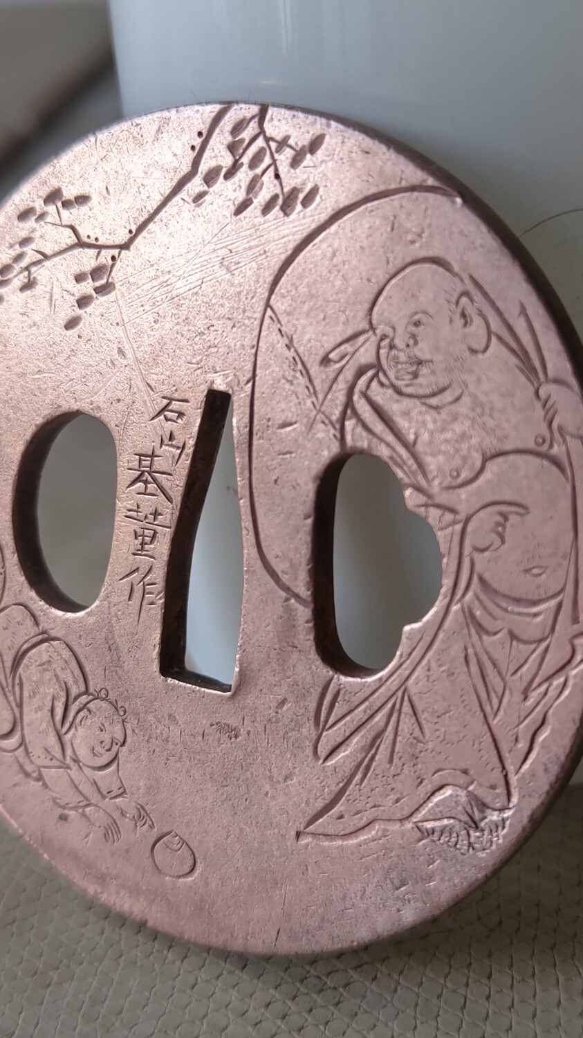

Recently I have purchased this tsuba, as you can see in poor state, bought it specifically to try cleaning.
PSX_20230811_114639.thumb.jpg.2913b868350ef0e641d467f908efe1fa.jpgPSX_20230811_114622.thumb.jpg.4530237d8cce346f5f855fb69fbfd406.jpg
Signed, I believe Ishiyama Mototada ( I might be wrong, so any correction is very welcome)
Depicting Hotei

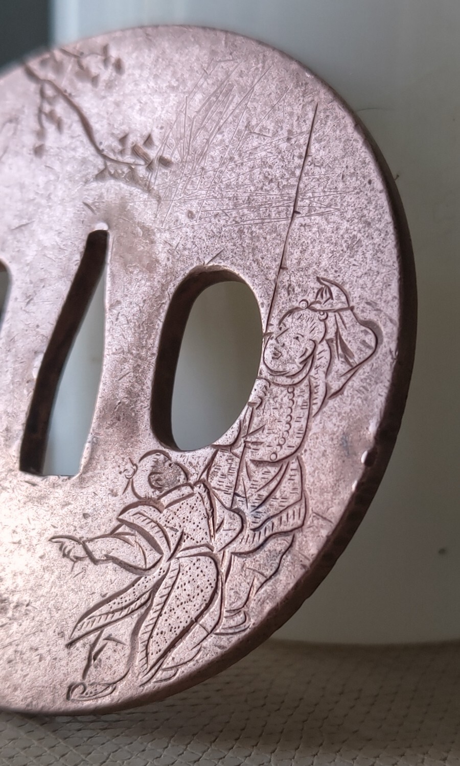

Here is what I get after not too invasive cleaning
PSX_20230811_113956.thumb.jpg.5663e119ff1b414429cdf9f45ac4a60f.jpgPSX_20230811_114007.thumb.jpg.4db72a31ecc550d459c85f02b16fa8de.jpg
I tried to preserve all signs of wear and mounting.
What do you think?

Hi Vitaly
Given the poor condition of the piece when you received it you've not stepped wrong, yet :thumbsup:
My first observation, and surprise bonus for you, is that while the core of your tsuba is copper the outer faces are in fact shakudo. The trace of black patina before cleaning is a good clue but if you examine the inside of the kozuka hitsu in the first image the sandwich construction is clear.
Judging from the present surface colour and condition I'm assuming you used a mild pickle of tarnish removing solution to clean off the old discolouration.
This surface will not repatinate as it is, either naturally or in a traditional patination solution. This is because there is now a fine deposit of dissolved copper oxides bound to the crystal structure of the shakudo. But as the surface is somewhat pitted and scratched a light re-polish would really be called for and would resolve those issues and allow for the original patina appearance to be re-developed. If you do proceed don't use any synthetic abrasives as the finish will be too bright and wont allow for the patina to grow properly. I'd suggest a fine black nagura stone or, if you can find one, water of ayr stone, followed by magnolia charcoal. To finish up in this case I'd use a very fine pumice powder and water paste gently used with a soft or worn toothbrush. The next step would be actual patination but that's a whole other cooking class if you really want to get it spot on.
Btw, don't be tempted to use emery paper of the like as that will only soften the edges of the kata-kiri and completely kill the whole effect.
I wouldn't pay too much attention to the mei, whoever cut it could barely use the chisel :freak:.  Having said that the tsuba was decently constructed and the kata-kiri, while not exactly a masterpiece, is a fair enough example of late work.

Ford - do you mean to say this is a gimei of Motoyama Ishitada???  Bob Morrison showed a tsuba No 267 of a similar construction with NBTHK paper and in katakiri:
> Having said that the tsuba was decently constructed and the kata-kiri, while not exactly a masterpiece, is a fair enough example of late work. ,
Vitaly, if your tsuba is a genuine work by Motoyama Ishitada I strongly, STRONGLY suggest you let Ford restore it.  I have a tsuba by this artisan and the style of signature with ISHIYAMA in small characters and MOTOTADA in 'normal' size characters point to a genuine, high quality work unless 'someone' says it is gimei.  I honestly think that a gimei tsuba is hardly likely to be a sandwich construction of high quality shakudo facing pieces.  I have compared the two signatures in side-by-side windows and even the mei on Bob's tsuba looks a tad clunky to my eye.  Is there an expert in the house???  More below.
This may well be gimei, but in this thread Stenbar asked
Ford wrote:
Posted August 14, 2008
To add to the picture of who the man was... the following is from Haynes; with some added speculation on my part. :idea:
Mototada was also a painter, something which may have added to his design abilities. He was schooled in metalwork by the Kyoto branch of the Goto family and other Kyoto studios. I get the impression of someone somewhat outside of the mainline school system therefore. He inherited his father rank of 3rd level court noble ( Kuge ), perhaps this allowed him a certain freedom in moving between schools etc.
This type of bold and sweeping kata-kiri work is more likely influenced by the Yokoya lineage, Somin being credited with the invention of the technique. Many other artists used the technique subsequently but this does have a strong Somin look to my eye.
Some clearer, and larger images would allow for a better assessment of the quality of the work but it seems to me to reasonably good, as one would expect.
Regards, Ford
So maybe Vitaly's tsuba needs a closer look????
There is one more tsuba offered by Kyle Shuttleworth that has a similar 'clunky' looking mei - is this a characteristic of Mototada's mei???  Its the third tsuba down.
BaZZa.
PS: Edited to add that I would put up a photo of my MOTOTADA tsuba but I don't have a photo readily available.  Furthermore, it is iron and in a completely different material and style, though of course the mei could stand scrutiny.  I'll try and get this together.
  • Like 4
  • Thanks 2
Hi Bazza
I wouldn't have said gimei as such, more likely Ato-mei (the mei added much later ). And yes, Mototada's mei do tend to look a little 'stiff' and clunky the ends of his strokes never the less still exhibit an understanding of the correct brushwork stroke. I dont get a sense of that in this example, it feel a bit too contrived to me. But that's just my opinion.
As regards the sandwich construction, shakudo was a pricy material, but labour to perform basic workshop tasks on the other hand was not. Would a celebrated artist be using veneered material to save costs?

Steve, I think Ford made his observations from the first two photos. The colour in the two Ana is that of pure copper. After a while, you come to recognize certain alloy colours you work a lot with. Shakudo has a fair bit of gold, (37.6% in Ford's recipe), so it's not very economical to make a tsuba out of pure shakudo. Then, only certain other alloys, like pure copper or shibuichi won't interfere with the patination process. Pure copper can also have a range of colours with patination from brown to orange, up to a bright red. So it might have actually also been a conscious choice as an accent colour in the tsuba's ana.
Cool, and yes, no real disagreement here. I think what is throwing me off, is the lack of "construction line". In a couple of places it does appear a possibility, but in other views, I'd swear it is solid. Should there be more definitive lines/joints? Is there a possibility that these are effectively masked somehow, or just a product of photo quality?
Not trying to cause issues, I'm just trying to get to grips with my own knowledge, as well as build on my "photo vs in-hand" appraisals.
Steve: On the first two photos, you can see a construction line, which is the change in patina close to the top of the ana. The shakudo layer is quite thin, something like 1mm.
