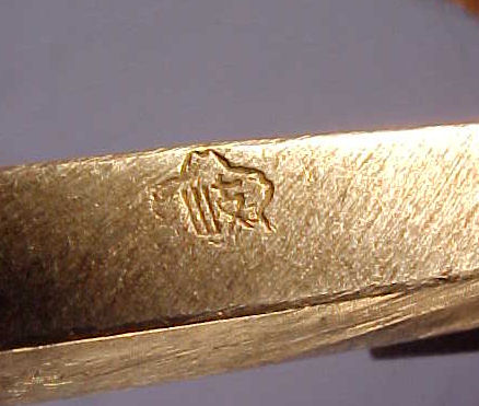

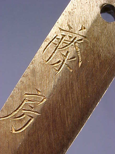

Stephen Posted August 8, 2009 Report Posted August 8, 2009 Hi George Was wondering if you or other members has anything on this smith. has gifu stamp in two places. Quote
george trotter Posted August 9, 2009 Author Report Posted August 9, 2009 Hi Stephen, Wow, you have come up with a hard one here. It is difficult to know how to read this...Fujifusa or Tobo. I think probably Fujifusa...but who is he you ask? Well, you don't show the blade , date or fittings here, but I would say that because of the two stamps you mention, this is likely a Type 3 gunto koshirae. If so, this would fit with a Seki Tosho named Yoshida Fujikazu. This smith started as tosho on 30 April 1944 so it is likely his blades would turn up in Type 3 mounts (1943). He is listed in the Seki Tosho list supplied by Jinsoo Kim sensei, and while the list clearly shows the same kanji as your sword, his name is given Katsufusa...but the first kanji on your sword and the Seki list is definitely Fuji. So...to answer your question, Fujifusa is a late war Seki tosho...I would be interested in some feedback from you...his mei is nicely cut...what is the blade like...gendaito? and date? Hope this helps...or am I completely wrong...? Regards, George. Quote
Stephen Posted August 9, 2009 Report Posted August 9, 2009 Thanks George I at first thought it was a odd Katsufusa but like you said and Nobody agreed its Fujifusa. Ill send you the rest of the pix for what there is to save space in a email. Thanks again. Quote
