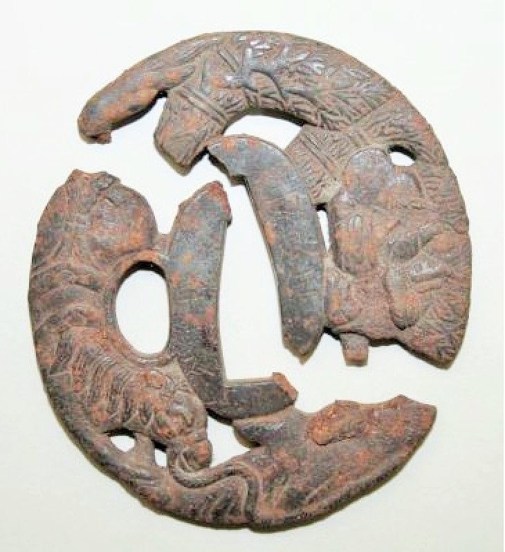

Dan tsuba Posted February 11, 2023 Report Posted February 11, 2023 Hello all! I refer you to the thread titled- “Papered(?) iron tsuba….help! Matsunoki By Matsunoki Thursday at 09:24 AM in Tosogu” So, I put 2 and 2 together and came up with 4 (or maybe 5!). Ha, ha, ha, ha, etc! When I re-read the above mentioned thread, I noticed that one member thought the iron tsuba looked like a cast iron tsuba. Another member tended to agree with that opinion. These statements are my summation of what was stated, and I could very well be wrong (to find out exactly what was stated, I refer you to the above thread). Also, another member thought the tsuba could be dated from the late 1700’s to the early 1800’s. Now what does that all mean? Could it show that some members are now of the opinion that cast iron tsuba were made during the Edo period? It has been my experience that the study of tsuba is not an “exact science”. There are many “variables” that are left up to the interpretation of the individual doing the research. As many of you know (from my “Tsuba Casting Molds?” thread), the idea that iron tsuba could have been cast in the Edo period has always intrigued (fascinated?) me. I am still researching and always trying to find new “evidence” in support of this “Edo period cast iron tsuba” hypothesis (theory?). I think the above-mentioned opinions by various members of the forum are very interesting! Thank you all! And the research and adventure continues! With respect, Dan 2 1 Quote
Steves87 Posted February 12, 2023 Report Posted February 12, 2023 Hi Dan, I must assume that one of those opinions you refer to in the other thread, are mine. I just want to go on record saying I don't necessarily think that particular guard was cast (with post added embellishments), but I do agree that it is possible, and that it definitely did happen. I think that we would see a lot more of that exact design if it were cast, just like the grazing horse theme I mentioned, those horse guards are all basically identical. Quote
Dan tsuba Posted February 13, 2023 Author Report Posted February 13, 2023 Stephen, Thank you so much for your thoughts! Like I stated before, the subject of cast iron tsuba being made in the Edo period has always intrigued me! With respect, Dan Quote

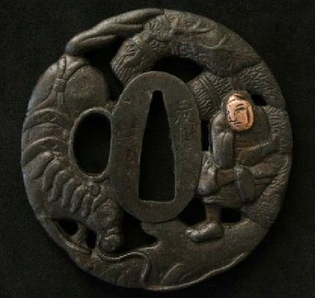

Spartancrest Posted February 14, 2023 Report Posted February 14, 2023 I wonder if this is cast? A very very rare example with an actual face! This guy is taking a smoko break. https://en.wikipedia.org/wiki/Smoko Inlaid [glued on] face intact - super rare! and back to more 'faceless' examples. 1 1 1 Quote
ROKUJURO Posted February 14, 2023 Report Posted February 14, 2023 18 minutes ago, Spartancrest said: I wonder if this is cast? ..... Yes, cast away, as it deserves! 1 1 2 Quote
Dan tsuba Posted February 15, 2023 Author Report Posted February 15, 2023 Hello all, So, in the previous thread mentioned (in one of my posts) on this thread; Stephen stated (and thanks Stephen – it started a whole new line of inquiry for me!)- “….there are quite a few Soten/Hikone Tsuba that were done this way. Quite often one will pop up for auction that is just the base casting - no added inlay/zogan, they are mostly complete, just missing the alternate metal faces. A typical example of this is the soten grazing horse theme.” Then Dale (also, thank you Dale) posted pictures of this "grazing horse" themed tsuba. The first picture he posted of the broken tsuba (great picture – by the way!) verifies (at least to me!) that these “grazing horse" themed tsuba were cast iron (also, that particular tsuba has a “missing face”). Then Dale posts other pictures of the same “grazing horse” tsuba that are also “incomplete”. They are missing the “glued on(?)” faces. These tsuba also appear to have “some age” to them. So, what is up with that? This tsuba design was obviously very popular. Did the alternate type of metal faces fall off of these cast iron tsuba over time? Or are these actually tsuba that were not completed? If they were not completed, what was the reason why? Personally, my opinion is that the "alternate metal" face of the motif of a person on these cast iron tsuba just fell off over time. They didn’t use a very good glue! Thoughts, opinions?? The research continues! With respect, Dan 1 Quote
Steves87 Posted February 16, 2023 Report Posted February 16, 2023 Well, it could go either way in my opinion. I would vote for unfinished - 60 to 40. Why? Because of the lack of nunome, and ten zogan. That stuff doesn't just "fall off" unless it has had time induced impact forces, or, rust from below lifting it. I have seen Kinko guards of this same theme with the faces missing, but ten zogan still embedded Quote

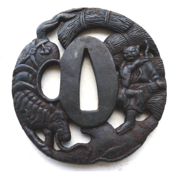

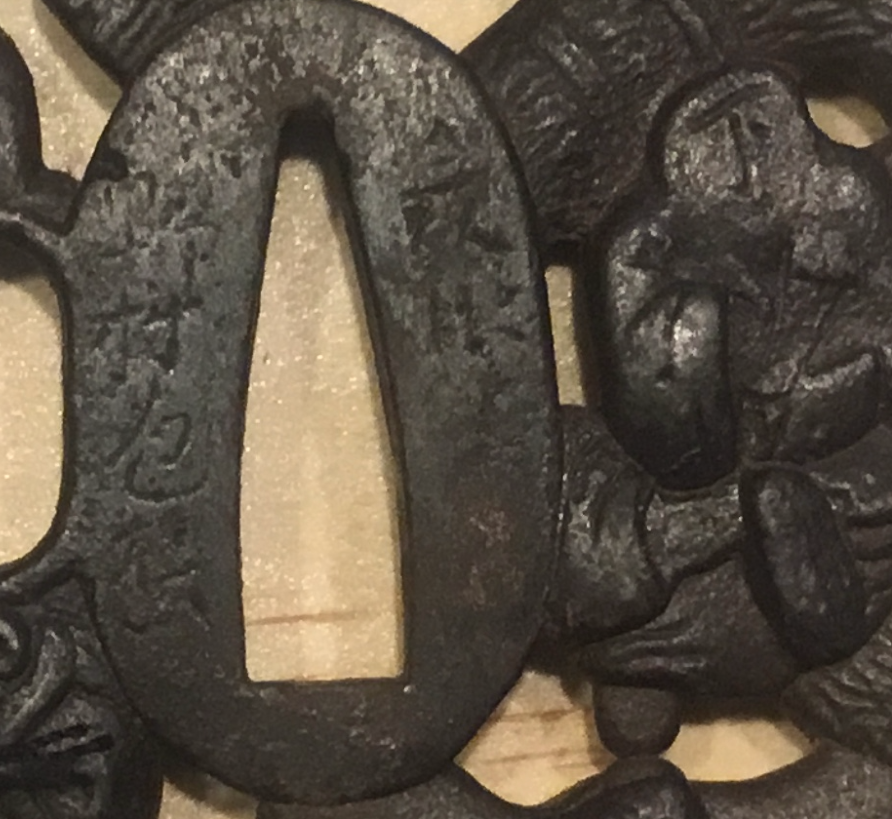

Dan tsuba Posted February 18, 2023 Author Report Posted February 18, 2023 Hello all! So, I found another “grazing horse theme” tsuba. This particular cast iron tsuba motif is relatively easy to find! How many of these were made! Again, the tsuba pictured has no “alternate metal face” on the person. It does seem like the mei has been engraved and not cast with the tsuba. Are all the mei the same on all the “grazing horse theme” tsuba pictured? They all appear somewhat different to me (maybe because some parts of the mei are “worn” off). Are the mei original or “gimei”? Who would (evidently) cast so many tsuba, not finish them, and engrave (?) a mei??? Were they cast in the Edo period (or is that something we may really never be able to determine)? What is up with these tsuba? With respect, Dan Quote
Grevedk Posted February 18, 2023 Report Posted February 18, 2023 Good evening Dan, 16 minutes ago, Dan tsuba said: Hello all! So, I found another “grazing horse theme” tsuba. This particular cast iron tsuba motif is relatively easy to find! How many of these were made! Again, the tsuba pictured has no “alternate metal face” on the person. It does seem like the mei has been engraved and not cast with the tsuba. Are all the mei the same on all the “grazing horse theme” tsuba pictured? They all appear somewhat different to me (maybe because some parts of the mei are “worn” off). Are the mei original or “gimei”? Who would (evidently) cast so many tsuba, not finish them, and engrave (?) a mei??? Were they cast in the Edo period (or is that something we may really never be able to determine)? What is up with these tsuba? With respect, Dan Again citing: “Tsuba in the Cleveland Museum of Art” revised and edited by D. Raisbeck (leading scholar into the world of Tsuba 😎👍), and showing my own feeble attempt to take a picture in poor light: I think that the stated conclusion is very close to a possible truth. @Spartancrest All the best Soren 1 Quote

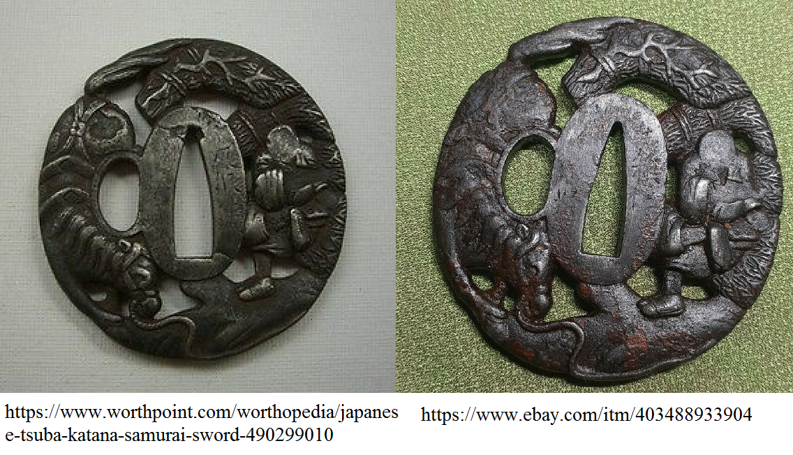

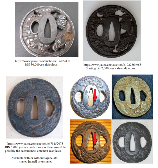

Spartancrest Posted February 19, 2023 Report Posted February 19, 2023 Still 'horsing around'. You can add these to what to avoid as far as cast horse theme 'tsuba' [if you can call them that?] Where are the scrap iron dealers when we need them! 1 1 Quote

Steves87 Posted February 20, 2023 Report Posted February 20, 2023 On 2/19/2023 at 5:09 AM, Dan tsuba said: Who would (evidently) cast so many tsuba, not finish them, and engrave (?) a mei??? Good point Dan, perhaps the ones which have a mei (some don't), are the ones where the decoration has fallen off? maybe I should change it to 40 - 60? Quote
Spartancrest Posted February 20, 2023 Report Posted February 20, 2023 2 hours ago, Steves87 said: Who would (evidently) cast so many tsuba, not finish them, and engrave (?) a mei??? The quote originally from Dan. What if the production procedure involved cutting in the mei first, then applying the faces? The process of cutting or engraving the signatures would add extra stresses to the bad 'inlay' [or glue] so it could have resulted in construction in an out of sequence fashion - on a good quality piece you expect the signing to be done last, why sign something if it ended up being badly made? But intentionally making a fake with little quality control, you get the saleable elements done first [signature] then the pretty bits get added. The manufacturer doesn't care if the pretty bits fall off latter, you have already paid him for the signature. This partly contradicts what I said in the Cleveland book- but all things are open to speculation and we really don't know the manufacturing procedures fully. One as yet unsolved mystery is why if these fakes were made as export ware [what else could they be made for?] - why are they still coming out of Japan a hundred years or more from when they were being made? Did a few hundred thousand not make it to the wharf and were sent back to storage? 2 Quote
Steves87 Posted February 20, 2023 Report Posted February 20, 2023 A great thought there Dale, very plausible. Also, adding a sequence to a process can lead to efficiency, in this case they were so efficient, that it looks like a couple thousand got made! 1 Quote

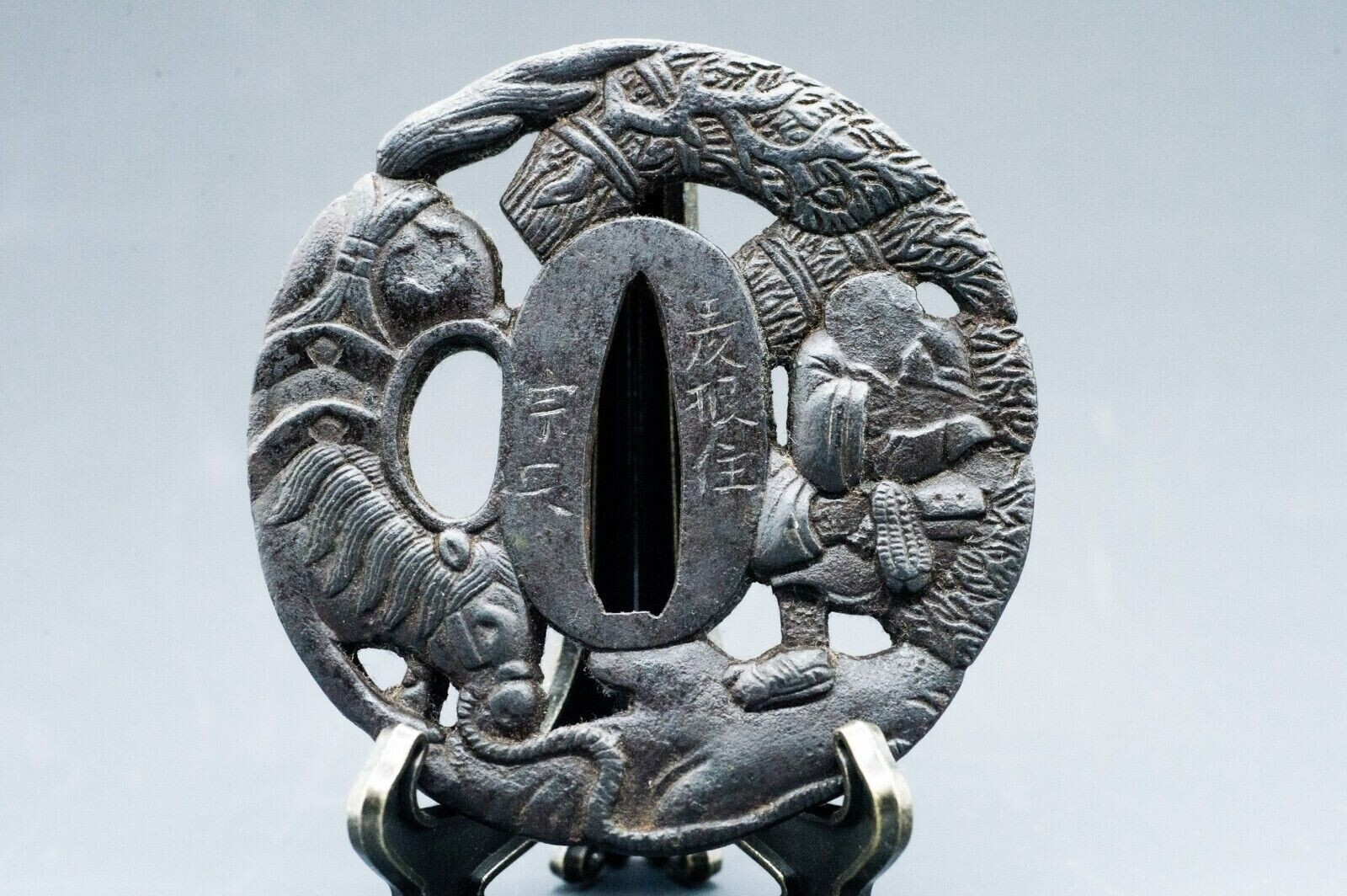

dir Posted June 12 Report Posted June 12 I know I'm late to this topic, but I have just acquired from my friendly dealer here in NL some tsuba he has just received from his main old-time dealer in Japan. One is the faceless character with his horse and cuttings. I can't quite make out the signature, so don't know whether it is from Hikone ju Soten or not. I see that several of these tsuba have slightly different details in the bundles and my example seems rather worn. Weight is 107gr, H is 7cm, W is 6.7cm and thickness is 6mm. I wondered if that is a character on his face or whether it is supposed to be an eye, brow and nose?! Quote
Spartancrest Posted June 12 Report Posted June 12 These five other examples don't show any marks on the blank faces - perhaps the cuts were made as a "key" to re-attach the face - which once again failed? Your example is the only one I have seen with that feature. I wouldn't worry about the signature too much they tended to vary a lot and are all gimei anyway. You are correct that there are several variation in design I have found one with an iron face - integral or added I don't know. 2 1 Quote
