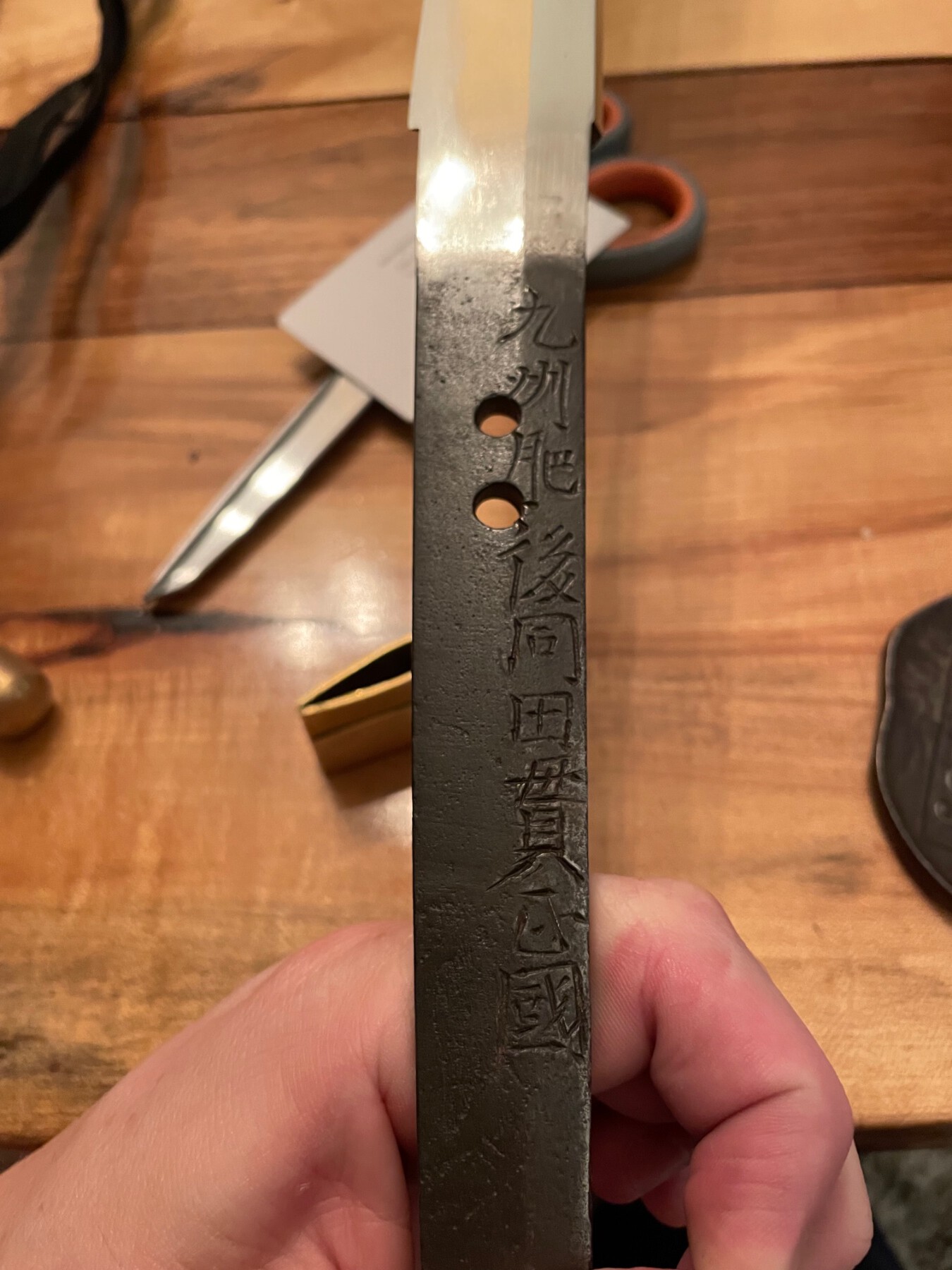

Katsujinken Posted December 29, 2022 Report Posted December 29, 2022 Hi folks, I believe the mei on the blade is Dotanuki Masakuni, but I would appreciate a full transliteration (and correction if needed). The nakago on the blade may even be aged / falsely patinated! Quote

mecox Posted December 29, 2022 Report Posted December 29, 2022 Michael, 九州肥後同田貫正国 looks like Kyushu Higo Dotanuki Masakuni, but with some rather rough cutting 1 Quote
Katsujinken Posted December 29, 2022 Author Report Posted December 29, 2022 Okay that’s what I thought. And yes, “rough” cutting for the signature is putting it lightly! It’s a good sword though. Will have a good life in the dojo. Quote
