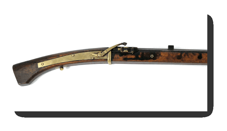

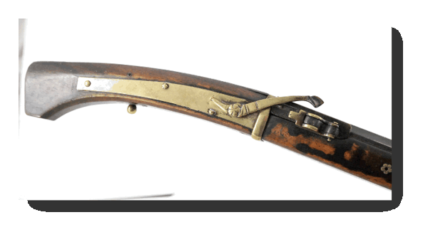

How to care for a teppo. Should I oil the parts for longer durability or should I leave it where it is.
Want answers on how to take care of a old Japanese teppo.
// Robert

Solid-looking matchlocks, Robert. The first sports some Tabuse-school features and the other one Inoue-school.
When it comes to preserving the stock, I use Renaissance Wax for every matchlock in my collection. It gives the stock a pleasant shine and brings out the woodgrain in a nice way.
Plus, you only need to use this wax one time.
I put some wax on my fingertips and make sure to coat the stock. You only need to apply a thin layer. Then I wait a few minutes so the wax dry properly. As a finishing touch I use a piece of clean cloth with which I polish the stock. The harder you polish the more shine you get.
I live in a modern house with central heating. The wax seems to protect the stocks from cracks, so no need to use oil.
Good luck!
