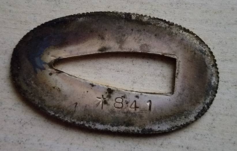

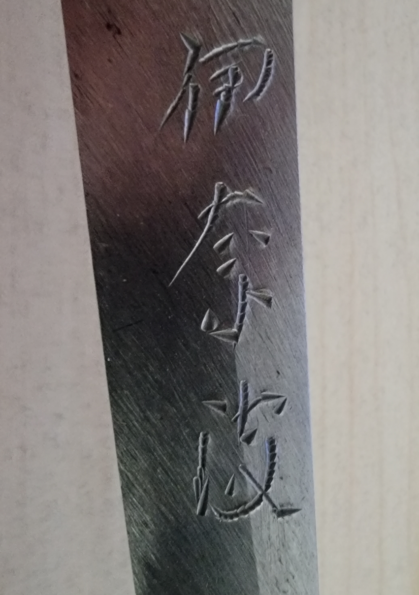

Will_S Posted September 7, 2021 Report Posted September 7, 2021 Hello! I posted about this sword on another website and it was recommended to post here. I've been told that it is a Toyokawa Naval Arsenal sword per the anchor mark and that it's from Inaba. Could anyone confirm that, and possibly assist with translating any additional information? https://imgur.com/a/bztfFr9 Quote
PNSSHOGUN Posted September 7, 2021 Report Posted September 7, 2021 Hi Will, the information is correct but Inaba is the swordsmith, not the location. The sword pattern is 1937 Kai Gunto. If you search Inaba along with "Kai Gunto" or "navy sword" on the forums there will be plenty of information. Quote
Bruce Pennington Posted September 7, 2021 Report Posted September 7, 2021 Posting photos for posterity. Will, Your kai is interesting for a couple of reasons. It's got a custom saya, can't tell from the out-of-focus pic, but likely ray skin. So the owner paid extra for that. Also the stamps on the seppa and tsuba are an unknown maker. There is a kanji like that, but these are backward, or mirror of how it is written. So, we don't know who made them. By the lacquered material under the wrap (maybe fabric?), I'd put this in the last couple of years of the war. Lacquered rayskin was the norm for these, but in the last year, the military changes their mil specs to discourage the use of skins and move to artificial materials. 1 Quote

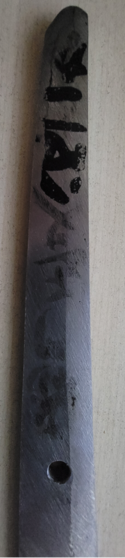

Bruce Pennington Posted September 7, 2021 Report Posted September 7, 2021 Will, Are there any numbers stamped on the nakago (tang)? The other one like this I have on files has numbers. Quote
mecox Posted September 7, 2021 Report Posted September 7, 2021 Yes it is Inaba, see Naval Swords NMB Downloads page 90 + 1 Quote
Kiipu Posted September 7, 2021 Report Posted September 7, 2021 Looking at the pictures I have of the anchor stamp, I noticed that there are two sizes. One is large and the other is small. Yours is the small one. Can you measure the outside diameter in millimeters for me? The subassembly number is オ841. The prefix is the katakana character O. Quote
Will_S Posted September 8, 2021 Author Report Posted September 8, 2021 10 hours ago, Bruce Pennington said: Will, Are there any numbers stamped on the nakago (tang)? The other one like this I have on files has numbers. Thank you very much for your help with my sword! I took an additional picture of the other side of the tang for you, though I'm not sure if will be helpful. 8 hours ago, Kiipu said: Looking at the pictures I have of the anchor stamp, I noticed that there are two sizes. One is large and the other is small. Yours is the small one. Can you measure the outside diameter in millimeters for me? The subassembly number is オ841. The prefix is the katakana character O. Hello Kiipu, thank you for your assistance! The diameter of the circle around the anchor is roughly 4 millimeters. 1 Quote
