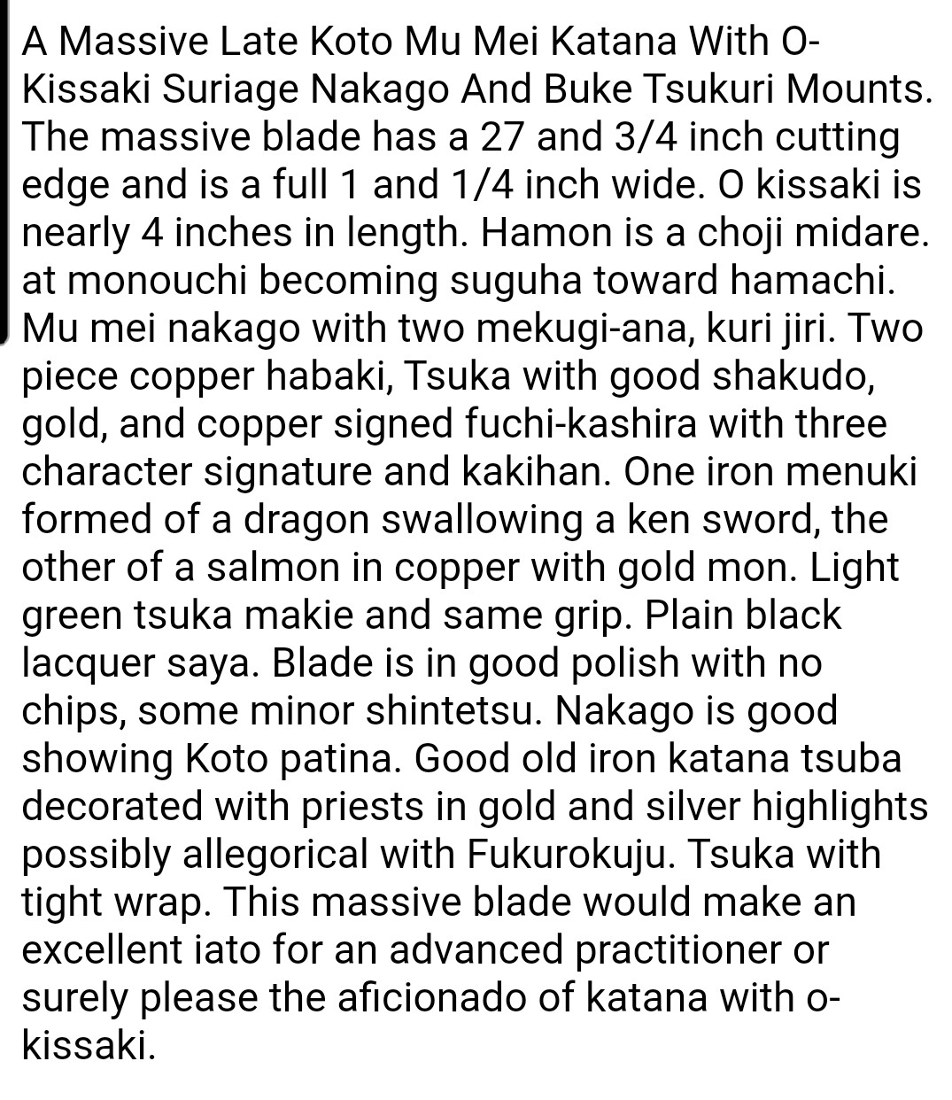

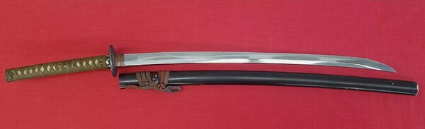

Im posting an example blade that I think is really a cool sword.  I've watched it for many months and it still hasn't sold so its either priced too high or the shintetsu is just too heinous for the blade to be adored by a wisened collector.  Wondering on your thoughts towards this specific flaw.  Also a more expert eye to help me gauge the level of shintetsu on this blade and if it would be considered lots or not so lots =|:^)

The resale/market value part and also the scale of shintetsu im still not too sure of.  Like in that example blade, is the amount of shintetsu visible there considered a lot or a little?  Or is that also kind of subjective?   Markets are usually subjective with an underpinning of objective, so I can either see it being a powerful negative or an acceptable flaw.  But in general I would assume it would detract from value in the majority of cases unless historically protected by known maker/school...and to what degree/significance...totaaaally depends.

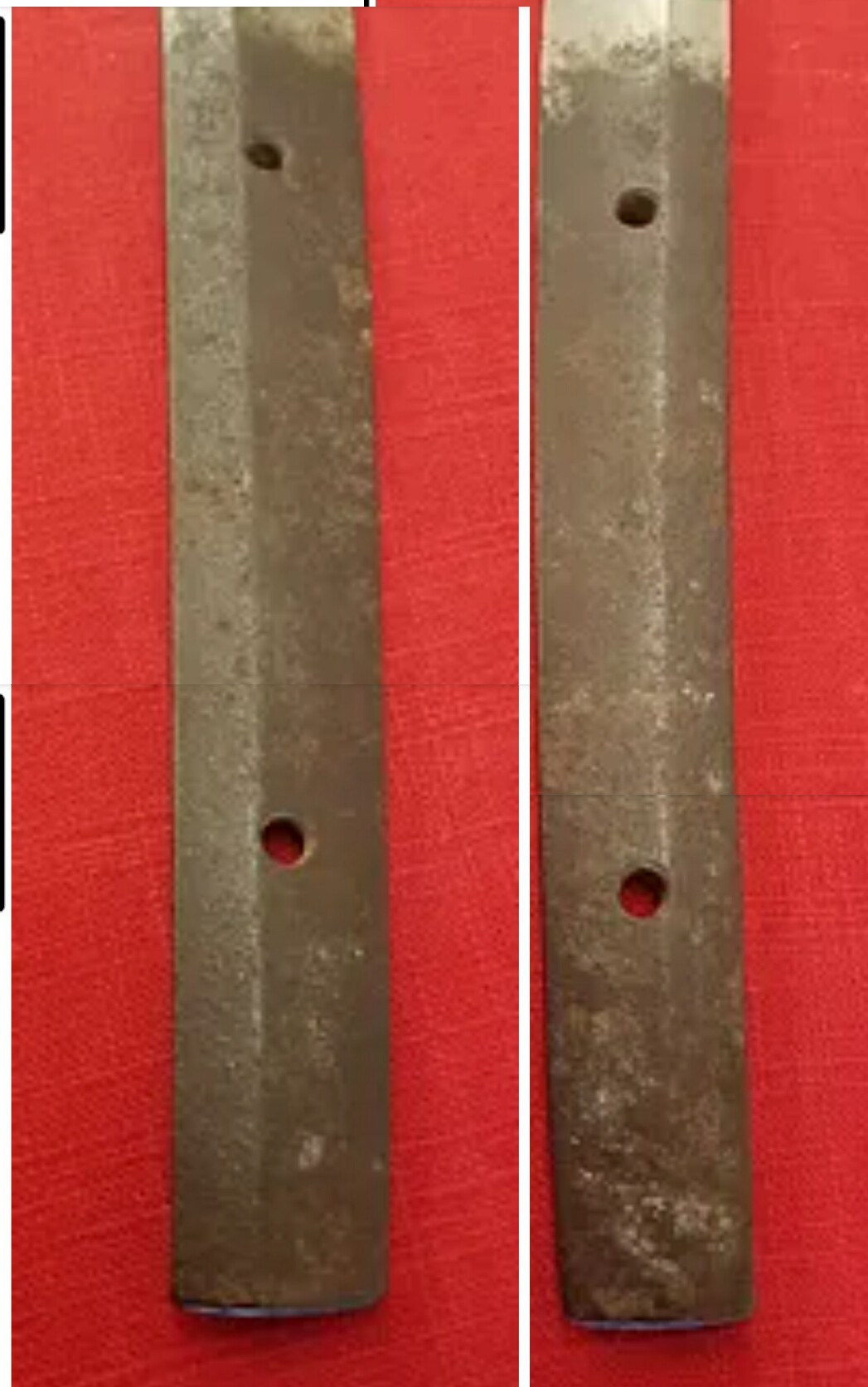

The photos – and probably the state of polish – of the sword in question make it very difficult to see if it has jizukare or not; what I see, however, are numerous kitae-ware. Pictures of the nakago would be helpful, but my impression is that we’re looking at a shin-shintō. The nice sugata (insider joke alert!) can’t make up for  the poor workmanship, and (from what I see) cobbled together koshirae. I don’t consider it collectable, but even if someone just wants to own a Japanese sword – any Japanese sword – the price is way too high.

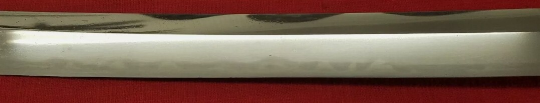

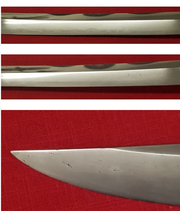

So the spots in the example o-kissaki sword are also a mixture of kitae-ware rather than all jizukare (thanks Guido for teaching me this term)  and exposed shingane due to over polishing.  For some reason I always had the image of kitae-ware being larger and the obvious fact they can come in smaller pockets didn't click when I saw it.
  I made some pics of the tang (which do look older to me) but I needed to photoshop them to make a single image.  I couldnt download the pics and the images were too big to screenshot the entire tang so had to do it in pieces.  Those pics are below.
I think alot of it is also Jizukare 地疲れ. with small kitae-wares.  I don't really see any hada but that could be photo quality but the o-kissaki photo is pretty clear and it seems featureless.

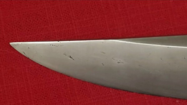

I don't see any evidence of Jizukare in the photos provided.
There are kitae-ware which have exposed the core steel but that's a different thing entirely and not due to over polishing.
In fact, judging by this kitae-ware on the kissaki and how deep it goes before reaching the core, there should be plenty of skin steel left on this blade.
In fairness Ben I can't see any evidence of very much in the ji regarding the condition of hada, whether showing core steel or not.
I am not sure I share your optimism about the ware not being deep enough to hit core steel, but again it is something very difficult to judge from the images.
Hi Ben
I can see what you mean. My concern (and BTW I am a major pessimist) is that by the time you polished down to remove the pitting core would be exposed. Unfortunately there is no way of knowing without doing it.
