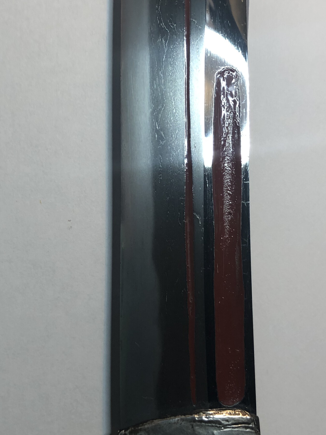

Caracal Posted October 6, 2020 Report Posted October 6, 2020 Hello I need help with a blacksmith's name on one Naginata blade. The name is short so I wonder what it could be Grateful for any answers // Robert Quote
Shugyosha Posted October 6, 2020 Report Posted October 6, 2020 Hi Robert, Looks like Kunishige. 1 Quote

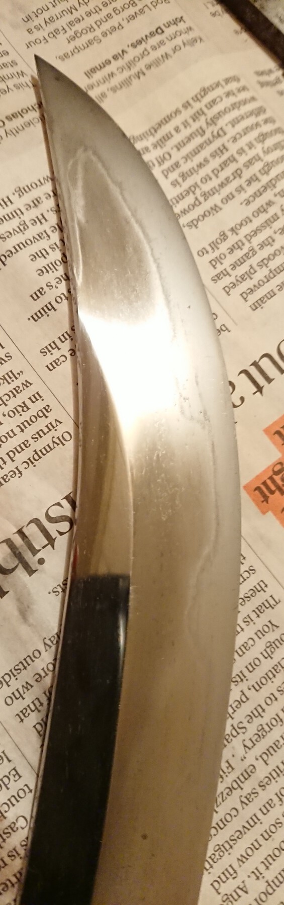

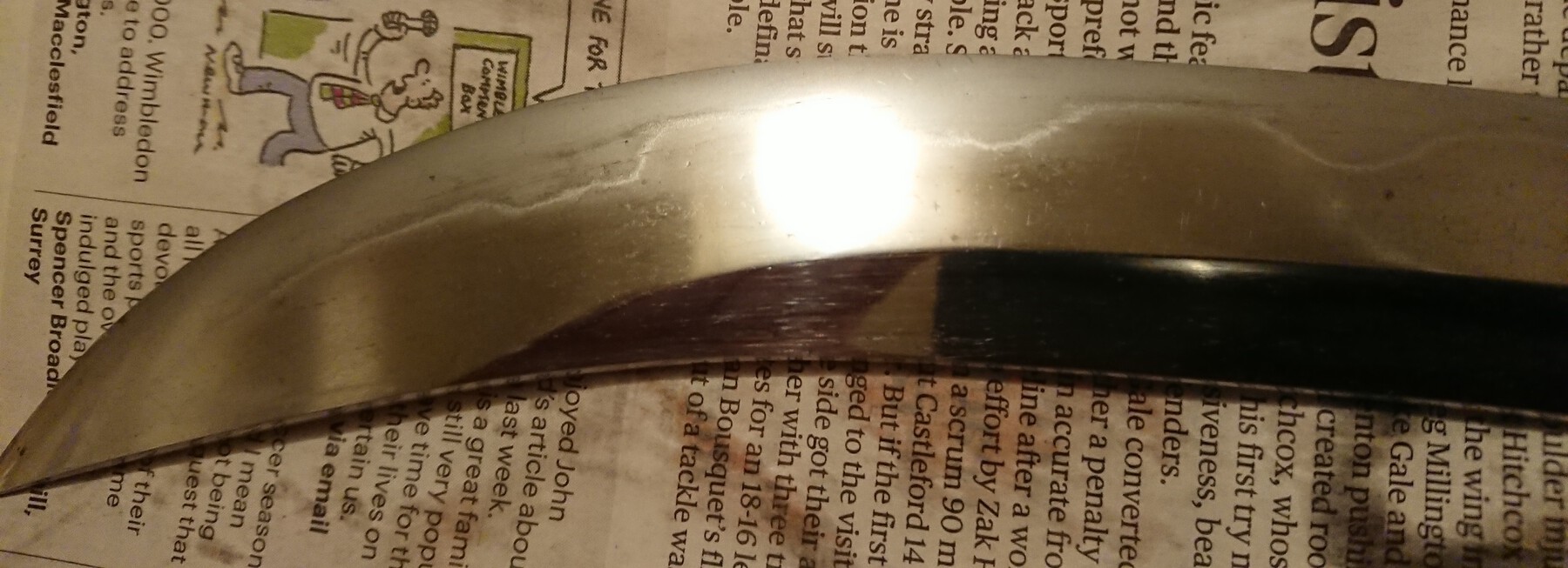

Caracal Posted October 7, 2020 Author Report Posted October 7, 2020 Yes I think maybe it's a Naginata from Shinto era made for women and with a shorter lighter blade. Thanks for the pictures John. Here is some photos for you Adam. What can you see from the pictures? //Robert Quote
Babu Posted October 7, 2020 Report Posted October 7, 2020 Very similar to one I had recently which was Mino. Very much designed for a lady to use. Light and very similar shape. These would be very difficult to reshape into naginata Naoshi as they are relatively short and the turn back is steep. Quote

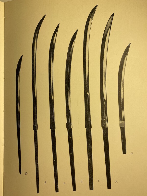

Shugyosha Posted October 8, 2020 Report Posted October 8, 2020 Hi Robert, Here's a couple of pages from Roald Knutsen's book, Japanese Polearms, that give examples from different time periods: 1 Quote
Babu Posted October 8, 2020 Report Posted October 8, 2020 The shape of these later naginata are not represented in that nice reference John. The turn back is wide and pronounced. I can see all of those making a nice sugata for naginata naoshi but not these much later ones. The one I had was in koshirae of approx 6ft 6 inch pole. With the blade on, this was another 18inch to 8 ft in total. The Nakago was longer than the blade as mine was ubu. Found a slightly better image Quote
Caracal Posted October 8, 2020 Author Report Posted October 8, 2020 Conclusion: I think my Naginata is a Naginata made for women during the latter part of the Edo period. It is small 15 inches, the weight is light and flexible. Thanks to our discussion, I have received a lot of help. I still wonder how to get hold of the blacksmith Kunishige as only the name is on nakago with only two characters. The smiths that the sword smith index shows are swordsmiths but there is nothing to say that they made Naginatas. Maybe I should be happy with the info I received ........ // Robert Quote
Shugyosha Posted October 8, 2020 Report Posted October 8, 2020 And the blade - nothing not to like there. Quote

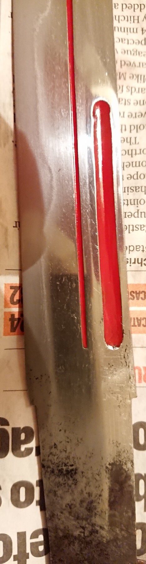

SteveM Posted October 8, 2020 Report Posted October 8, 2020 Possible to take a couple more photos of the mei at another angle? Quote
Caracal Posted October 9, 2020 Author Report Posted October 9, 2020 Hi Steve, Here are some pictures of mei. A little difficult to get a good photo as the signing is not so good. Hope you can see something so I get an explanation of what a blacksmith it could be. It's close to what it looks like to be Kunishige? //Robert Quote
Jussi Ekholm Posted October 9, 2020 Report Posted October 9, 2020 Can you post some measurements of it lenght & nakago length and full sized picture of blade & nakago. I can write better reply next week when I am back home and have all my sources at home. I do think calling Shintō period naginata in general as "womens weapons" might be just association that is not totally accurate. Also while Knutsen has lots and lots of good information on his book, some like the above posted diagram on proportions are bit skewed. I do understand that he used examples of his own collection for it but in general it does not show early naginata like they should be featured. 4 Quote
