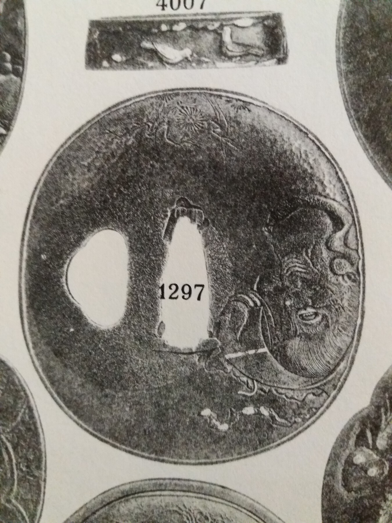

Japanese tsuba artisans surely mastered their skills at an unbelievable level, so no surprise they were able to reproduce in small series wonderful pieces. So I've paid attention to make confrontation just between yose-tagane and sekigane that are supposed to be adaptations to a specific sword tang. My conclusions are that the tsuba reproduced in the booklet and the one in the Naunton collection catalog are the very same tsuba. Well, alternative explanation is far less favourable...
👏👏👏Thank you so much Mauro ! I interpreted Naunton collection description as "Signed by Joi" when it was just mentioned "Joi school" and I didn't even try to think that it was the same tsuba.... So now I have a double reference for my tsuba and you brought more value to it... Thank you again !
