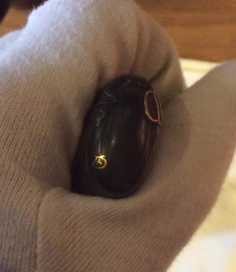

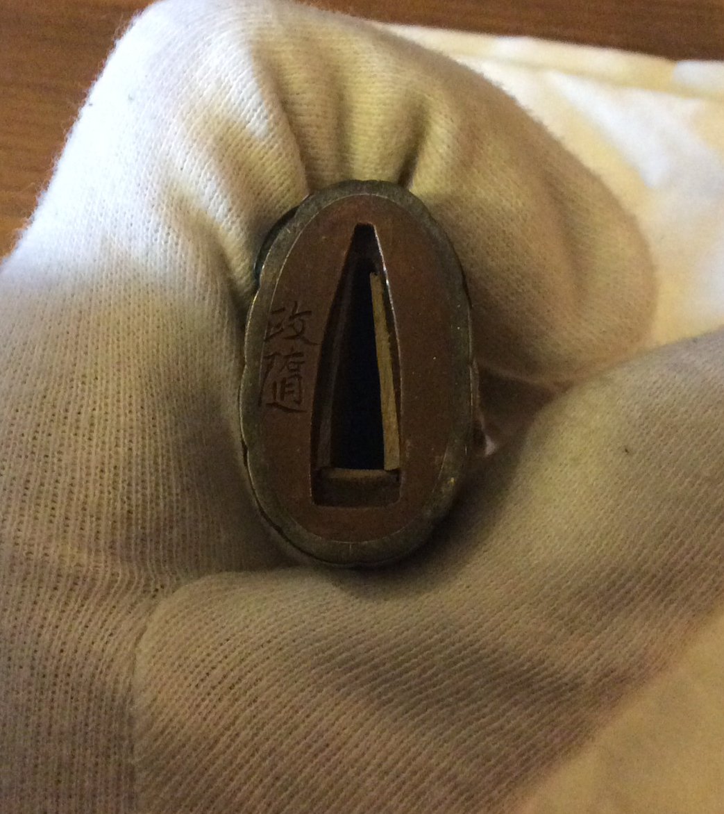

I have a signed kogatana and Fuchi plus a kojiri I believe is signed in gold? I’m having trouble identifying. I don’t have a large database of books to use for reference and I was hoping someone might help identify these makers? I’m sure these questions become a regular situation on this website but I’m not sure where else I can ask.

Well, there ya go!  As to the kojiri the gold mark is a kakihan, roughly a stylised mark rather than a signature per se.  I am sure others will add to this but you might find, https://www.amazon.co.uk/Shosankenshu-Jolys-Kakihan-Collected-Mounts/dp/B0015HYW06  a useful starting place.

As Steve suggests, the reading of 政随 for the founder of the Hamano school is Shōzui, but be aware that his mei is widely copied. I've attached the reference from Sesko's Signatures for you to compare
