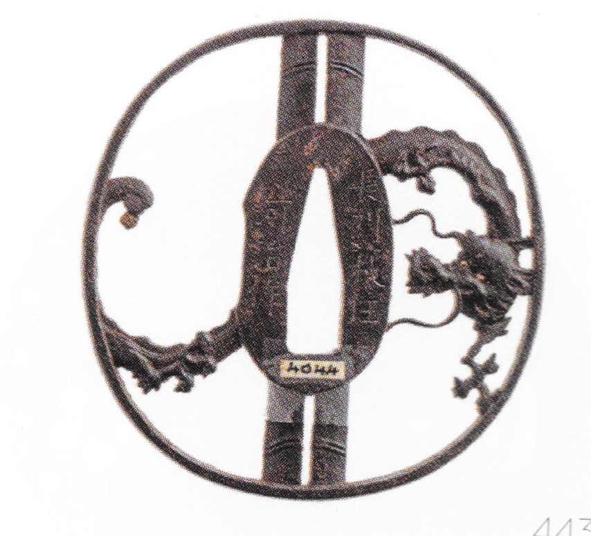

Kurikata Posted July 11, 2020 Report Posted July 11, 2020 Sébastien, I found this one similar to yours from Choshu school (Nagato) and from the Kawaji family. Signature is Choshu Hagi No Ju Kawaji Saku長州萩住河治作 (https://www.millon.com/lot/93327/9638460) I hope it can help 1 Quote
Gunome Posted July 11, 2020 Author Report Posted July 11, 2020 Hello Bruno. Indeed same splitted bamboo and dragon pattern. This Choshu tsuba is far better than mine ! Thanks, I will look on choshu then. Quote
