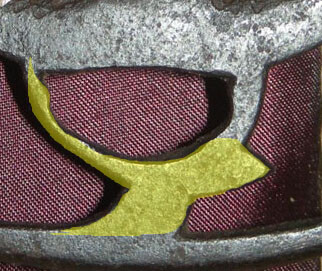

shan Posted October 11, 2008 Author Report Posted October 11, 2008 Thank you all for your opinions so far they are all very useful. Please permit me one more concession and have a look at the way in which both of these Hitsu ana are worked. One is neat and well worked and the other is half hazard and uneven. This is not an anomaly to me; this is different workmanship or more likely a later reworking of the hitsu ana to accommodate something that did not fit the original Ana. My guess is it was enlarged for a wari Kogai or something similar. Forgive me my inexperience. I may be “way off base†on this but its just not the same neat work. Regards shan Quote
Brian Posted October 11, 2008 Report Posted October 11, 2008 Shan, I agree there may have been some slight alteration or damage at some stage, but short of asking the original tsuba maker, all we can do is speculate at what he had as a concept. However, to my eyes, you have the one goose upside down, and what looks like roughness and unevenness is actually the neck and head of the goose. I realise this pic may just be my own bizarre rorschacht test, but I see something along these lines: (Of course I may just be seeing things, but I don't think the alterations are as great as you may think. Just personal opinion) Brian Quote
shan Posted October 11, 2008 Author Report Posted October 11, 2008 Hi Brian, You may be right and i agree we will never know. I guess that i may be getting hung up on a mute point. Its a nice item and I would never have seen the duck and or goose without you and your forums help. I now realize that you need to look deeper sometimes to see the subject matter. One of the Shoami branches is the general consensus then? It has a nice feel to it and someone took care to make it well. Its a "Keeper" in my books because of that. Is it an armourers tsuba or a tsuba makers tsuba? Any Idea of its age? or is that hard to judge? many thanks shan Quote
Pete Klein Posted October 11, 2008 Report Posted October 11, 2008 I would say the kogai hitsuana was opened up to allow for a heaftier kogai, probably one of the larger yamagane types. It would explain the shape of the hitsu as normally the kogai hitsu is smaller than the kozuka hitsu. As for Tosho / Katchushi you're mixing apples and oranges. It's neither, it's Shoami. As for age probably early to mid Edo. Quote
