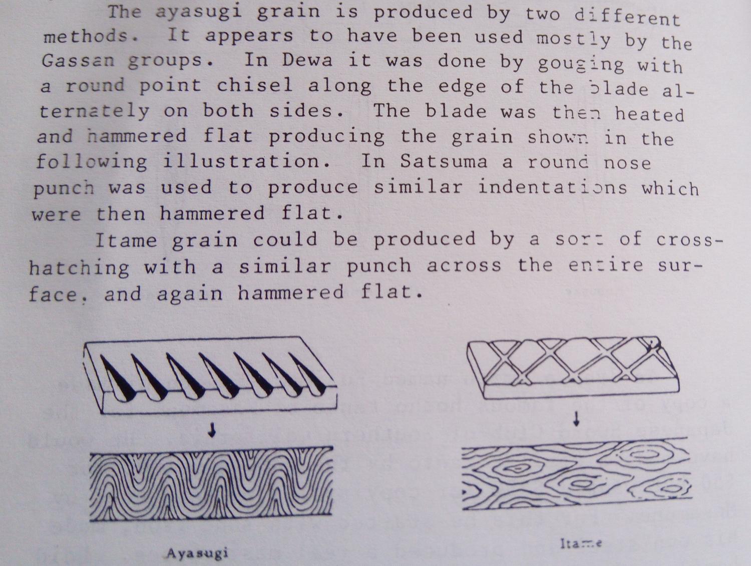

Jacques Posted November 1, 2019 Report Posted November 1, 2019 From Hawley's lamination techniques in Japanese swords Sunobe also can be twisted and hammered flat. 6 Quote

Ken-Hawaii Posted November 1, 2019 Report Posted November 1, 2019 Thanks for that chart, Jacques. I couldn't find it in my references. Quote
ROKUJURO Posted November 1, 2019 Report Posted November 1, 2019 James,Kapp/YOSHINDO are correct: 'It's ......produced by selectively filing away sections at the edge of a MASAME pattern steel block when the blank for the sword is being formed'. It cannot be produced by making indentations which you hammer flat again, that will not produce a pattern. This method works only if you file the billet after making the indentations.The whole process is more understandable if you imagine the steel billet as a piece of puff pastry. If you cut this at an angle, you will see the layers. It is no witchwork but mainly experience. 1 Quote
