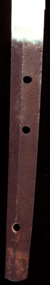

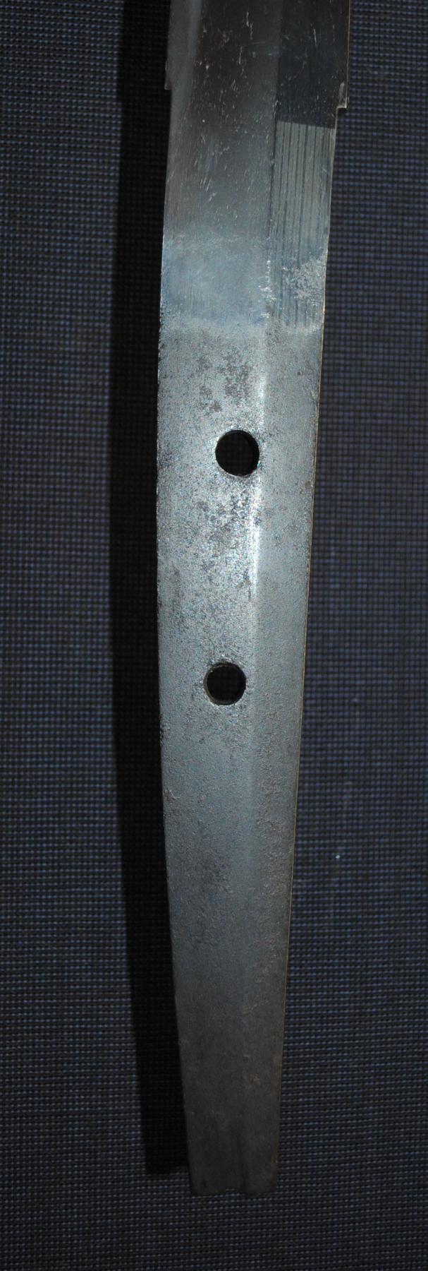

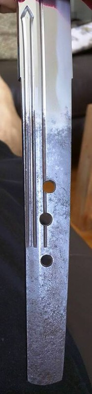

paulb Posted June 3, 2018 Report Posted June 3, 2018 As has been suggested by others much of this is down to interpretation and opinion and I suggest as with everything else there will always be exceptions. The key seems to be the level of care taken in carrying out the suriage. I would suggest part of that also has to be related to how the nakago is reshaped as much as the way the end is cut. To illustrate I have added three images below. The first from an enju walazashi where the nakago has justt been squarelty chopped off with no attempt to round it. The second is an Aoe blade from the kamakura period. Based on the "kiri" argument the nakago jiri would lean the observer towards keicho sorthening even though it is slightly rounded but the nakago has been carefully reshaped and finished. The last one illustrates a nakago that has been beautifully shortened and finished. The colour the shape etc all look great. The problem is that this is papered to the Tensho period (albeit old papers) If they are right this can only have been shortened later and would be an example of great care being taken during Keicho or later. 2 Quote
Guido Posted June 3, 2018 Report Posted June 3, 2018 Is the third one orikaeshimei? In that case I haven‘t seen anything else than (kind of half) kiri, no matter when it was done. Quote

paulb Posted June 3, 2018 Report Posted June 3, 2018 Hi Guido, No it isn't orikaeshimei. Sorry I wasn't very clear but the point I was getting at is that regardless of when this was shortened someone went to a lot of trouble in shaping and finishing the nakago. The impression I got from earlier posts was that Keicho suriage was less carefully executed and finished, but perhaps I misunderstood. Quote
Guido Posted June 4, 2018 Report Posted June 4, 2018 No it isn't orikaeshimei. And there I was, so proud to have much better vision after getting my new glasses ... ... but this is what I'm still seeing : Quote
paulb Posted June 4, 2018 Report Posted June 4, 2018 I think what is fooling your eye is the shinogi line running through the nakago Quote
