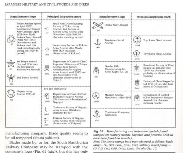

radiodoc Posted April 10, 2008 Author Report Posted April 10, 2008 I did a little research and it's a 1945 production with the wood handle and metal sheath. Where the production # is on the sheath it's rusted over so it's hard to determine if the sword and sheath were together but the first 3 numbers of the series match so I have to assume they were. Hard to determine whether the sheath was brown or tan because of the surface rust. Any way to determine which factory produces it by the number? As near as I can make it out it's 21264 or 21284. The leather strap is long gone but this is still kind of a neat relic of a bygone war. George Quote
Brian Posted April 11, 2008 Report Posted April 11, 2008 George, The serial numbers have no bearing on which arsenal manufactured it. There are tiny stamps usually next to the serial number and on the fuchi that indicate arsenal. Obviously totally machine made, and not Nihonto. But if it is indeed the wooden handle one with the cross hatching, those do fetch a premium, and can go up to $800 or more sometimes to militaria dealers. If you post a pic we can verify it for you, but info beyond that is unfortunately beyond the scope of our subject here. Brian Quote
radiodoc Posted April 11, 2008 Author Report Posted April 11, 2008 I'll see if I can find any characters which correspond to the list of companies and will post a couple of pictures when I get a chance. Thanks for the help and suggestions. George Quote
