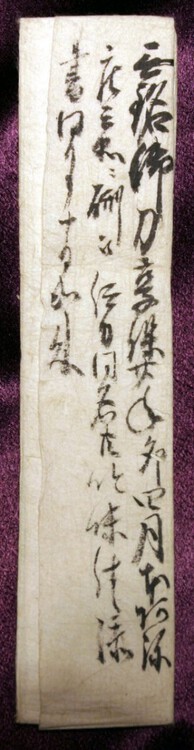

Darcy Posted March 24, 2008 Report Posted March 24, 2008 This is now completely beyond me. The first is the Tenran on the sayagaki. That I get. The second page of the note started in the previous page is all in grass script, and I can only pick out a couple of words. Um, make that one word, all I see in there is "katana". The third image is the note from Honami Shobei which is from around 1720 +/- 10 years or so. This I had read to me in terms of its overall meaning, I am not sure about the actual reading and would love to establish the kanji if possible. I think it comes last in the order of pages. It is supposed to be a polishing invoice, where the sword was first attributed to Yukimitsu and valued at 1,000 kan. It states that the sword is suriage, with a hi and is in perfect condition. Any assistance is really appreciated. I've been asking around on these things for three years and getting information piecemeal, and due to the difficulty and not wanting to press anyone, it's been hard to try to get the big picture out of them. This one is more clear to me, I can see it starting with "one o-suriage mumei katana" and I see Yukimitsu named in there, but the rest... I don't know how you guys do it :-). Quote

Darcy Posted March 25, 2008 Author Report Posted March 25, 2008 The second one I am more confident I got right, it seems fairly straight forward. I might have tripped over "wu" (year of the Hare?) and "dentou" I figured meant the same as "denrai" just more specific, so an heirloom sword? 1. 無銘御刀亨保二十年卯四月本阿弥庄兵衛二研 Mumei on-katana Kyoho niju nen wu shi gatsu Honami Shobei ni togasu. In April of 1736 (the year of the Hare), Honami Shobei polished the unsigned o-katana. 2. 御傳刀同名共吟味仕候添書同月十日以来 On dentou doumyo domo ginmi tsukamatsuri sourou soegaki dogetsu touka o motte kitaru. The honorable heirloom sword, was also given an official attribution by Honami Shobei: see the attached letter dated 10 days into the same month. Quote

Nobody Posted March 25, 2008 Report Posted March 25, 2008 I might have tripped over "wu" (year of the Hare?) and "dentou" I figured meant the same as "denrai" just more specific, so an heirloom sword? In this case, I think that 夘 (卯) means 卯の花 (U no Hana = deutzia). 卯月 (Uzuki) is another name of the 4th month. Only a thought. I withdraw my theory. I found an example of date inscription in which a zodiac sign was written after 年 (nen = year). So, 卯 (wu) may mean the Hare of zodiac signs as you said. Quote
Darcy Posted March 26, 2008 Author Report Posted March 26, 2008 I just tried entering in 1736 into a Chinese zodiac calculator... which is the year of the Dragon, but 1735 is indeed the year of the hare, and then I checked and saw that I calculated Kyoho 20 wrong (I stated it as 1736 when it is 1735). I had never seen this before actually four days ago, when I saw a sword with a zodiac sign after the era (year of the rooster) but before the numbers. In that case it matched the era too... funny how you can go 10 years without seeing anything like this then within 5 days you get two. Quote
Guest reinhard Posted March 26, 2008 Report Posted March 26, 2008 Hi Darcy, In Iimura's "Token Yoran" you find the zodiac Kanji attributed to every nengo. Kyoho 20th year was "kinoto-(w)u". Don't leave home without it . I prefer Moriyama-San's first (withdrawn) version (uzuki referring to the 4th lunar month) BTW. reinhard Quote
