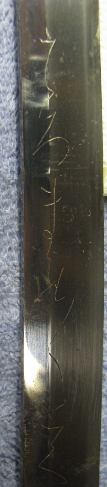

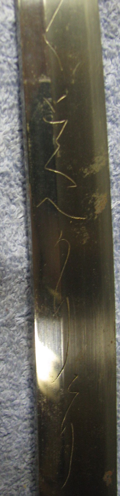

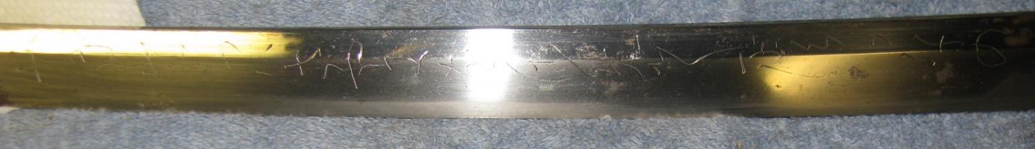

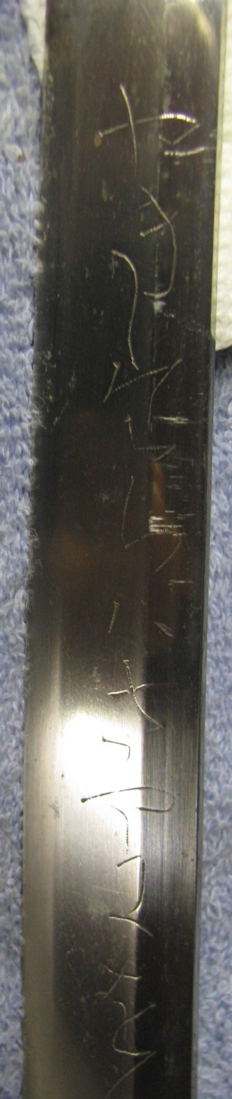

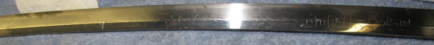

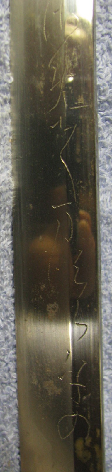

Mark Posted April 5, 2016 Report Posted April 5, 2016 I have a mumei (nothing on tang) wakizashi. I think the mei is on the blade along with an inscription, maybe a poem? I can see what i think is Sho or Masa, San or Mi, Ju AriSuke... i may be wrong with that, Looks like it was done with a dremel tool but it seems like it was written by someone familiar with kanji, not an American vet, and it came out of the woodwork so not done in the past 40 years. any help appreciated. Thanks! Quote
Mark Posted April 5, 2016 Author Report Posted April 5, 2016 i tried to place the pictures in order, full length then top to bottom but they were shuffled around somehow, sorry Quote
Maurice_lmb Posted April 5, 2016 Report Posted April 5, 2016 hi Mark it reminds me ARIKOTO blade. Maurice Quote
Mark Posted April 5, 2016 Author Report Posted April 5, 2016 Maurice thanks! I was not sure about my translation. Looking again I think you are right Quote

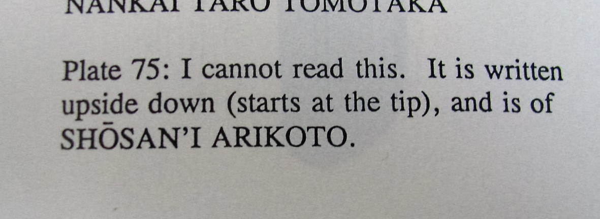

Mark Posted April 5, 2016 Author Report Posted April 5, 2016 with Maurice's direction i found Arikoto in Nihonto Koza, there is an example shown with, what looks like, an identical inscription. The book says that the inscription could not be read, but also said that he inscribed poems on his blades so i guess that is what it is. Thanks! good learning opportunity Picture of the book below Quote

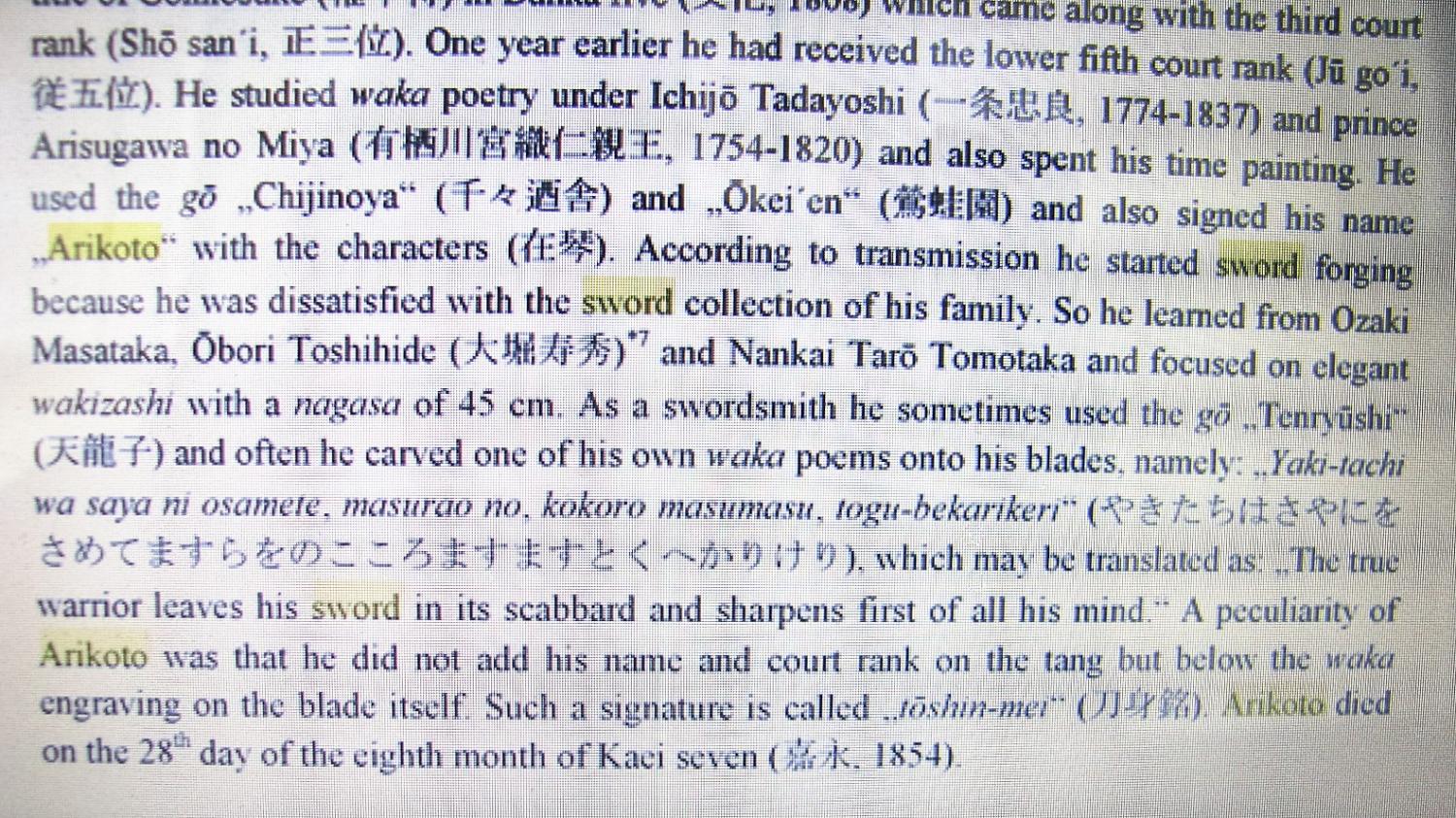

Mark Posted April 5, 2016 Author Report Posted April 5, 2016 with help of Markus Sesko's book Nihon-shinshinto-shi - The History of the shinshinto Era of Japanese Swords i found the meaning of the poem and some additional information. So i will have to compare the sword to some in books and try and determine if it is shoshin or a later copy Quote

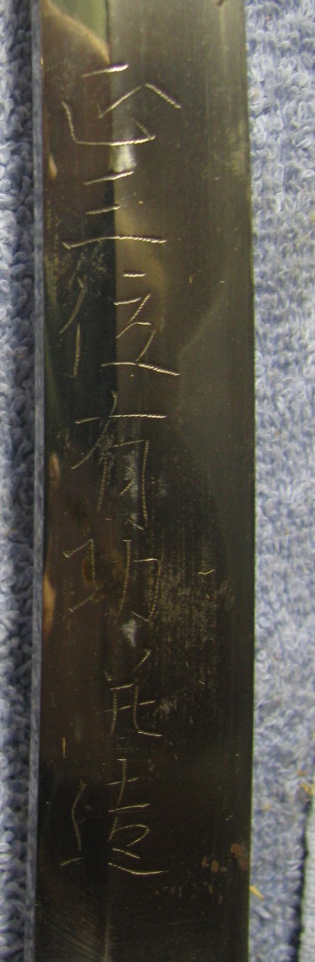

george trotter Posted April 7, 2016 Report Posted April 7, 2016 Lucky we have Markus. That is interesting info on a relatively unknown (to us) smith. I notice in the photo posted by Mark that his signnture is indeed visible at the bottom of the poem (upper oshigata). Quote
