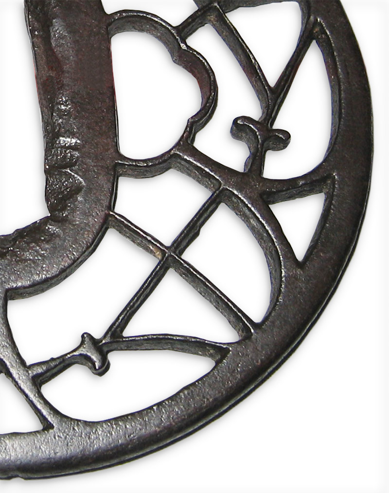

Was it also common for other schools to put a coat of lacquer on their Tsubas? Or was it rather an aesthetical point not connected to any school and added or refreshed by the owner from time to time?
I have a Kyo Sukashi guard that I think has a quite large area of lacquer remaining. The only place free from lacquer seems to be outside surface of the Mimi.
The guard in question was already discussed on the forum ( http://www.militaria.co.za/nihontomessa ... highlight= ).

Hi Martin, yes it is possible that Kyo could be lacquered. I am sure it was probably as much a trend as anything else.
Are you sure this tusba is lacquered ?, I am sorry to question that, and it may just be the photo's, but lacquer tends to be darker, and usually chips off leaving a black, patchyness to the tsuba.
(as per this Ko Kinko tsuba)
I was just wondering if the tsuba is not Mikagi Ji ?.
Cheers
Richard
Hi Rich,
maybe a stupid question - but was it always black lacquer that was applied?
If this is the case my Tsuba may not show lacquer but indeed has a "polished up" surface (Mikagi-Ji).
What made me think of lacquer was the glossy, shiny wet looking appearance - like it shows on objects that have a clear lacquer finish.
cheers,
is more likely to be the stupid thing Martin. All questions are good. So the most common lacquer colour was black, red was also used in olden days (as well as for Shumei). Clear too was also used. I should have added that tin my previous post, yes clear lacquer was used, just not that often from what I know. Black or dark was the most common.
I have a Heinajo Zogan tsuba that appears to have clear lacquer on it, it is heavier in some sections that other and mutes the theme slightly giving it a milky appearance where it has been rubbed or worn over the years. It is not apparent on the seppa dai, the mimi and has worn away from the edges for about 5 mill (give or take) into the hira. This is the only tsuba I have seen like this to date.
It is near on impossible to photograph this and is best seen in hand, and I suspect your tsuba is the same. You need someone to see it or another tsuba to compare it to. I have attached a scan.
If you notice on the right side of the photo, on the tsuba Ura, to the right if the hitsu ana, the design looks sharper, it has more contrast, but on the left of the nakago ana, around the area of the highest flower, it is milky looking. This can be seen all over the tsuba when looked at closely. This is clear lacquer. As I said, it is hard to capture.
Now, on the other hand, I do have a Ko Akasaka tsuba that is mikagi-ji that looks like it is lacquered. It is not a black look like the tsuba above but shows the irons colour properly giving it I guess the impression of a clear lacquer. It has fooled one or two people I know of.

Hi Martin
The finish on your tsuba may be ;
IBOTARO Chinese Wax, (tree wax) a wax made from natural sources. Lightly dusted on tsuba surface as a protective coating for iron plate.
ref : Haynes Auction Catalog, No. 1 Nov 1981 - Glossary
Here is a thread from the carvingpath on its use;
http://www.thecarvingpath.net/forum/ind ... wtopic=694
"Ibotaro, a wax which imparts a fine gloss, is made from the secretion of an insect that infests the ibota plant."
Steve
Hi all,
many thanks for your answers and thoughts.
Taking all the possibilities written into consideration I would assume, that my Tsuba has an epoxy clear coat.
:D just kidding :D
I think that it indeed has an Ibota Wax finish as mentioned by Steve. I already read about this kind of finish used on soft metal Tsuba and this makes the most sense for my piece in question too.
The reason why the outer surface of the Mimi is left out is probably due to the fact that there was a Fukurin that covered it.
best regards,

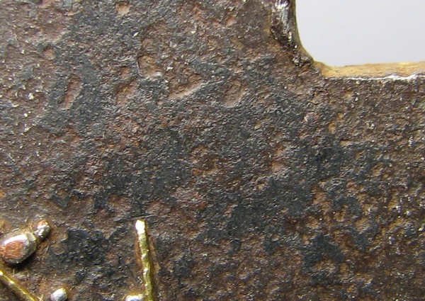

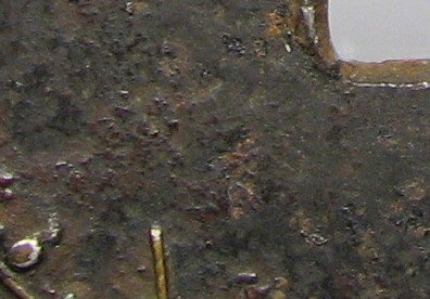

One more question about lacquer on iron tsuba, if you don't mind :) .
After examining the surface of a tsuba, I've found dark black areas on it. They are especially clear viewed after I've removed a kind of wax and the red rust (the first picture - before the cleaning, the second - after).
Before I've found this topic, I thought that it's just patina on undamaged metal. But maybe it's a black lacquer? What do you think?
Hi Andre,
I would suggest that based on the images the darker patches you seem to be referring to are actually parts of the original iron oxide based patina...not lacquer in my opinion.
While I'm here I'd also like to straighten out another apparent misconception;
It is practically ( by which I mean literally ) impossible to create clear urushi...it simply isn't in the nature of the material. I will also go further while I'm at it and suggest that the whole matter of tsuba being lacquered as a matter of course when first manufactured is very ( extremely ) speculative. I will admit there may be some exceptions of pieces being lacquered after the fact but I doubt the practice was widespread. If I were pressed I'd prefer to suggest that surviving examples of lacquered steel tsuba were treated this way in the Edo period as a way of, perhaps, preserving "antiquities". In any case the process is not as simple as simply painting the stuff on...it's quite an art. The associated idea that early Higo work was routinely coated in urushi I find to be completely silly, polished, soft metal appearance isn't any sort of evidence in my book. I await some sensible and convincing evidence before I am prepared to swallow that sort of fairy tale. The most obvious question one would ask would be; " If you intend to coat everything in black lacquer why bother with all those different alloys that incidentally yield
those lovely colours?....not accidentally at all :roll: or bother developing subtle textures and tones on iron only to coat it in black goo :crazy:
your honest servant,
ford ;)
I think what your images show is iron patina. From those I've seen and owned with traces of lacquer, it tends to remain in recesses rather than high points.
