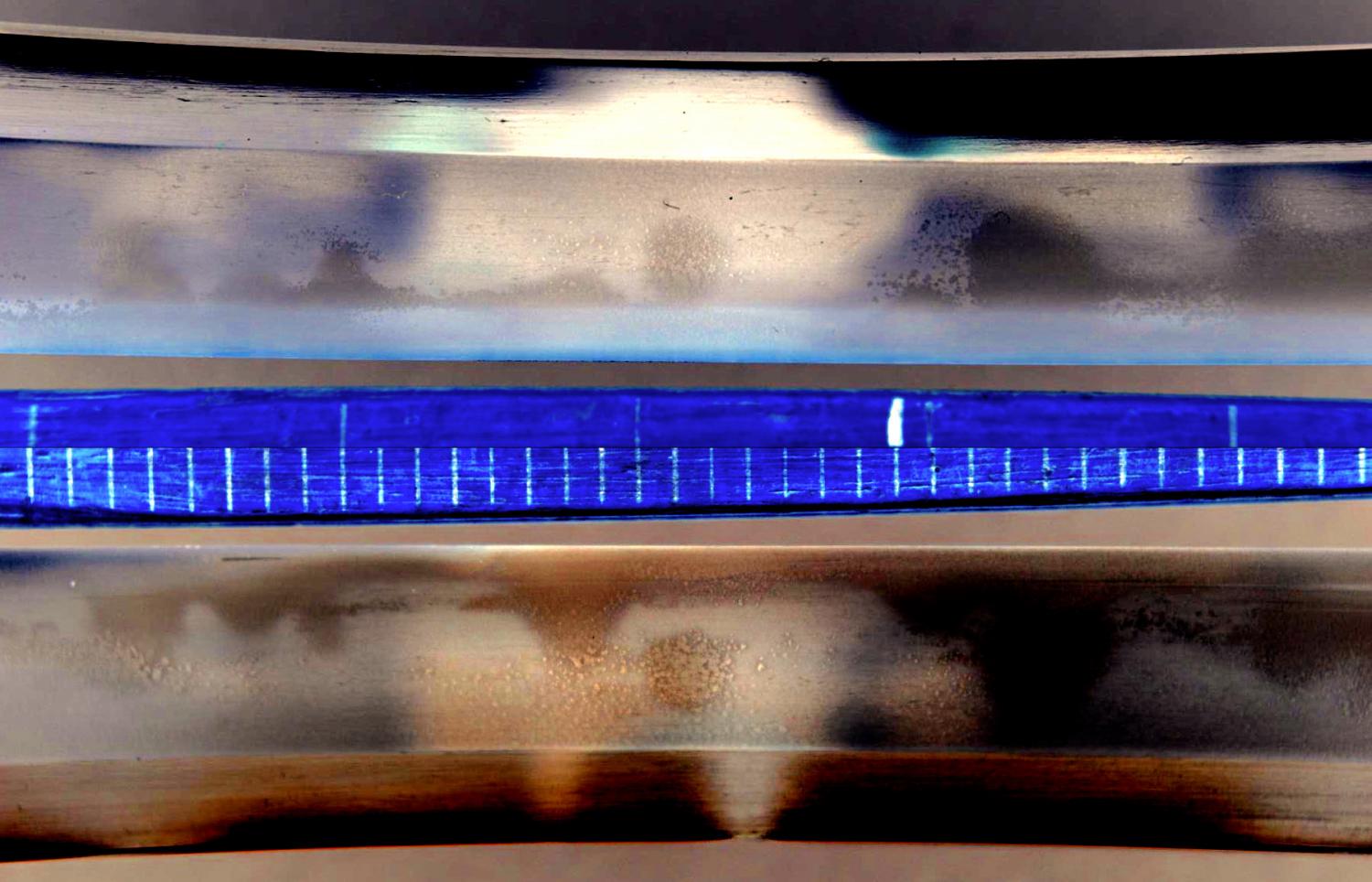

Having read articles in the past on the subject, of hamon showing a mirror image both sides of the blade.
My attention has been drawn to a wakizashi, which in hand looks as if an attempt has been made, to create such an effect.
Now, just how accurate this effect has to be, to be considered a mirroring, I don't know.
So as an exercise, I decided to photograph both sides of the blade at several points, using a rule at the hamachi for reference.
I have the images, but here's where I ask for members assistance please.
I do not have image enhancing software.
What is now needed is tweaking to enhance the hamon, and placing two images ha to ha in one shot, for comparison.
To the skilled amongst us I hope this is no big deal.
I will add two images out of the six comparisons I have.
Thanks in advance for any help. this will be for board appraisal when completed.
Regards.

Axel, yes you got as far as I did! The two examples were just to show the standard of photo to be worked on.
Darcy, the other examples (5) all have a similarity in hamon, using the yardstick the examples are surprisingly on 'measure'.

This blade has at least 6 areas where it can be supposed a mirror attempt has been made, The position of the measure indicates, this is not a random accident.
Now the other point.
The fashioning of the hamon is pre yaki-ire, so from there, the desired effect is now expected.
So if a smith had the intention, of producing the characteristics of a known smith, then the attempt of mirroring, would be deliberate and not accidental.
Where am I going with this? It leads from your comment that “it could be someone trying to copy ‘Sukehiro’
This blade is signed ‘Sukehiro’, gi-mei when compared to examples I have seen.
One will never know! But was this made to deceive, or the mei added later because of the hamon?
Either way your return post was most informative thanks.
