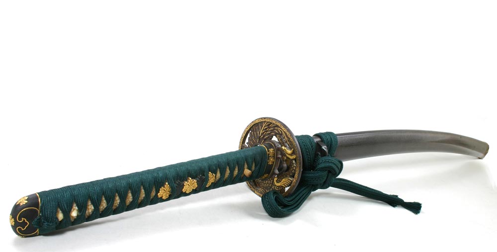

SteveM Posted September 12, 2015 Report Posted September 12, 2015 A kind of fue-maki (笛巻), I think. Very nice. Here's another example. http://www.finesword.co.jp/sale/touken/htm/0704/169/wakizasi_kosirae.htm Quote

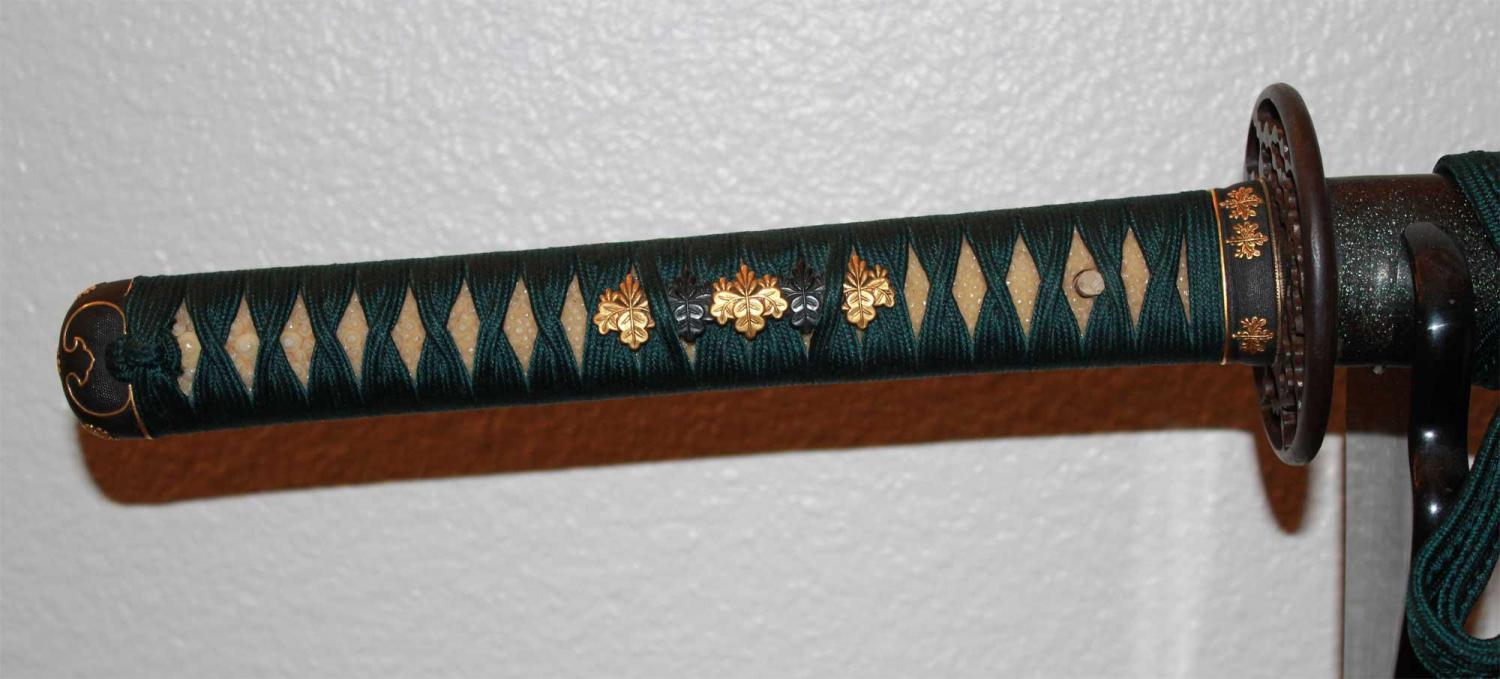

Ron STL Posted September 12, 2015 Author Report Posted September 12, 2015 Thanks for your thoughts on this koshirae. I've never really studied the different styles of koshirae other than simply looking at photos in the books. Meanwhile, I've attached four more photos that show a little more detail of the fittings and tsuka. Photography is certainly not the best; I've been having problems with my camera settings and need to resolve those. The fuchi is signed: Tokinori, most likely Haynes H09745.0 from what I can determine. The kashira is as you see. Visually, all of the tsuka fitting look good together but I'm not so sure fuchi and kashira are a true set. The tsuba is fitted with two large (lacquered black) seppa which were one affixed to either side of the tsuba so only the tsuba's carved rim showed. Beautifully made habaki of Goto (or is it Gassan) style. As for that rather crude horn mekugi, that was my first attempt at making a horn mekugi back when I first bought the sword. Yes, it looks terrible! Also, the saya was not shortened. It one had a horn Jiri glued in place; the glue remains in patches on the saya. Another thing I have wanted to do is have that replaced, but here it is 40 years later... Perhaps this discussion will get me to finally have these two minor repairs taken care of. Sadly, the owner had this and another sword stored in a window box and is suspected that piece may still be laying in that box today! By the way, the owner's husband bought this sword in Japan after the war from a sword shop. Not shown are a Kaga "checker pattern" waribashi and a quality kozuka. A couple months ago I made the kozuka a topic under Tosogu. Maker was a Showa-era maker. Ron STL 3 Quote

Guido Posted September 13, 2015 Report Posted September 13, 2015 I missed in the first set of pictures that's it a yuigata 結形 kashira, so it's not kōbusho, which would have kind of downscaled handachi kashira and sayajiri. I also didn't see that the sayajiri is completely missing, leaving us without one important clue (was it really horn? And if so, was it original to the koshirae?). I therefore stick with my non-committal description. 1 Quote
Guido Posted September 13, 2015 Report Posted September 13, 2015 Btw, the habaki is a (koshi) yūjō habaki (腰) 祐乗鎺 – no relation to Gotō Yūjō, 後藤祐乗, just the same kanji. Quote
