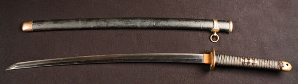

Here is a sword made in 1944 and mounted in Type 3 koshirae (custom made with lacquered gangi-maki binding).
You can see the proportion of blade (62.1 cm) to nakago (19.5 cm) which makes the proportion of the blade to nakago as approx. 3 : 1. Nakago is with kinae/shinobi ana at extreme end of jiri. Main mekugi is a metal screw and second mekugi is bamboo. Each mekugi enters from opposite sides,
Tsuka is 25.5 cm, so I would be interested in comment from our trained swordsmen about these blade/nakago/tsuka proportions in terms of being a good combat sword for infantry. Also their opinion of the effectiveness (compared with the Type 98 mounts) of having this length nakago, the kinae/shinobi ana and the lacquered gangi-maki as shown here.

One thing is for sure. If you change your tsuka with someone else's and the fit is not so good, adding a second mekugi would add stability and stiffness until you got proper repair. I imagine no samurai wanted to leave battle over a split tsuka or give up their trusted sword for another battlefield pickup. Maybe that would make as much sense as anything else? Just guessing. ...
