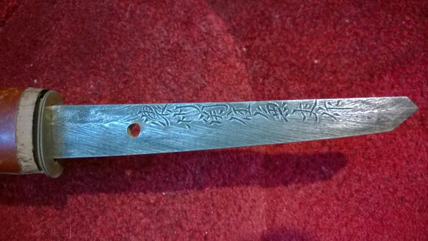

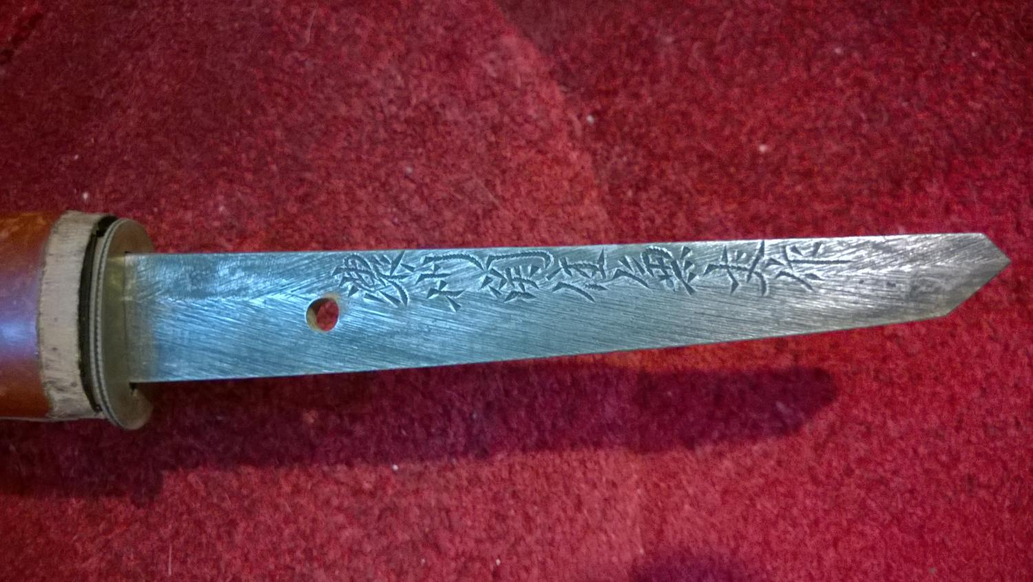

the_misha Posted June 29, 2015 Report Posted June 29, 2015 Hello! I'm new to the forum, and I'm hoping someone here can help me to translate the mei on a sword I just inherited from my grandfather, who ostensibly brought it back from the Battle of the Philippines. I know almost nothing about this sword, other than it being a bring-back. The blade is in pretty rough shape, and the saya and tsuka are both absolutely wrecked, but being as it's a family heirloom of sorts, I'd like to get it restored to something resembling its original state. First, though, I'd need to know what that "original state" was. Thanks! - Colin Quote
Jean Posted June 29, 2015 Report Posted June 29, 2015 That's a WWII blade, signed Noshu Seki Ju Kane Tomo saku. http://www.japaneseswordindex.com/seki.htm Quote
the_misha Posted June 30, 2015 Author Report Posted June 30, 2015 Thanks, SwordGuyJoe and Jean!So, am I correct in guessing that what I've got here is your basic factory-produced "low grade Showato" as identified on the Seki Smiths page? - Colin Quote
SwordGuyJoe Posted June 30, 2015 Report Posted June 30, 2015 Yup. The Sho stamp indicates that it is non-traditionally made (showato) Quote
