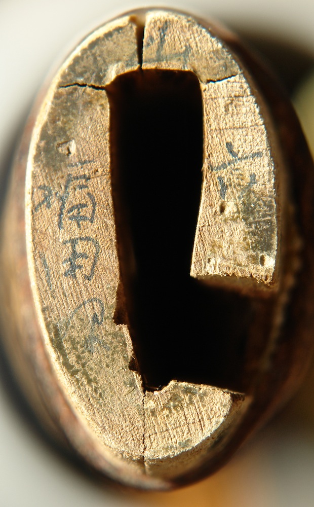

Dr Fox Posted October 11, 2014 Report Posted October 11, 2014 Hi guys. Can anyone assist with the reading on this tsuka, its suspected at being made to fit a non military blade. Thanks in anticipation. Quote
george trotter Posted October 12, 2014 Report Posted October 12, 2014 The kanji on top is "yama" and on the right is "roku" (six). Those on the left column are harder to read...maybe "x ta x ". Sorry, maybe Morita sensei or Moriyama sensei or Kunitaro sensei can read it for you? I think it is the fittings shop/order contract details....? Hope this helps a little bit, Quote
Dr Fox Posted October 12, 2014 Author Report Posted October 12, 2014 Thanks for the heads up George. I will wait to see what comes up. Regards Quote

cabowen Posted November 15, 2014 Report Posted November 15, 2014 My guess: the top says "yama" 山, on the right, "six" 六, on the left, "inada X" 稲田 ? Almost always, the writing on tsuka, saya, etc., are names and assembly marks/numbers. Nothing of any real importance. Perhaps this is why no one has bothered to reply. Quote
Dr Fox Posted November 15, 2014 Author Report Posted November 15, 2014 Again thank you Brian. But in my own defence, I posted in Military swords because the wording in the translation guide lines states, 'for nihonto and related items'. So I didn't regard this gunto tsuka as a fit for those terms, in the literary sense. Chris I take your points on board, and its the likely answer to the non response cheers. As to your help, it takes me further on from where George T helped me to. So for a bit of background! The enquiry originated from me trying to confirm, that I have a complete gunto koshirae made for a particular blade, and that it has been kept complete since it was set up. The last key to the puzzle was the tsuka inscription. It does marry to all the other parts by the reading of "yama" and "6". Not being a gunto man, I thought this was worth the effort, to find out if this was common, to have a complete unit after so long? Regards both. Quote
cabowen Posted November 15, 2014 Report Posted November 15, 2014 Yes, it is very common as most gunto were put together during the war, clearly, and have stayed in that state since. Sure, some have been disassembled and the parts scattered, reassembled, etc., but in the grand scheme, these put togethers are smaller in number and usually easily spotted as they don't fit together in nearly all cases as well as they should. Quote
Dr Fox Posted November 16, 2014 Author Report Posted November 16, 2014 See it Chris I have seen a lot of put togethers, and very few have had more than two matching numbers. So to see a collection complete made a refreshing change. Putting my cards on the table, I am a nihonto fan. But freely admit, I find a lot of interesting facts and features in Gunto work. Quote
