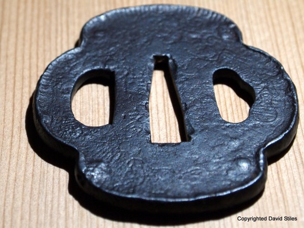

Soshin Posted August 27, 2014 Author Report Posted August 27, 2014 Hi Brian, I agree Tim did a wonderful job of coming up with so many examples of the so called wide mei Nobuie. One observation I have made is that the NBTHK with both the old or the new papers don't attribute a early Nobuie tsuba to a specific generation such as the 1st or 2nd generation. Of the one NTHK(NPO) paper I have seen for a early Nobuie this was also the case. Does anyone have an example of a Nobuie tsuba attributed via shinsa by a major group (NBTHK, NTHK, or NTHK(NPO)) to a specific generation? P.S. Here is a new photo that display the mei nicely on my tsuba. Enjoy... Quote

Soshin Posted August 29, 2014 Author Report Posted August 29, 2014 Hi Everyone, I received a call from Bob Haynes yesterday morning while at work. I was happy to say I wasn't busy and could talk for a half hour. He thanked me for sending the nice photos of my tsuba to him. I sent him photos for six tsuba that I was suggested by Arnold F. to get his feedback about. Here is just what he had to say about the Nobuie tsuba taken from the notes I was able to write while talking to him. It is not perfect account as I am not a professional note taker but I tried my best to actively listen. The Nobuie tsuba is a small one but looks very good and is the work of an early generation. The signature is a bit worn and the second character is not very clear but the iron, patina, workmanship, and composition are excellent all characteristic of Nobuie. He thinks based upon the attribution the NBTHK shinsa panel was thinking the tsuba was the work of either the 1st or 2nd generation Nobuie but he believes that there more than just two generations of early Nobuie.The time period when my NBTHK Tokubetsu Kicho paper was issued (1967) was a good safe period. (He was able to tell me all of the names of the people on the NBTHK shinsa panel during 1967.) He wants me to bring the Nobuie tsuba to the Tampa show next year as he will have a table at the show with Elliott Long and wants to see my Nobuie tsuba and the NBTHK paper. :D Quote

Soshin Posted October 9, 2014 Author Report Posted October 9, 2014 Hi Everyone, I came across this Nobuie tsuba on a Yahoo Japan auction: https://www.jauce.com/auction/r119589800. It looks basically like a wide mei version of my Nobuie tsuba. It also does not have a shinsa paper likely due to the views on the wide mei by the NTHK and NBTHK. A few friends of mine have communicated privately that my tsuba looks like the work of the nidai Nobuie but I am continuing my research. P.S. Just a quick reminder my Nobuie tsuba will be on display at the upcoming Philly show next week (Oct. 17-19, 2014) at my table for more information please check out the following website: http://www.southeastshowsauctions.com/show-hours--admissions.html. Quote
