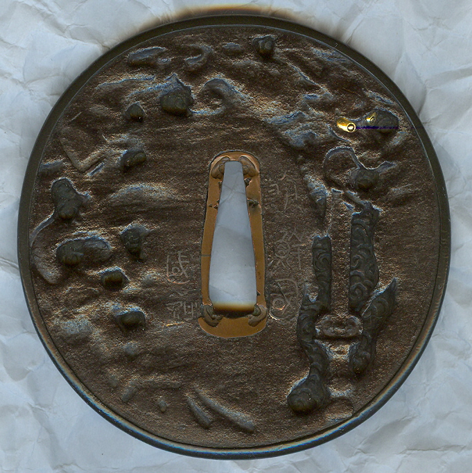

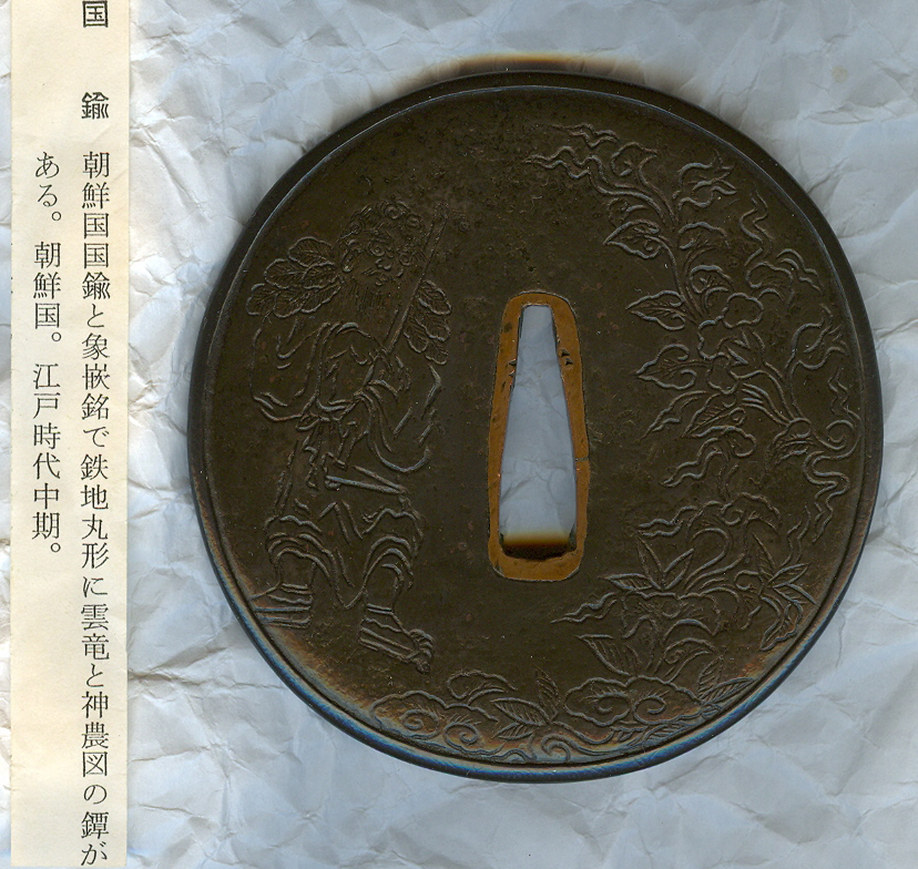

Brian Posted July 21, 2007 Report Posted July 21, 2007 Thanks Pete, Quite an unusual tsuba that, and am I right that sekigane does this way is very unusual? Unusual mei too..what does it say, and can you tell us anything about it? Brian Quote
Pete Klein Posted July 21, 2007 Report Posted July 21, 2007 Hi Brian -- yes, I would say I have only seen this used on tsuba of higher rank. Why this is I am not certain but probably has to do with not wanting to have something on a functioning mount which could come loose in service. I think those I have seen were used for more ceremonial use. It's one thing to have a small copper sekigane at each end and another to have the entire circumference covered. In this case the speculation is that it was designed to be fitted to a ken and then refitted to a katana. (~8 cm diam.) I feel this is a neat one, having NBTHK TBH orgami. The mei is 'Chosen Koku Kunito' done in silver inlay. According to Haynes he died between 1700 and 1750, Chosen Kuni being the country of Korea. "The name of this artist could also be read Kokuchu, Kunichu, or others ways, as we do not know the sound of the original Korean name. The name translates as 'brass country'" (Haynes 03675.0). The construction is interesting as it is actually two iron plates, the omote being sukashi and the ura being lacquered over on the outside with the inside carved with a rock like pattern, held together with a shakudo fukurin. Unfortunately it does not scan well being quite stunning in hand. This will go for juyo shinsa at some point. (Proud father complex showing). Quote
