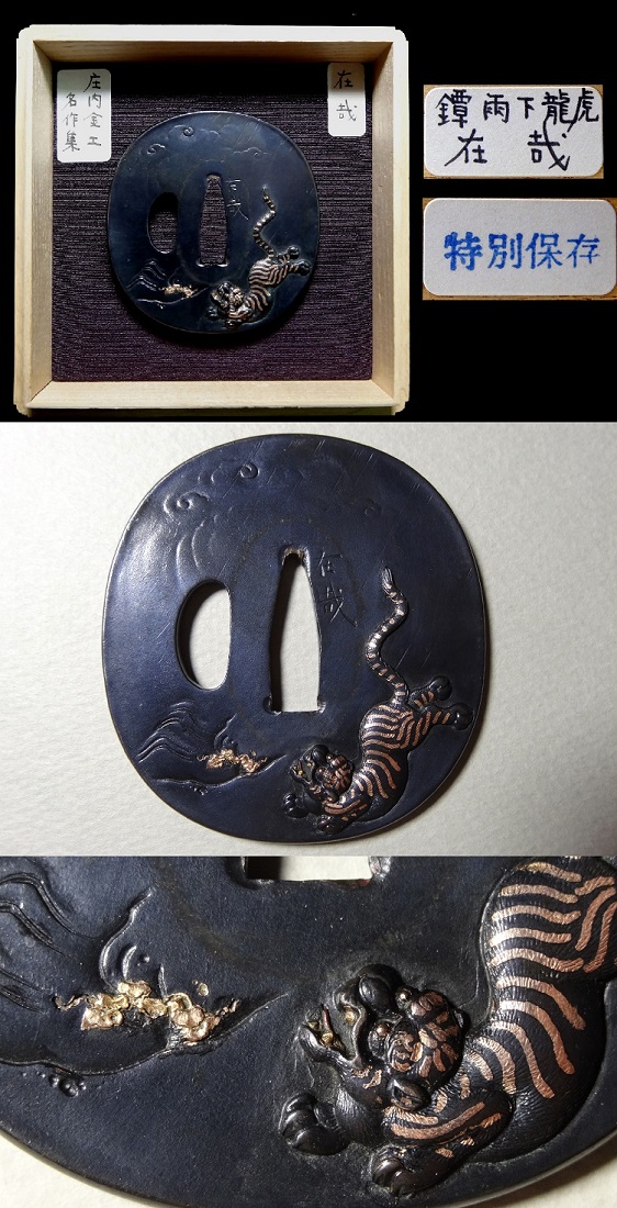

在哉
I am looking at a funny (comic) tsuba, and wondering how to read the artist's name: 在哉
Is it:
Sa-suke
Sa-chika
Sa-toshi
Suke-chika
Suke-toshi
Yoshi-suke
Yoshi-chika
Yoshi-toshi
Theme is a Rain Dragon pouring rain down on a Tiger, who does not look happy as it runs away. The rain dragon looks to me like it is smiling a bit.
Tsuba condition is a bit damaged, but the box has a sticker that claims it had Tokubetsu Hozon papers at one point.... now missing.
I have seen this theme before on a nice tsuba at Bonhams auction two years ago. On that one, there was a bamboo thicket on the other side towards which the tiger appears to be running to escape the rain. Maybe it is a well known story?
John,
:bowdown:
thank you. That was fast.
The sad thing is I have made this exact same mistake before.
I have looked up these guys, and found a Note to Self not to make this mistake again.... and make correct change to my kanji reference.
Taking a few minutes to go through the Bonhams NYC Oct 2012 Auction catalog, I see three other tsuba of various renderings of the rain dragon vs tiger, often with a mountain somewhere in the design as a third element.
