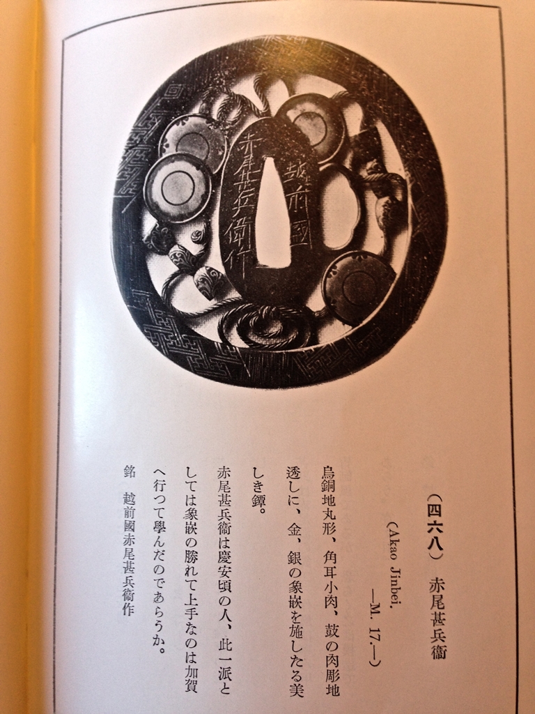

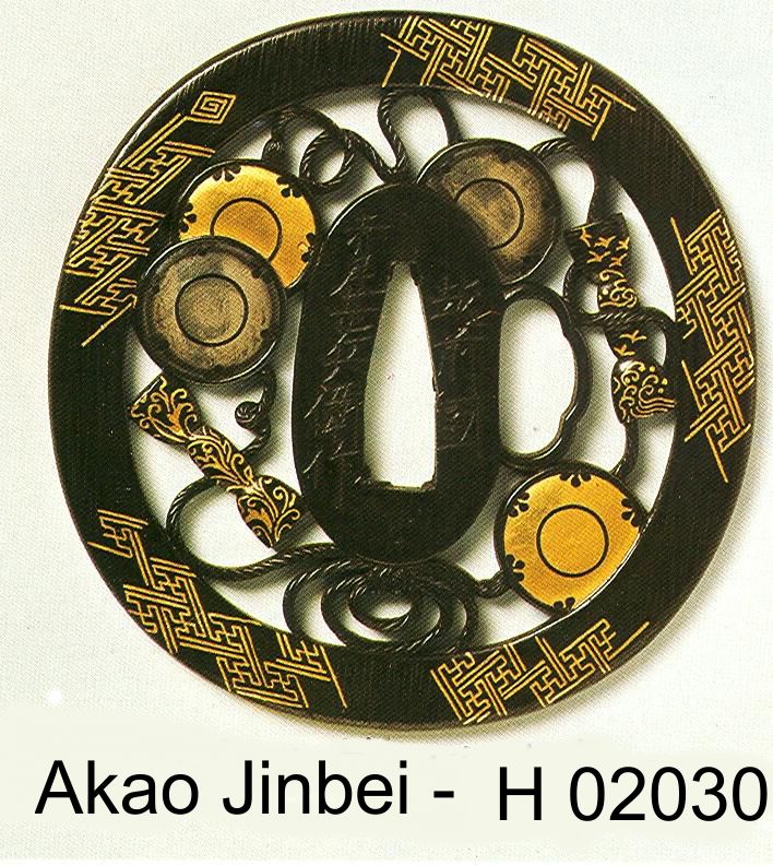

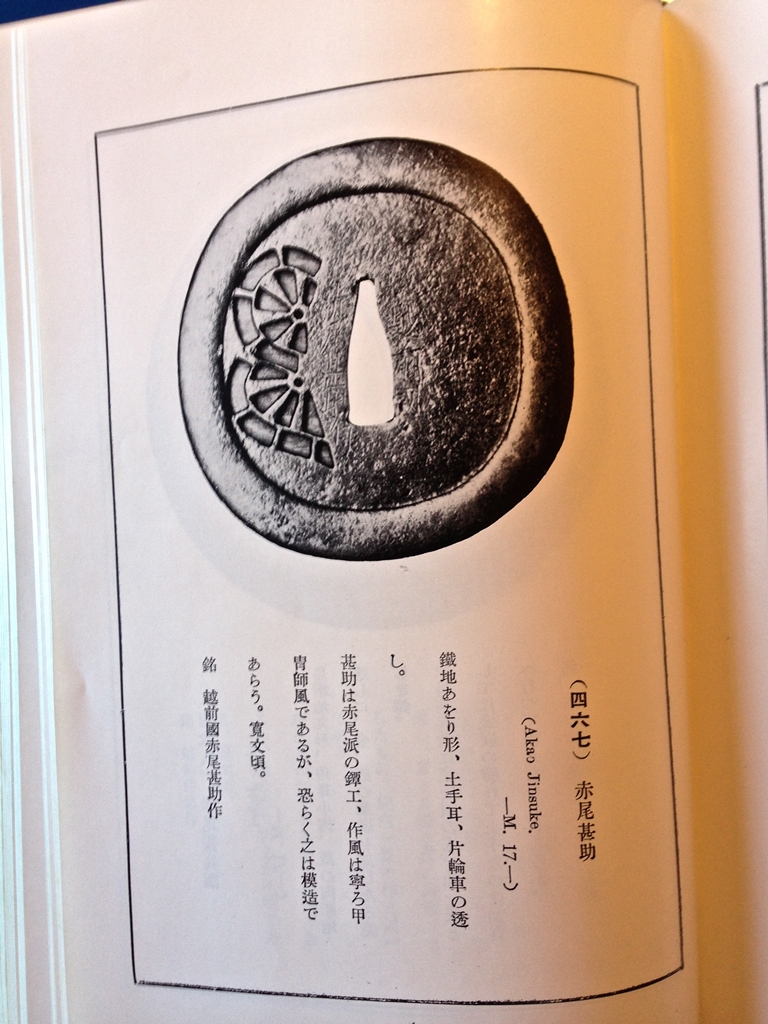

speaking about the mentioned Jinbei now....
He got equally listed in the Taikan....see attached picture....
IF Jinbei was then father/teacher of Yoshisuke I-(which i hard doupt) why does show the Taikan titulated Yoshisuke an kind of Kawa-gane structure(first picture)
and the Jinbei an Echizen or even more Awa stylism....(second picture)....?
In fact,one would date Tsuba#1 earlier than Tsuba#2....Not?
(hypotetic of course)
fact but is the visible Kawa-gane in Tsuba No.1(the Taikan´s Yoshisuke)....
THIS can not ben found in neither the Echizen nor the Awa school.(Kantei point)
Very strange!
Christian

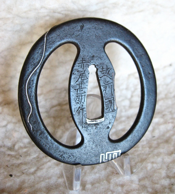

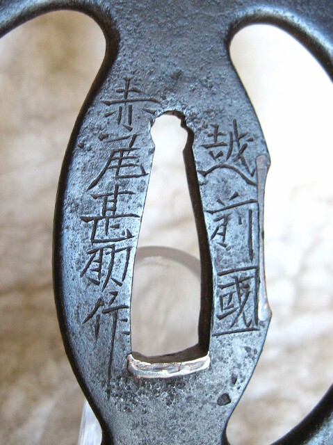

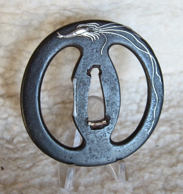

post-740-14196881196629_thumb.jpgHi Chistian,
I do not know if this helps, but this tsuba is from the Shibuiswords site.
Ex.Skip Holbrook collection.
Iron plate tsuba with large sukashi design of namako (sea cucumber).
Silver inlay of ebi (lobster), a symbol of celebration and emblematic of honorable old age.
The brass inlay in the six-o-clock position on reverse is representing a chapter in 'The Tales of Genji'.
All inlay intact.
Signed on reverse 'Echizen (no) Kuni Akao Jinsuke Saku'. H 02055.0
Early Edo ca. 1650
David.N
Dear David,
thank you,i but already have seen this one....
Generally speaking you actually can see three Tsuba on this webside who all three are given attr. to this group.
i can not see any reliance to an lineage-all three do show an completely different execution,stylism,taste,vogue...
secondly i doupt it´s given age...
No Akao Tsuba if we do take the Taikan examples as granted examples of that family.
(this Namako Lobster Akao may be an result of an custom order by somebody had ben attracted/passionate to Higo these days...it but seems me not to be of an representative piece,however we seemingly had to thrust in it´s authenticity due the signature(?))(if correct).
In fact-we do not really know much about this group(despite what has ben written and continuously repeated.
That´s honestly speaking not really much info.
(plus then,the obviously showing controverse in information written down)
I still puzzle where this Shodai(whomever it finally may be)comes from....(bringing me back to mine first post...)
Either way-thank you of course.... :)
