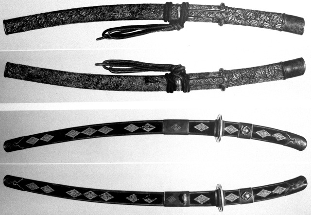

Marius Posted June 25, 2013 Author Report Posted June 25, 2013 And here is a kebiishi from the Ban Dainagon scroll. And two early uchigatana published in the "Uchigatana Koshirae" book by the Tokyo National Museum. Quote

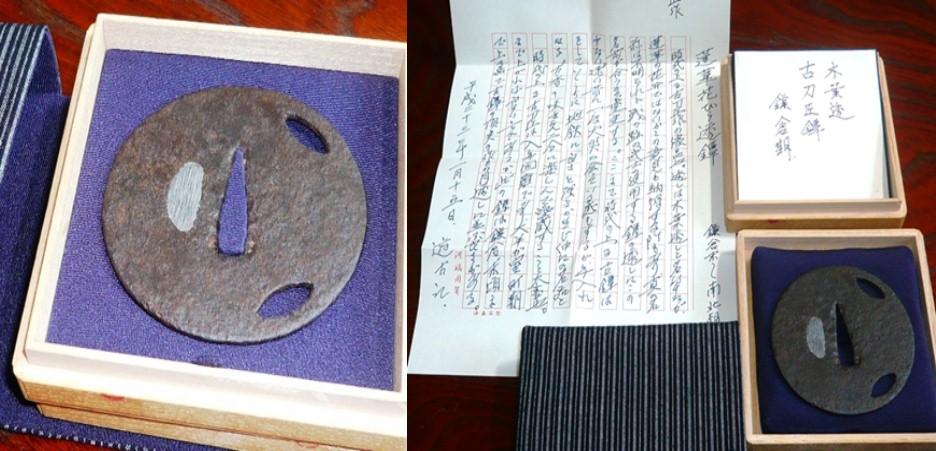

Henry Wilson Posted June 27, 2013 Report Posted June 27, 2013 Assuming the scrolls are accurate, the next question is where are all the tosogu from that era? According to the scrolls, there seems to have been an abundance of metal fittings. Over time many would have been lost, damaged beyond repair and recycled, neglected and left to rust and so on, however there should be some still around. Here are two iron tsuba from my collection which I think could be as a long shot the kind depicted in the scrolls. (Sorry about the blurry pictures). The first is a Ko Tosho tsuba that is perfect round, 7.2cm and 0.2 cm thick and was discussed last year here: viewtopic.php?f=2&t=13468 In my opinion there is a chance it could be the kind of iron tsuba worn by low ranking individuals on early uchigatana, such as the kebiishi in the Ban Dainagon Scrolls. By the way this tsuba will be in the up-and-coming KTK catalogue alongside the mikatsuki sukashi tsuba once owned by Sasano. The next is hard to categorise and is discussed embedded in this thread: viewtopic.php?f=2&t=13495&st=0&sk=t&sd=a&start=15 It was apparently found on a tachi, however it has been fitted in a box as an uchigatana tsuba. It is 8.5 cm, perfect round and in my opinion an early example of a tachi tsuba. From the scrolls I have found tsuba mounted on tachi which are very similar. The left hand picture below is of warriors (the ones with shaved heads are probably warrior monks) and they seem to have tsuba on their tachi of a similar style. The right hand picture is of a warrior resting during the attempted Mongol invasion. The tsuba on his tachi is of a similar shape, however there seems to be file marks radiating from the centre and the inner ring is probably a seppa commonly found on tachi. I have a feeling that this tsuba was probably soft metal but stylistically it appears to be of a similar style. As I say these comparisons are a long shot, however don’t let that put you off going through the scrolls and finding paintings of tsuba that are similar to your own tsuba! If you do, please share them with the rest of us. Quote

Marius Posted June 27, 2013 Author Report Posted June 27, 2013 Henry, your tsuba always makes me Fact is - we have no idea on what kind of sword those ubu tsuba with no hitsu-ana have been mounted. We can only speculate - tachi? nodachi? nagamaki? uchigatana? I guess the only way to learn is to get information on swords which rest in various shrines and temples. There are actual fighting weapons, not only those made specifically as offerings. Sakanoue no Tamuramaro's tachi with a very imporatant iron tsuba is an example here. Jim Gilbert has shown an interesting example of a tachi mounting with a nerikawa tsuba, in th Oyamazumi Jinja: http://home.earthlink.net/~jggilbert/nerikawa.htm Quote
Henry Wilson Posted June 27, 2013 Report Posted June 27, 2013 Hi Mariusz Thanks for the I am flattered. You are indeed right that we can't really tell what kind of koshirae they were mounted on but it is fun to have a wild guess at it. I have never been to Oyamazumi Shrine but I have been told that there are some tsuba like the ubu iron one above with the concentric circles on display on some old tachi koshirae. I have not seen then myself but hope to visit some day to find out for sure. Many thanks for the great thread. Posted from my iPhone. Quote
